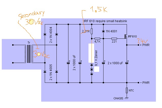

Re: Alelph 1.7 PS board for B1
if you post schematic - that would save me grande search ......
JC Fardo said:Hi
Please, can anyone hellp me to implement a power supply from an original (Veteran) Aleph 1.7 PS board to get 18-24V?.
What trafo secodaries voltages?
How to use green leds replacing zenners?

JC Fardo said:
whatever
AndrewT said:if the 610 operates with Vgs~3V then the LED string needs to be output voltage + Vgs or ~ 24V.
About 12 green LEDs will start getting close.
Maybe worth comparing a tl431 and a couple of resistors to see which performs better.
