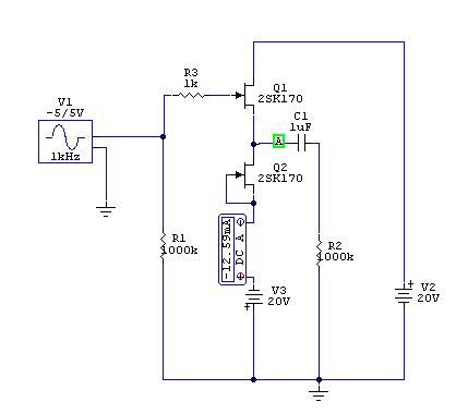

No problem indeed.

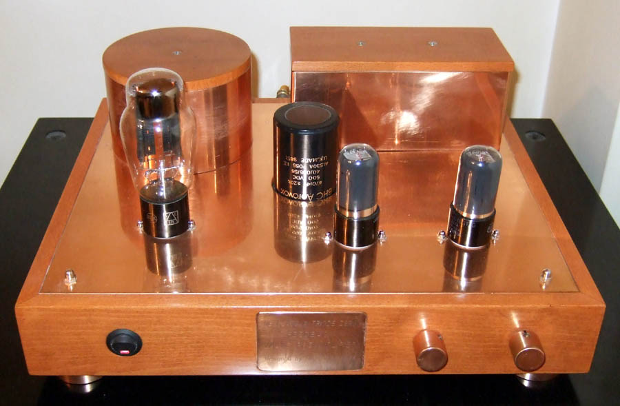

Guys, I have looked in an old parts box and I have 10x 2N5459 and 6x 2SK170BL. The 5459s bunch around 5-6mA Idss. And I measured 2 matches. 2x5mA & 2X5.2mA. The 170s are 6.9, 8.7, 7.7, 6.8, 8.2, 7.35 mA.
What do you think? Use the 5459 pairs for an attempt on a hopefully capacitorless B1, or prefer the 6.9+6.8, 7.7+7.35 mA 2SK170s? The 5459s have a dB or so more noise on paper, but for a line buffer isn't a big deal. ----The main question is, do 2SK170s sound detectably better than mundane N-JFETs, when noise is not an issue?---- Does anybody know? Nelson?
I can make it on perfboard, complete with 317-337 symmetric supply and lose at least the input cap. I will also use an output delay relay circuit if the equilibrium offset is very low so to lose Cout too, and avoid turn on thumps. The 5459s look like yummy matched pairs for that goal, and I can save the 2SKs for some single ended 2 stage zero feedback MM preamp where I can match their gain by Rs. I can not find more 2SKs right now at the shops.
Basically it will be nice to have a tiny buffer box that sounds decent and is mobile. Interesting to see how it performs against my preamp too (in attachment).
diyAudio Chief Moderator
Joined 2002
Its a bit difficult to sound better than a single stage SE open loop 5W idling, common cathode triode with valve rectified and FET regulated B+. The JFets are solid state low voltage pentode imitators and a follower means 100% local feedback. Plus I have done JFet circuits before and they are better than op amps but play second fiddle to good tube circuits in general.
My intention is a general use wee box with excellent value. I like making little clever things. Having a good reference I can evaluate its merits more correctly. That is one of the reasons I want it sans caps.
Does anybody know if 2N5459 gives a sonic penalty VS 2SK170 at 3VP-P CD level and no gain? It is a very available, cheap JFET that bunches very well for Idss by 10 pieces sample.

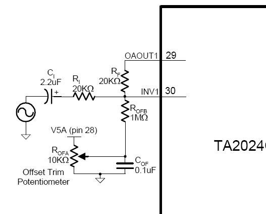

The B1 looks simple enough that I would consider building it as an input buffer for my TA2024 based amp.
Questions are now:
1) I run the amp from a single-rail 16.5V SMPS. Will this be enough to also drive the B1?
2) The TA2024 has 2.2 uF MKT input coupling caps, a 20k input resistor and a DC null circuit as depicted in the schematic on p.11 of the datasheet
http://pdf1.alldatasheet.com/datasheet-pdf/view/143080/TRIPATH/TA2024C.html
(see also attachment)
I guess it doesn't make an awful lot of sense to have this input in series with the 10uF output caps of the B1.
How can I best adapt the output of the B1 for this intended use?
Thanks for any advice
