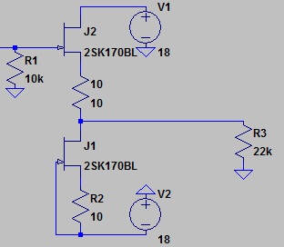

Have anybody here build the buffer stage like this (see attached picture) to get the dc levels of both input and output to be close to 0V?
Of course a presumption is matched and thermally coupled fets but I would still expect some dc-drift but what I would like to know is if its severe enough that I should servo the current source.
Umteen times over many many years, with (like Dennis Feucht) or without source resistor (like Borbely).
http://www.diyaudio.com/forums/pass-labs/124889-b1-buffer-preamp-2.html#post1547019
Best results to be had using matched dual FETs, such as LSK389.
Patrick

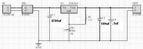

Hello,
I'm building a stock B-1 Buffer Preamp, with the exception of using a bridge rectified,then series regulated(LM1084) supply feeding the B1 boards. I'm using this regulator because it is on hand and I abhor those switching laptop supplies that abound in the stores (Too much RFI for my taste).
Attached is a pic of the regulator.
The BOM lists the use of 15,000uf caps at C1,C2, but I'm afraid this is overkill (literally, killing the regulator).
I would like to choose smaller, very high quality caps at C1,C2, and would value any recommendations.
Some caps I happen to have on hand are Black Gate 100uf/50v; BG 330uf/50v(in multiples), Nichicon KG 4,700uf/35v and KG 6,800uf/35v.
Completion of the project hinges on these components, so, since I might need to order parts depending on recommendations, I appreciate any prompt responses.
-Chas

Killing it in what sense, making it useless?The BOM lists the use of 15,000uf caps at C1,C2, but I'm afraid this is overkill (literally, killing the regulator).
