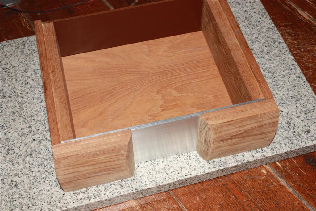

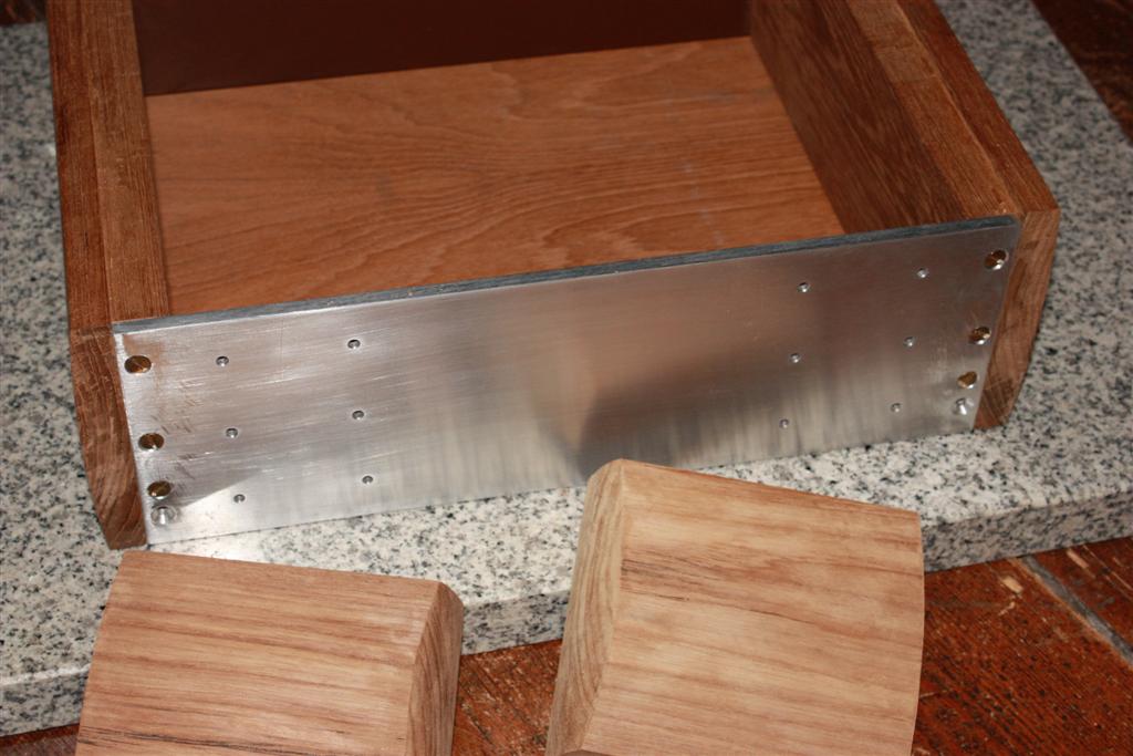

time for me to focus on my own stuff, and box is getting in shape :cheerful:
