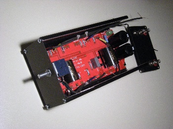

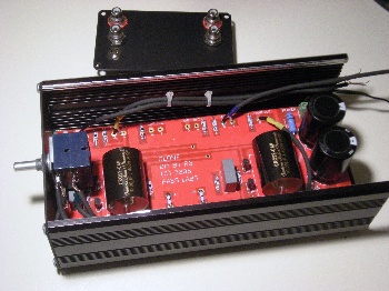

Hello,
I finished my B1. I mounted two buffers B1 with a stepped resistor attenuator with digital control:
http://www.diyaudio.com/forums/digi...ally-controlled-relay-volume-regulator-2.html
Some considerations:
- My system has two main speakers and two subwoofers digital filter. My preamp has two buffers B1 to control separately the main speakers and subwoofer. There is a delay of the signal to integrate well the sub (phase).
- Bypass the signal to integrate into a home cinema.
- Delay relay for on and off to protect the speakers.
- Mute
- Control via remote control
I am very happy with the device. It sounds really good, very transparent and silent. Thanks to Mr. Nelson Pass for his design of buffer.
I have only one little problem I want fixed. A small crack or "click" when turning off the device. Mr. Pass said:
But I do not know how to connect the capacitor ... in series with the switch?, My current line is 220V.
I want to upgrade the power supply of my b1. Currently I have the following scheme built into the device:
Can you advise me a better supply?
THANK YOU!
Some pictures of my "baby"
Excuse my bad English
BR
AL
THANK YOU!
BR
AL
'I found this scheme, but is for a 5V output ... can be changed to give 18V?
I have no knowledge sufficient to change a pattern, so look for an already designed.
