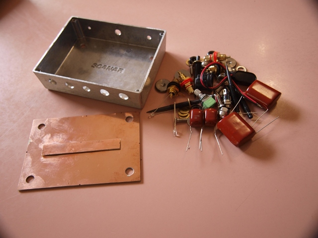

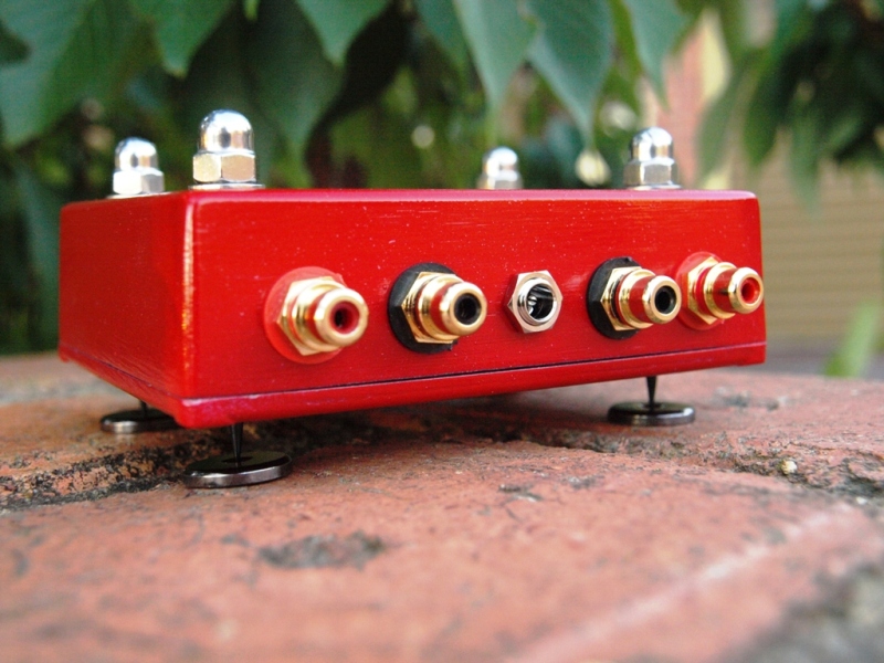

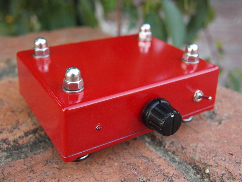

It is my intention to build a B1 in this small case. The bottom copper plate will be ground or negative and the centre strip the + PS feed. I intend to super glue the components to the bottom copper plate.
When building the preamp is there anything I should be careful of in construction and component placing. Is the preamp stable, can it oscilate easy??

The only problem I see with building in this case is that unless you build it point to point, the case is too small to fit the PCB from Pass DIY.

The one thing that gives me pause is using the copper plate for signal ground. I suppose that is fine if you are certain that you would never wire a chassis ground. I would weigh the merit of reserving the copper plate for a chassis ground and maintain a separate signal ground.
Depending on your other equipment, you may inadvertently connect signal ground directly to chassis ground if you one day decided to ground the B1 chassis.

I intend to wire component direct to component. I build all my valve amps this way to. Never use a PCB if I can avoid it.
Thanks for the comment.
The RCAs are the insulated type so I can keep signal ground seperate. I'm hoping the copper plate will provide good sheilding and act as a ground plate.
