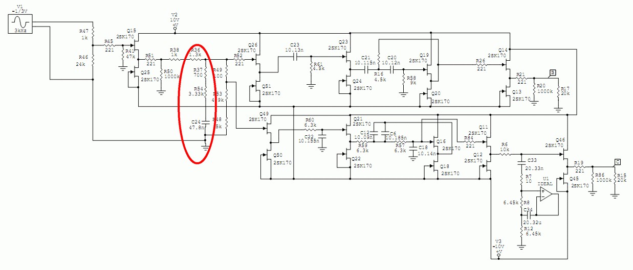

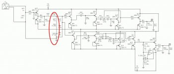

Also, looking at the picture of Rodeodave DCB1XO, I see a complete DCB1 buffer running before the XO section….
My xover starts with a shelveing low pass to implement baffle step compensation, and this is what the DCB1 is working into. I think you can see it in one of the schematics i attached. The DCB1 is also powering the whole xover. I think i mentioned current draw and appropriate resistor values somewhere too.
Thank you Rodeodave, me too I need a baffle step compensation. I'm reading what ESP, Linkwitz and P.Joppa say about how to calculate it. P. Joppa use also a cap in parallel to R1 to boost HF...
I have seen your schematic, as you said BSC is R36/37, what U1 is for ?

A filter ONLY achieves it's theoretical slope and roll off if the assumptions made in the design hold true.
These assumptions are:
a. The source impedance is zero ohms.
b. The load impedance is infinitely large.
If you add a Buffer, then that Buffer is there to try to attempt to meet those two assumptions.
Now look at your resistors and decide if they are interfering with the "filter" circuit, or are outside the filter circuit, i.e. isolated by the Buffer.

... they are outside the filter circuit. I would say they interact somehow with load impedance of amplifier or with interconnects... or maybe they have some attenuation function, but I don't see any reason to attenuate the output signal...
But they are there also in the orginal B1 buffer :confused:
