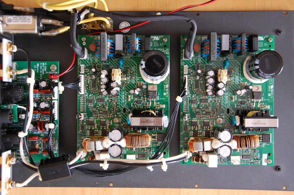

Hello
This is my first post here. I am proud owner of PS AUDIO TRIO A100 amplifier.
Im very suprised - so little, tiny very good amp.
It has two B&O 200ASC modules inside. It is 110V version.
I want to do a voltage conversion to 220V. Guy from PS Audio said that is simpliest thing under the sun. But he don't want to tell what to do... Company secrets...
B&O too. You are my last chance.
Can you help me with my problem?

Lugoshi,
Edit - no jumper o the 200ASC, but I think there is on on the 250ASP...
Anyway, just found my 200ASC - looks like it can take 110 or 220 input -50/60hz. The amp module is OK, the fuse on the PS Audio enclosure would need to be swapped for the 220V fuse. Take some pics, one of us will tell you what you need to do...

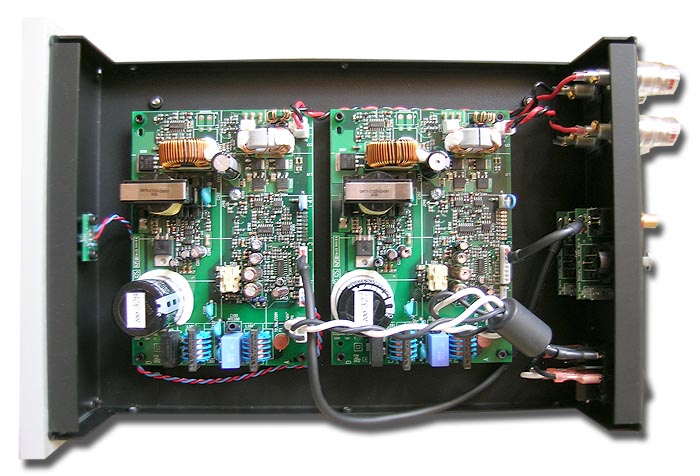

PS Audio Endstufe Trio A-100
Who can post an detailled schematic diagram of PS and amp section from this modules?
from an other ICEPOWER module you will find a (not completly) schematic here (without SMPS):
http://www.diyaudio.com/forums/clas...ic-about-rev-engin-not-complete-finished.html

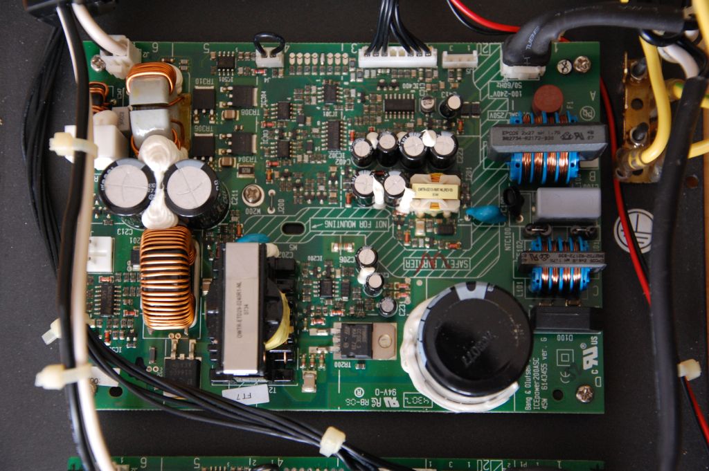

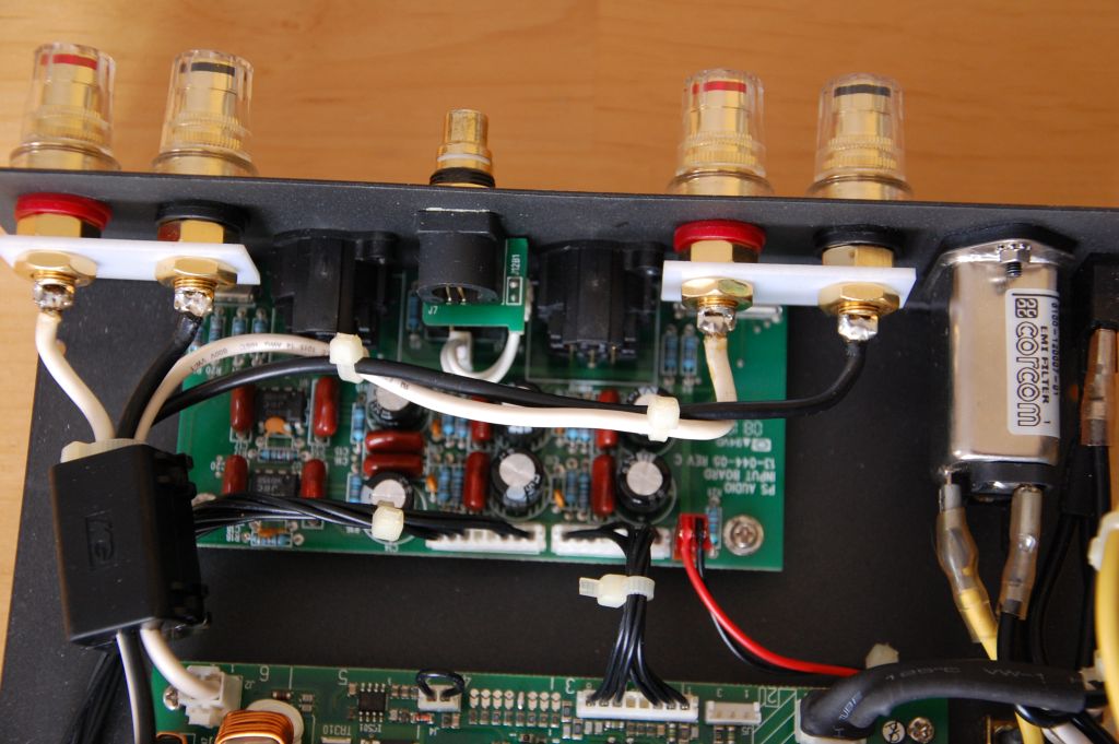

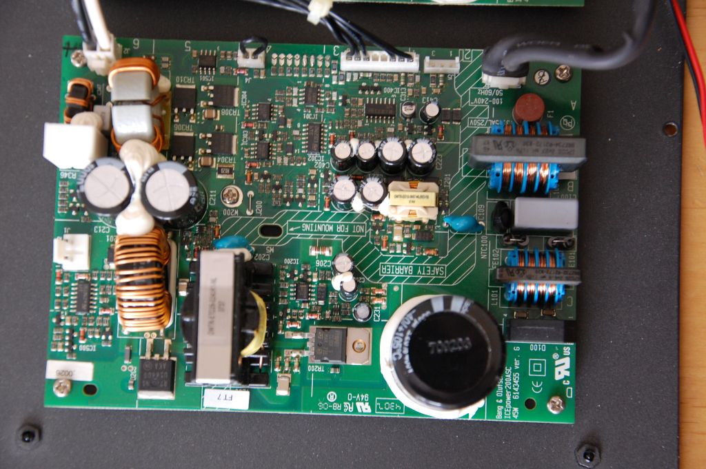

Hello. Thank you for your answers.
I attached four pictures. You can look inside my A100 now.
I'am sure that PS audio made some modifications to 200ASC, and it's 110V gear now.
If you have photos of 220V version (2 sides ) in hi-res - that will be helpfull.
thx for your help

Hi Lugoshi!
All you have to do is just plug in the 230V mains and you should be fine. As stated in the datasheet of 200ASC minimum voltage is 85V AC and maximum is 264V AC. If for example you look at the 125ASX2 module you'll see that there are two ranges of mains voltages and it is also noted that mains voltages should be selected with jumper prior to what you have.
Don't change any fuses or anything! If you look at your cell phone charger, which I believe is smps, you'll notice voltage range and you don't change any fuse if you go to the country which uses 230V!
Best Regards,
Ales
Sorry, but I plugged my A100 to 220V, but something started to "buzz". I waited 1 second for power led but nothing happened. I disconnected amp to avoid damage. Now I'am using voltage conveter 110-220V. Amp is working fine without sign of damage. I don't want risk second time...
I wrote to PSAUDIO they said that conversion is simplest thing under the sun, but it's company secret. ;-)
