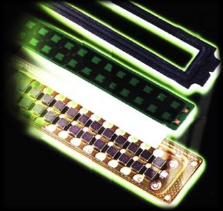

For the last few years I have been working (on the side) with the companies that make the largest push-pull magnetic-planar drivers available (some even bigger than the Neo 10), trying to bring then to the specialty live-sound market.
FPS of Japan www.fps-inc.co.jp has just released the latest upgrade of their FPS1030(M3F1R1) 6x14" planar drivers. I should get my hands on the 1st. pair brought into the country in a few days. They also make 10x14" planar drivers. I have spec sheets, but I will just attach a photo of a small FPS planar driver (exploded) for now.
I have been working on MTM speaker designs based on these med. and large planar drivers as the mid. drivers (& planar HF from any of several other sources), as well as designs based on planar drivers from the other leading sources.

Daveis said:
Ears,
How did you get your hands on some samples? Are they expensive?
Had a chance to compare those FPS1030(M3F1R1) to any of the BG's drivers (Neo or RD series)?
I do contract consulting and marketing work for some of these driver companies.
The samples are in a few locations right now. I should have them all in the same room to compare by month end.
I will post more on the FPS planar drivers in a new thread.
