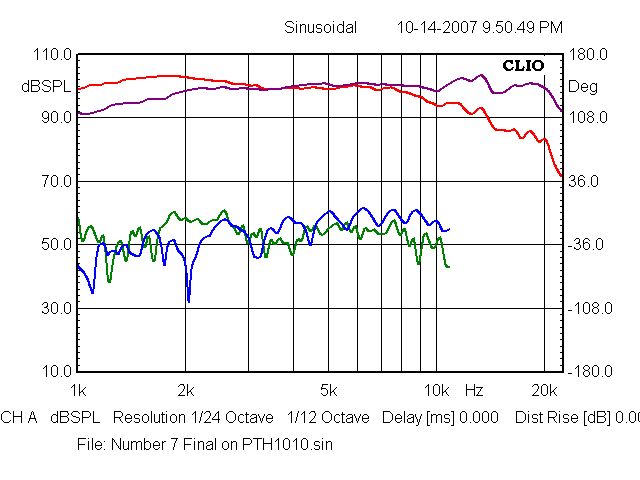

Here's a quick measurement I have of the same compression driver with and without a compensation network at the same SPL measured 1 meter away.
As I see it the actual measured distortion levels generated by the driver will be both level and frequency dependent. The passive networks does not change the distortion levels produced by the driver for a given power input at any given frequency.
Red and Green No compensation
Purple and Blue with compensation
Do you think there would be an audible difference looking at the second harmonic levels??
Rob
Rob
