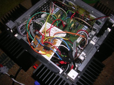

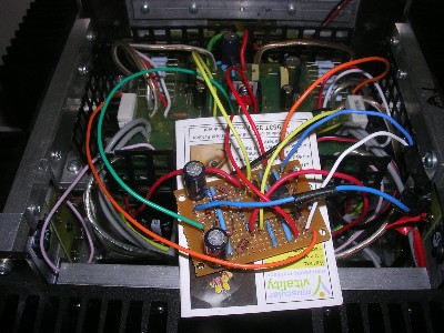

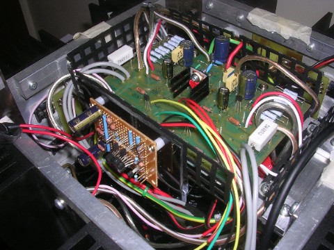

Here is one of the modules under test.
I have Graeme's feedback and input divider values installed.
I had a quick listen to it tonight. Some details tomorrow when I get the other channel up.
For the numbers people, offset at start up was 7 volts from cold and dropped quickly to a few hundred mv.
Relative Offset is about 30mv.
Ian
Ian

I managed to get both channels running tonight with the Jfet front end as per Graemes modifications.
There are two differences: feedback bypass caps are 4.7 pf and I run 4 x IRFP240 and 0.75R sources resisters.
Subjectively its always are hard call but I would describe the result was silky smooth, perhaps a tad plump in the bass.
I certainly prefer the 26 db gain but would like to lower the gain to 20 db.
Perhaps Nelson can suggets the best approach?
Ian
Ian
