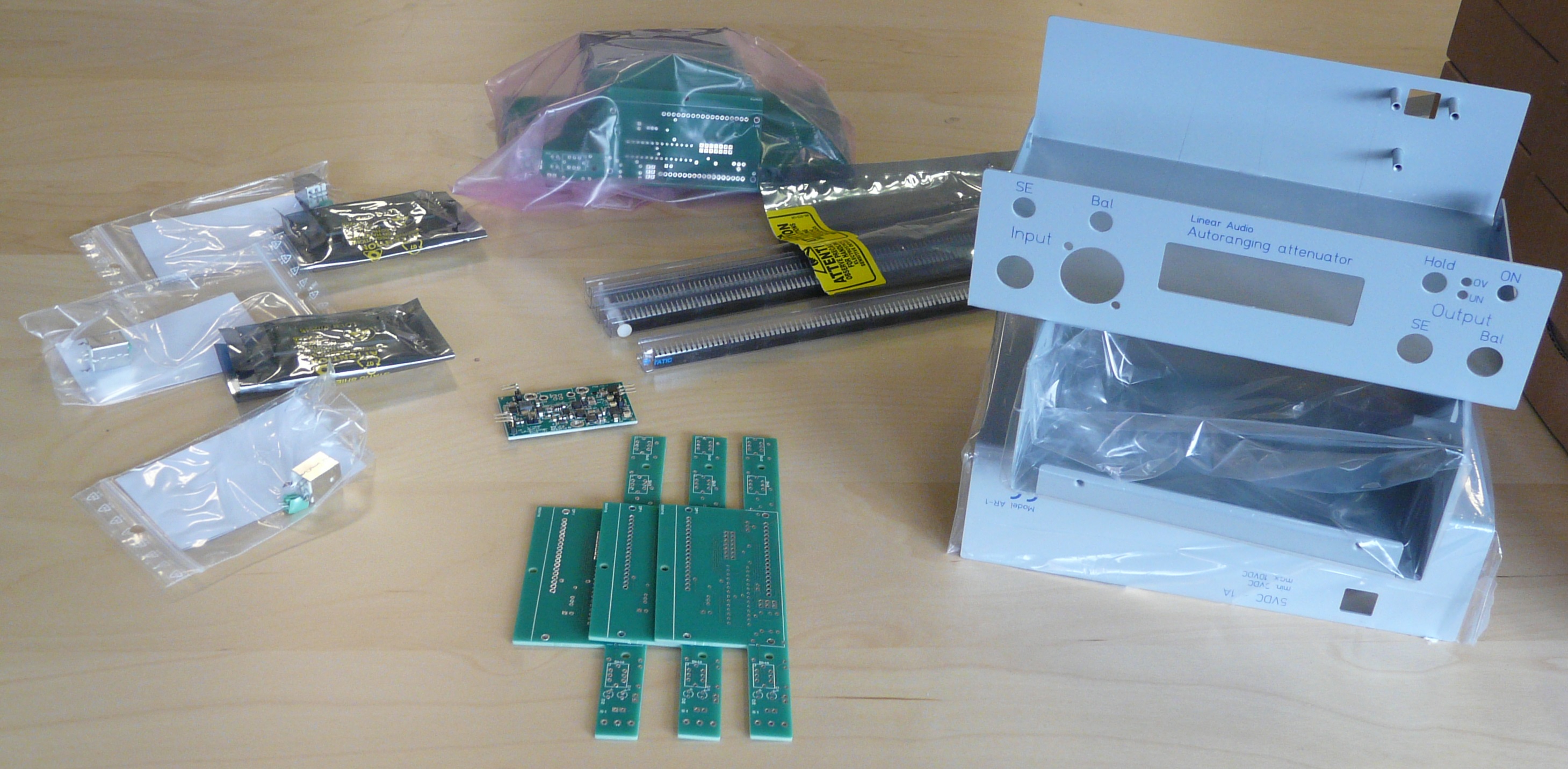

Parts and units for kits start to flow in. I have received: all cases, mounting hardware, all SilentSwitchers, the front panel PCBs, and the microcontrollers to be programmed. Awaiting the main attenuator boards with the pre-mounted precision components. We're getting there!

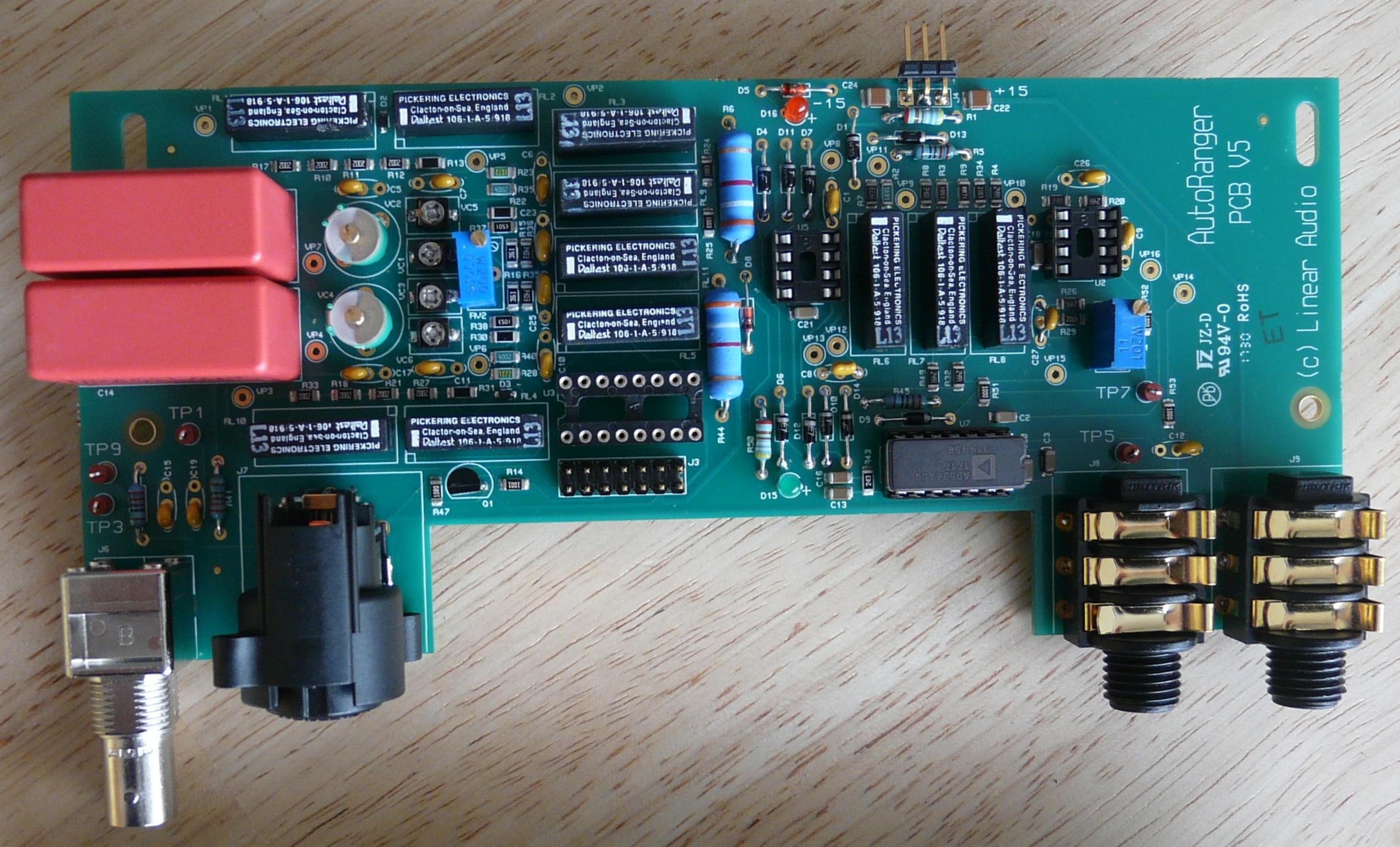

Today I got two pre-production attenuator boards with the precision attenuator SMD parts pre-mounted., popultaled one fully, and switched it on. Just worked. Boring ;-)
See attached pictures. Now you know why I insist on pre-mounted SMD, fully tested by the factory. :cool:
