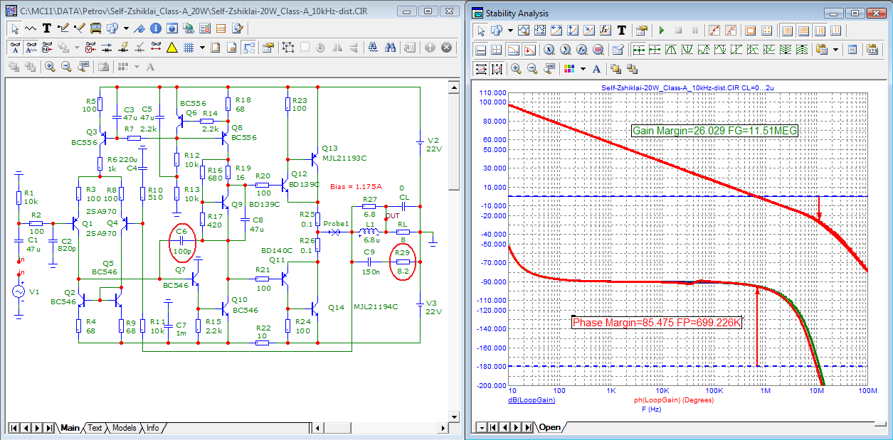

Great amplifier I like it
input signal : 707mV 1khz sinus
Output : 26.5 watt max
Thd : 0.002 %
Gain :25.5 dB
Dc offset : <1mV

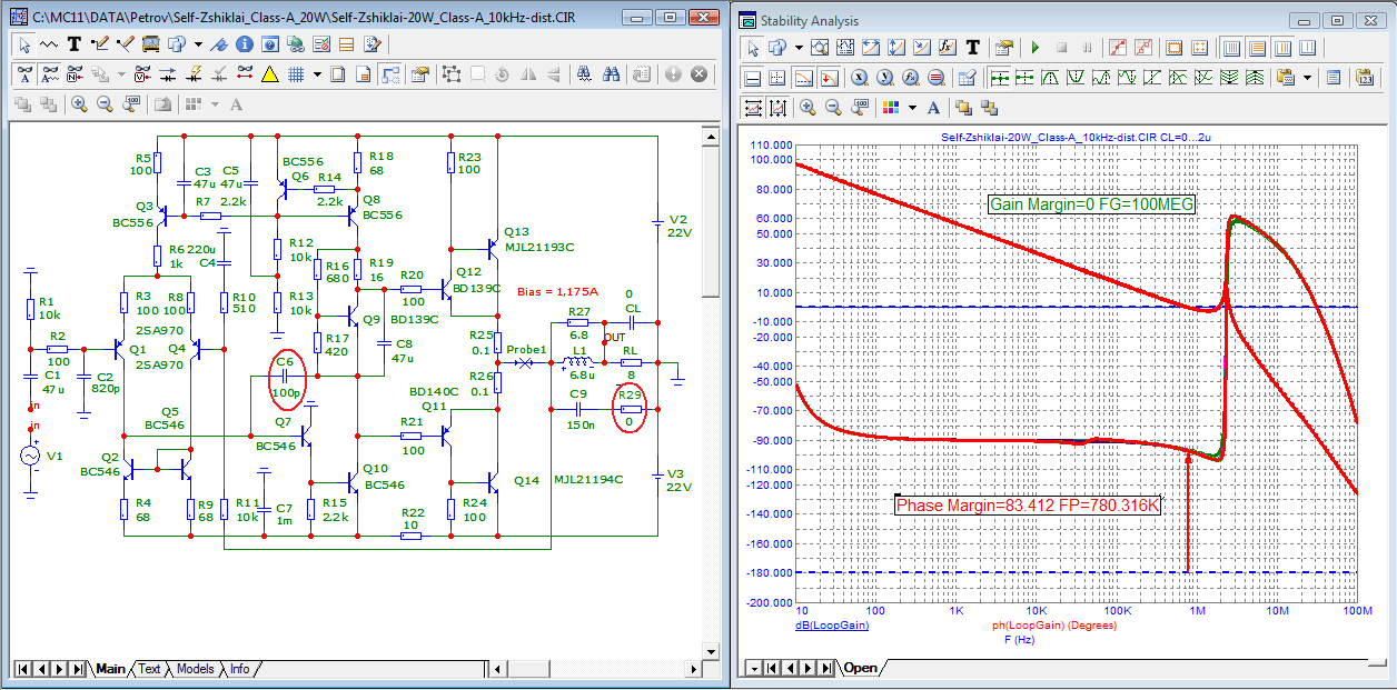

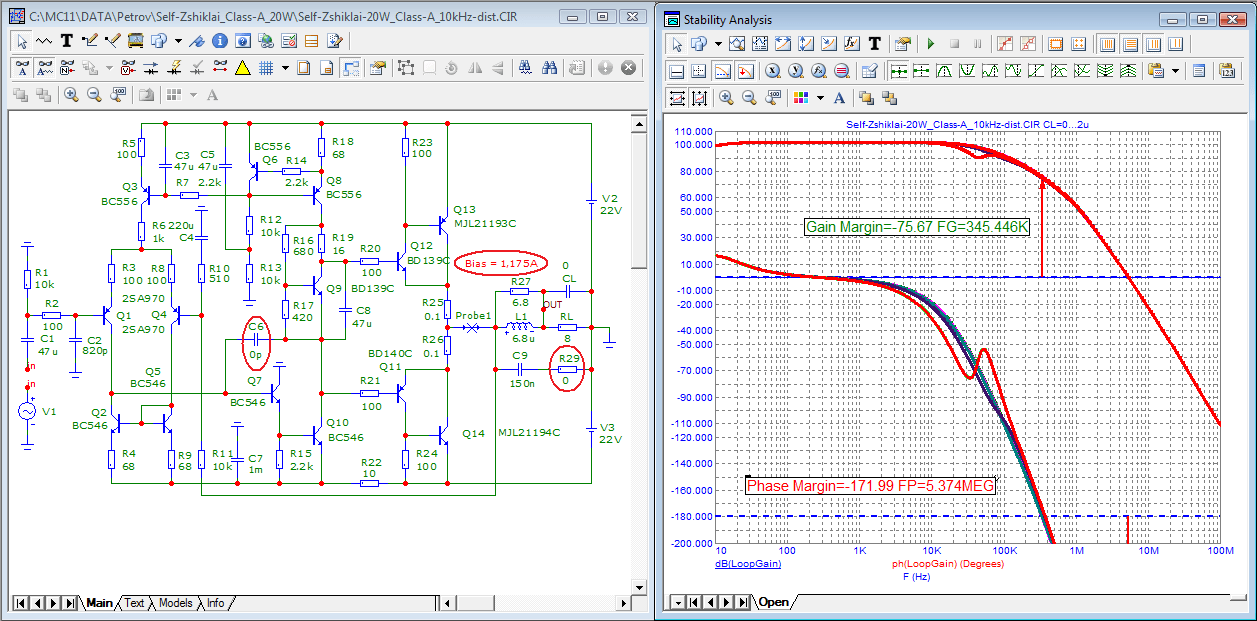

In this form, the scheme is not working.

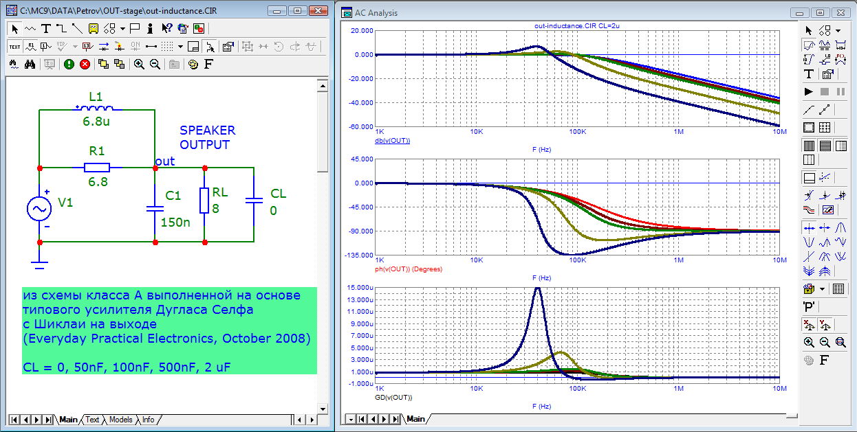

Influence of inductance at the amplifier output. This is what Graham Maynard warned about and what John Curl fought against.
Already beyond the sound range, a high-quality series oscillatory circuit may appear.
