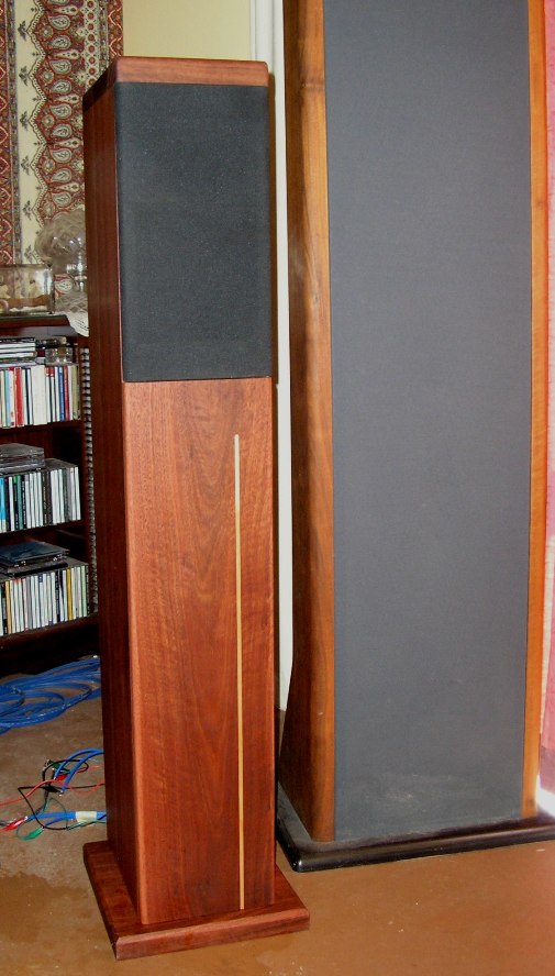

Here are some pictures. With the grill on. They are designed for maximum WAF factor so a grill was essential and the grill is an integral part of the design. They are a wedding present for my step daughter. The grill incorporates thick woolen felt to reduce diffraction effects, and the cabinet is constructed from solid Jarrah and finished with a hand rubbed oil finish. The vertical line is inlayed Tasmanian Myrtle to make the front look a bit more interesting. The other speaker is my Vass electrostatic.

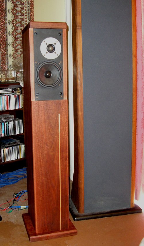

With the grill off. You can see the North Creek D28 tweeter here which contrary to popular opinion is not a rebadged Usher. I have seen pictures of the Ushers and this tweeter is completely different. It has a "made in America" sticker on it, and build quality is the best I have seen in a tweeter. The woofer is the AC130Mk2.
