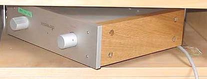

Cheeks
I prefer real cheeks, may be darker complexion
knassiri said:I'll take one. Any chance for upgraded wood "cheeks"?
I upgraded mine o Garry Oak (an endangered species -- the tree was blown down -- you can see it here.
dave
I upgraded mine too, to Mardone Burl:
Peter Daniel said:If there is enough interest, I could offer it again, however to make it worthwile this time, the price would be at least $250 a set (knobs and cones extra, wooden sides and shaft extenders included).
You can put me down for one.
Wade
