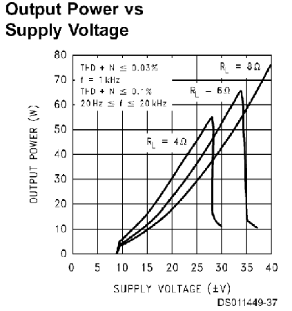

The amp is now powered from 34Vdc and I understand it will give me more power than if is under 25Vdc. The Lm3875 can handle the higher voltage with no problem at all. Also I really don't need the higher power. My transformer is restricted to give me 34Vdc unless I design a drop down voltage regulator to 25vdc.
My question to you is that will the amp improve the sound(eg. giving me a better high freq. response, ie maybe add a little of sparkle at the top *) if I revert to the norminal voltage of 25Vdc. What is you experience on this and your comments?
The power vs supply voltage relationship is presented in attached graph.
I did some tests before, where I was using Variac to change supply voltage and comparing the sound with different PS rails.
It was my conclusion (and two other assosiates) that the amp sounded overall better with higher voltages: more dynamic and alive.
If you use the amp for mids and highs only, the lower voltage may provide more smoothness, but it all has to be checked in a given system taking into account listener's preferences.
All my amps are built with 2 x 22V AC transformers, which gives approx 33V rails. In my personal system I run amps in bridged configuration so such voltage levels are actually preferred.
When I was using battery power, and having choice of either 2 x 12 or 3 x 12V (per rail) I always opted for the latter.
