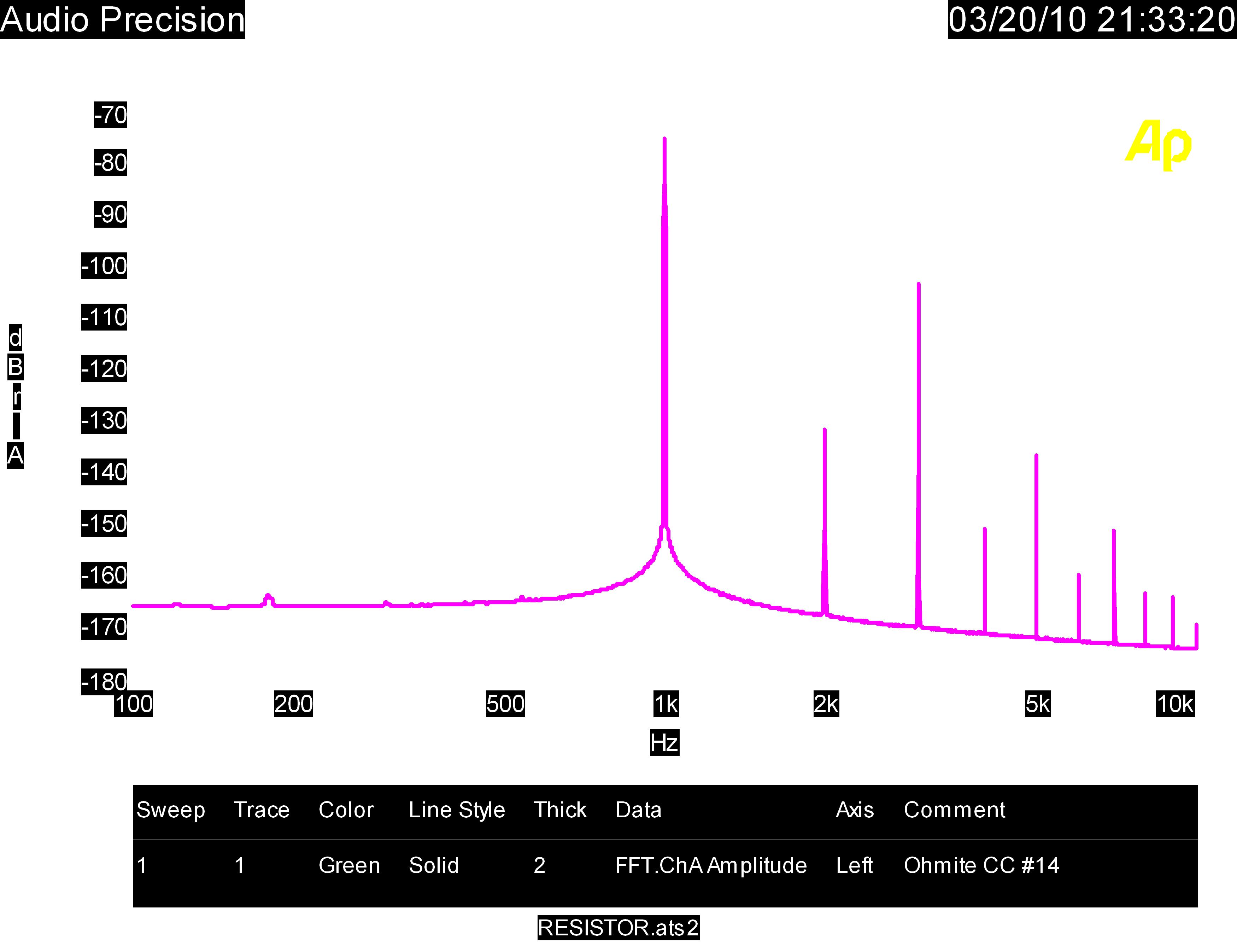

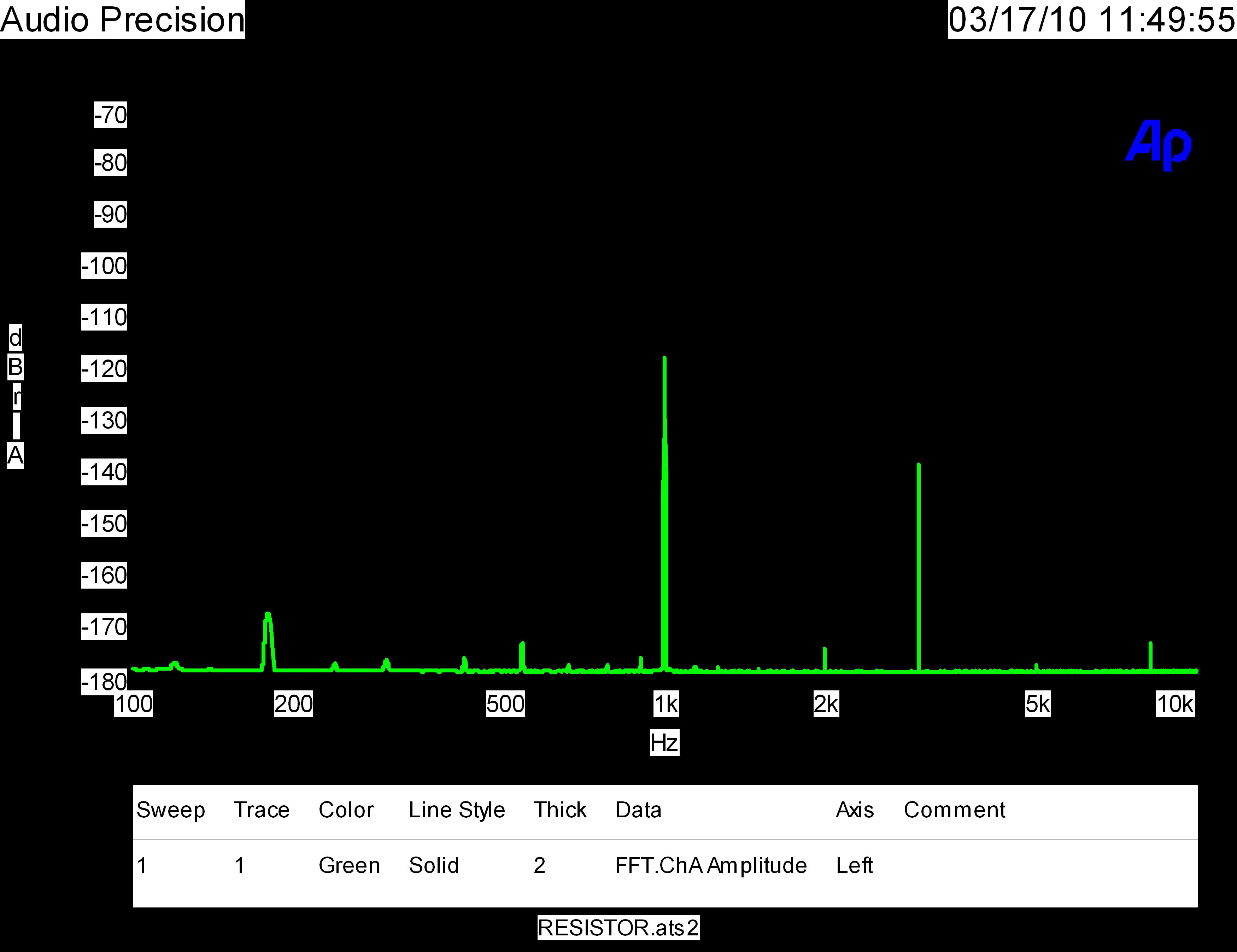

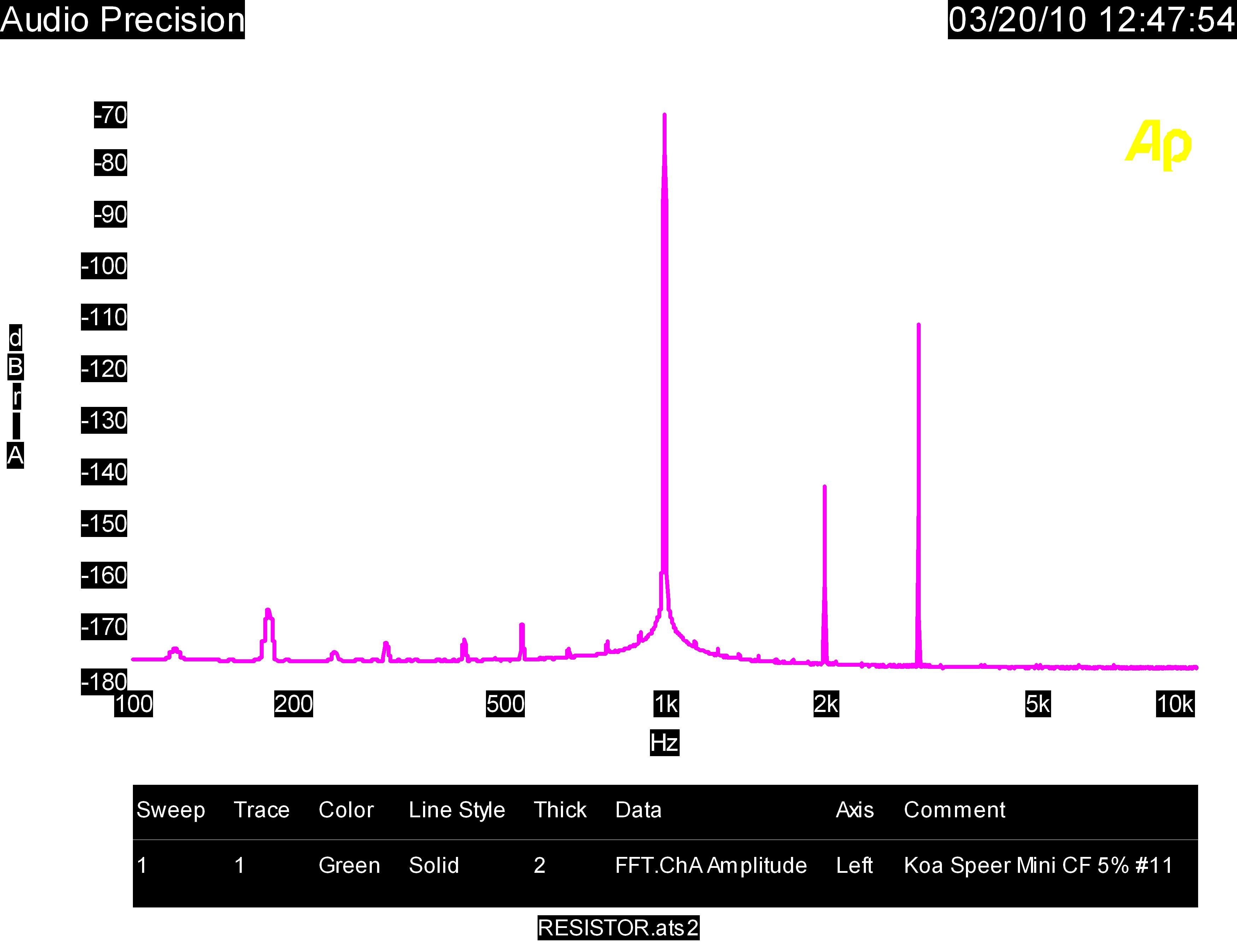

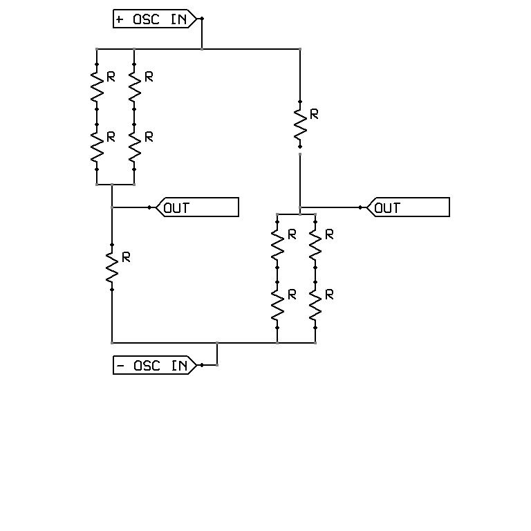

Well a simple No is a negative. It is pretty easy to build a line level preamp and keep all the resistors in the signal path at a few percent of rated power. In this case I would take deference to your night and day comment. BTW without DC there is no HD2 from self heating so many negative comments are holdovers from tube days where there were large DC biases, large voltage swings and resistors typically used at an appriciable fraction of their ratings. In fact usually the carbon resistors I find these days are carbon film and I have had a hard time finding NOS comp ones to easily demonstrate their short comings like excess noise to younger folk.
