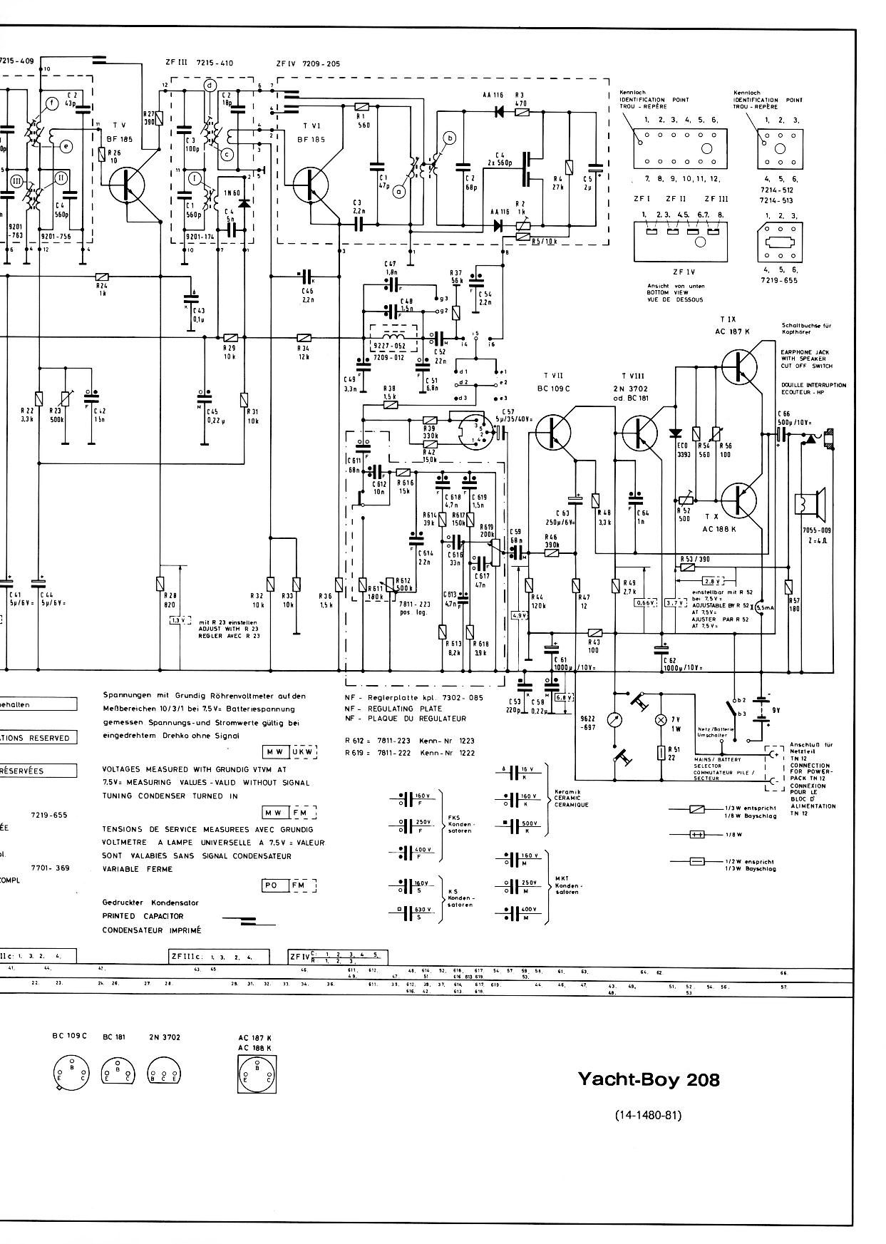

Hi Bob
In fact it predates largely Cherry s article and Baxandall findings ,
see below the amp part of Grundig Yachtboy portable radio circa 1967 ,
C64 is the miller cap and goes from the amp output to the VAS input ,
effectively enclosing the power stage.

The Yacht-Boy schematic is most interesting, but it is notable that the output stage is just two devices without a driver stage. I imagine that's why it was stable. It would be interesting to find out if it was done in an informed fashion or by accident.
