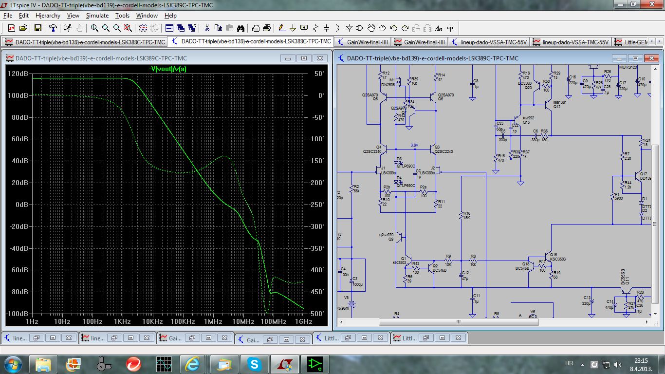

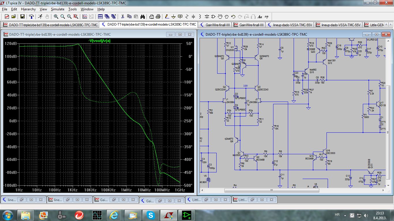

Here is how I try to simulate TPC-TMC combination.
First picture TPC only with no capacitive brigde over TPC (C22)
Second picture TPC only with cap bridge(no overshooting). This small cap could be just parasitic.
Third picture TPC TMC simulation, Middlbrook probe between output and TMC resistot(R30).
I am not sure this approach is good enough I could be completely out of track.
To small phase margin is not for the moment od any concern as this simulation is here just an example.
BR Damir

All three amps are a disaster waiting to happen.
They are all only conditionally stable, meaning there are closed loop gains at which these amps are not stable (that is, where the phase hits 180 degrees before the ULGF). While this is unlikely to happen during normal operation (although I would carefully check the stability when the output approaches the rails), during power up and power down such amps do have the nasty habit to burst into oscillations. Depending on the power supply and how lucky you are, it could be anywhere between one day and one year until such amps will blow in the user's face.
As a rule of thumb, audio power amplifiers should be unconditionally stable, with a healthy margin of at least 20-30 degrees at all frequencies.

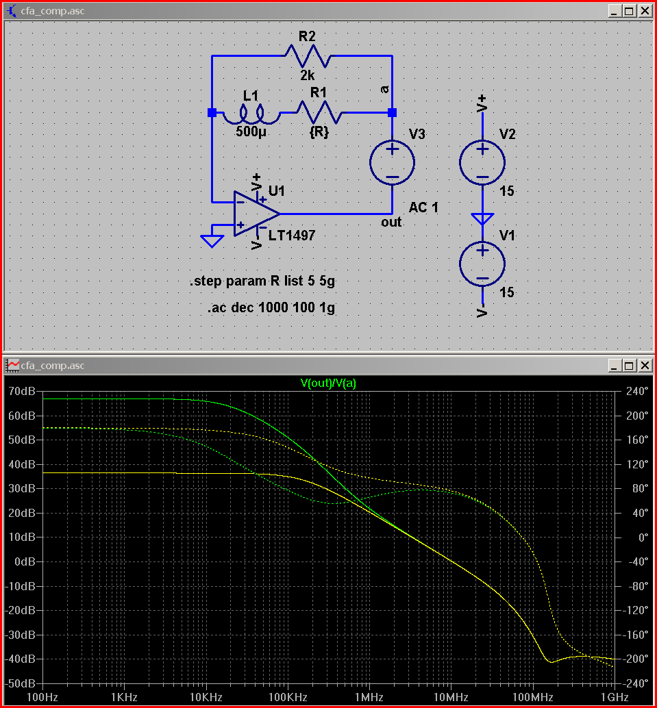

just for entertainment value - CFA "TPC" - inductors are usually avoided in small signal audio - but are used in J990 discrete op amp
(shows a little lower gain with the Middlebrook/Tian loopgain probe - but much harder to show stepped component effects)

Did you read my text??
I expected some comments the way I simulated those TPC-TMC combination, and not about the amp, it is not meant to be built as a real amp just an exercise.
But way a power amp should be unconditionaly stabe, it not an OP amp or a buffer?
Even some OP amps are not unconditionaly stabe(at the gain of one).
My TT amp with TMC(look in other thread) is not unconditionaly stable and I use it for year in every day listening.
BR Damir
re: post #545
Hi Damir,
even if the current circuit is only playground, it would be interesting how a sound evaluation of such a structure would look like.
Apart from the behaviour of the outer-most global loop (btw., I somewhat agree with the remarks of Waly in post #546), we should investigate all loops, here at least the loops around the VAS alone and the loop around VAS+OPS due to TMC.
In your Bode diagrams, I only see results for the global loop.
BR,
Matze
