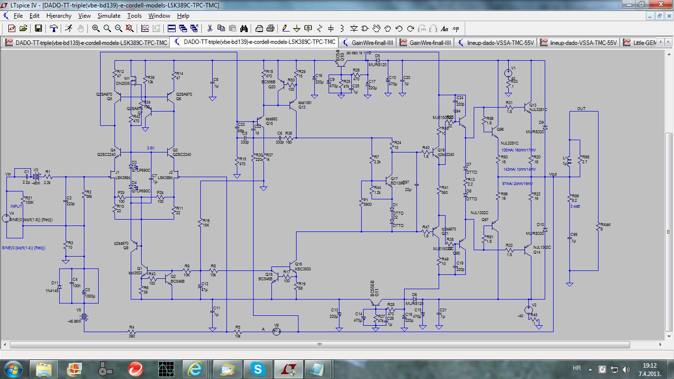

Hi Edmond,
I have read all those before, but my simulation shows different result. When I swap C5 with C23 THD20k jumps from 0.000020% to 0.000071% with all else kept the same. I could be that my values are not optimal but still way I’ve got that result?
BR Damir

Hi Damir,
When I swap C1 and C2 in my schematic, I also get lower distortion. BUT... at the same time the ULGF gets higher (which explains the lower distortion) and the phase margin gets lower. IOW, it's a trade-off between stability and lowest distortion.
E.
Hi Edmond,
In my case the ULGF vent from 2.03MHz to 2.35MHz and the phase margin stayed the same(55 degree), but distortion dropped by 11dB. For me that swapping worked, stability did not suffer.

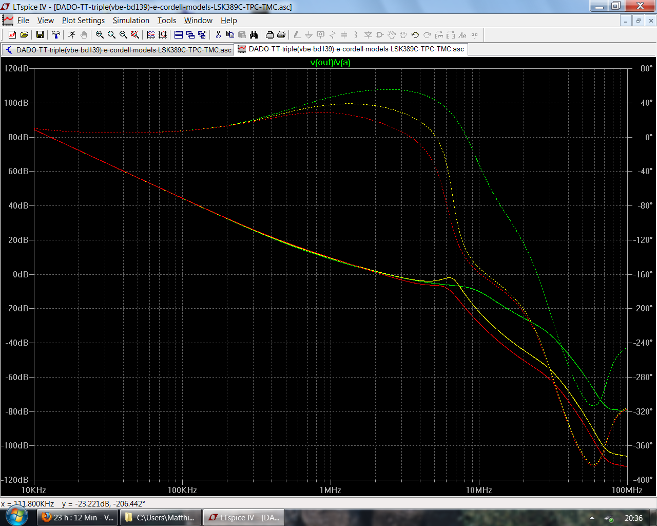

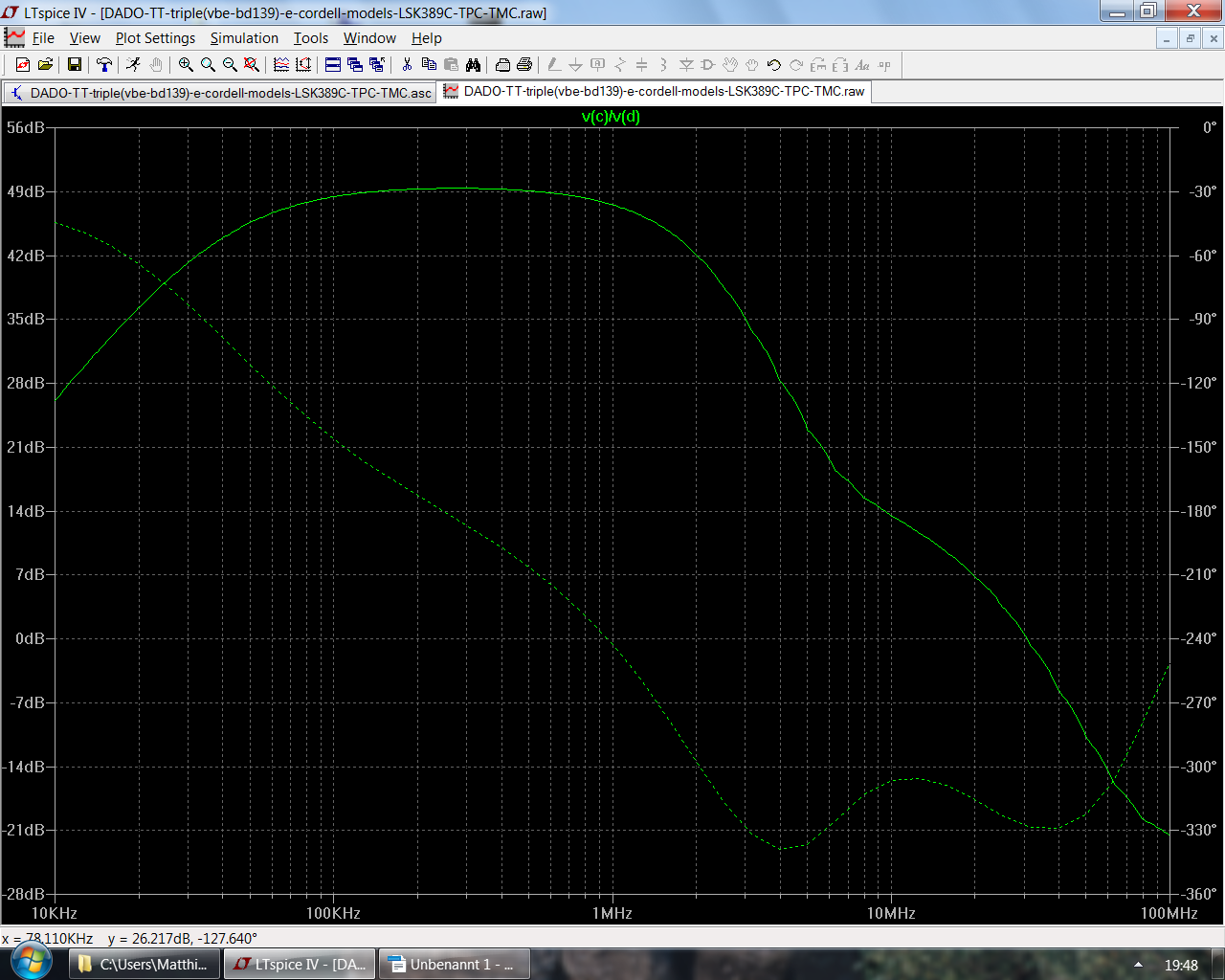

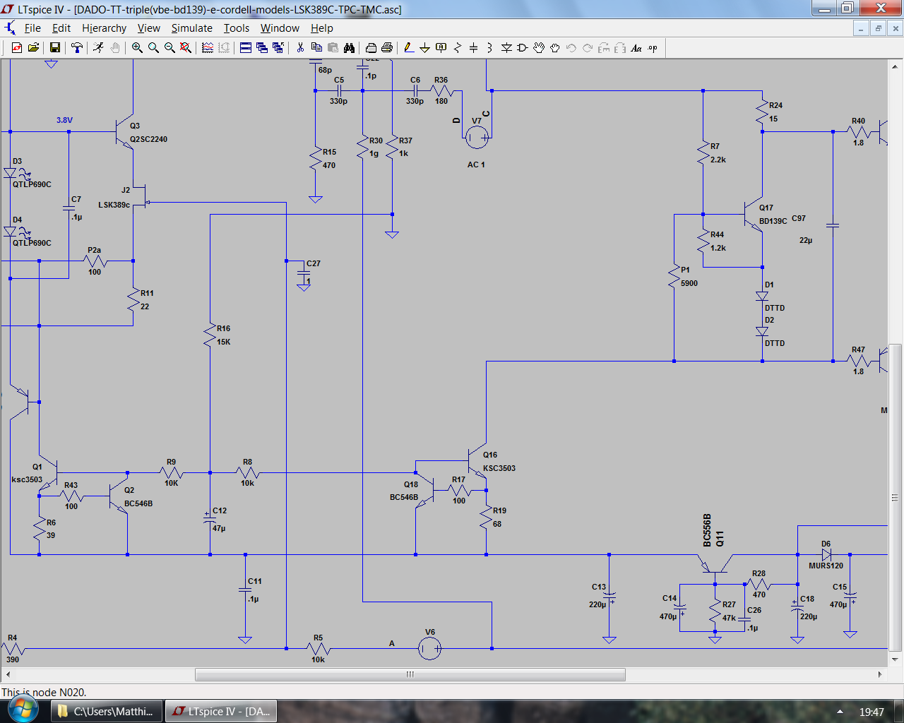

Hi Damir,
first I want to agree: superb performance for this "rather simple" topology. Difficult not to be thrilled.
The loop behaviour around 50 Khz (almost positive feedback) is, as I understood quite late :cool:, of course due to the two-pole compensation with its slope of 40 dB per decade.
I played a little bit with your schematics. Being always conservative, I was interested in the VAS stability under TPC conditions. For that (bode-VAS.png), I shorted the main NFB loop by C27 at the negative LTP input and turned off your AC source V6. Then I added a new source V7 in the loop around the VAS. What I did not know to cope with was the TMC connection via R30. For simplicity, I just made it almost isolating.
The outcome is in bode-VAS-result.png.
The phase margin is around 30 degrees. Do not know whether this is already critical. At least does the KSA992 model include a base spreading resistance RB, so it might be realistic.
My general question is: how can one cleanly evaluate the behaviour of the three intertwinned feedback loops i) main loop ii) loop around VAS iii) loop around OPS/VAS due to TMC? Did you already reason about that?
Would be a pity if one could only observe e.g. the transient response on a square wave and hope that everything is nice if that looks OK.

Hi Damir,
here is also the main loop's Bode diagram for purely capacitive loads (green 1pf, yellow 10nF, red 20 nF). The load resistor is 1Kohm.
With no-nonsense speaker cables such capacities clearly should be out of reach, but High-End audiophile cables can reach these values.
Matze
in the Cordell Book thread I showed several ways to test loop gain that give a fairly accurate result for TMC - you have to measure inside both loops enclosing the output Q
http://www.diyaudio.com/forums/soli...s-self-wants-your-opinions-8.html#post3402379
the square wave response for TMC doesn't indicate stablity margin as we are used to with simple dominant pole Miller compensated amps - a reason for warnings against using TMC if you don't understand stability evaluation at a pro EE level, would be "nervous" using 2-pole - they are similarly complcated, TMC easliy measured incorrectly
