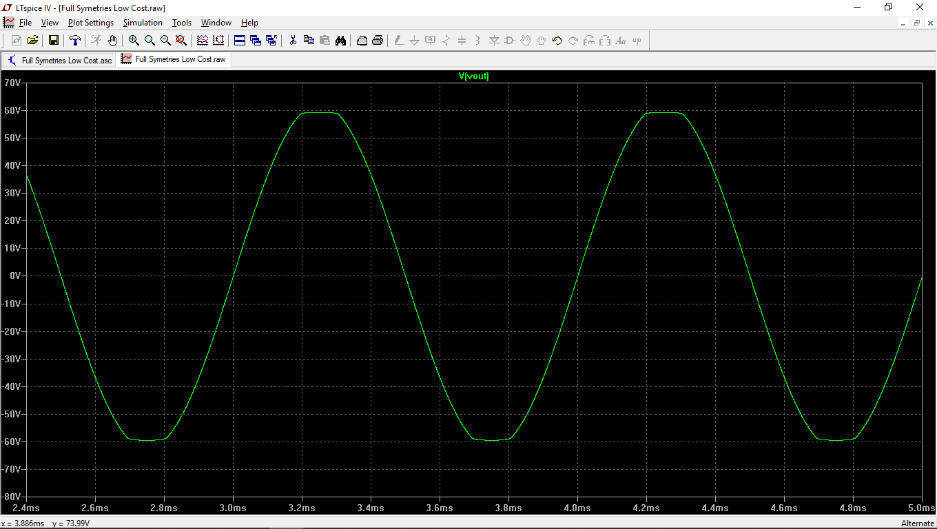

I often wonder why Mr. Self did not use these symmetrical designs to
elaborate/base the books on. From a hobbyist standpoint , they are just as easy and
have fewer issues. My CFA SP can match a blameless without TMC
,clamps or any other B$ to tweak the design.

Hey 400 V/us is just about 40% as good as the Harvard professor's amp. Congratulations. Keep bragging about it, you have a lot to be proud of, a mere factor of 2.5 below academia.
That brings up the question , why did HE do it ?
Besides a "mine is longer" metric for his amp , what is the purpose ?
Showing off the expensive $$$ "academia" ?
PS - I backed down to <200v/uS for the final design. No ringing and
ultimate stability out weighed "mine is long". BTW - I had a near 1KV/uS
"infidel" H bridge design . It was just thermally unstable and picked up
Room RF when built. I scrapped it and went with my present CFA.
