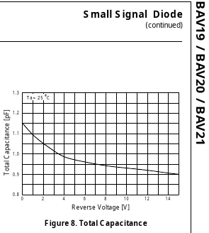

The onsemi/fairchild BAV21 has mostly lower as 5pf capacitance.
My current batch has about 0.8pF measuring 2 diodes in series (one reversed) with 1Vpp@10kHz and 1,6pF at 0.2Vpp@10kHz
Tested with my smart tweezer.
The capacitance decreases with higher reverse voltage. Have a look at the excerpt from the onsemi datasheet.
BTW: if you want to buy onsemi BAV21 - the status is last shipments via rochester.
BR, Toni

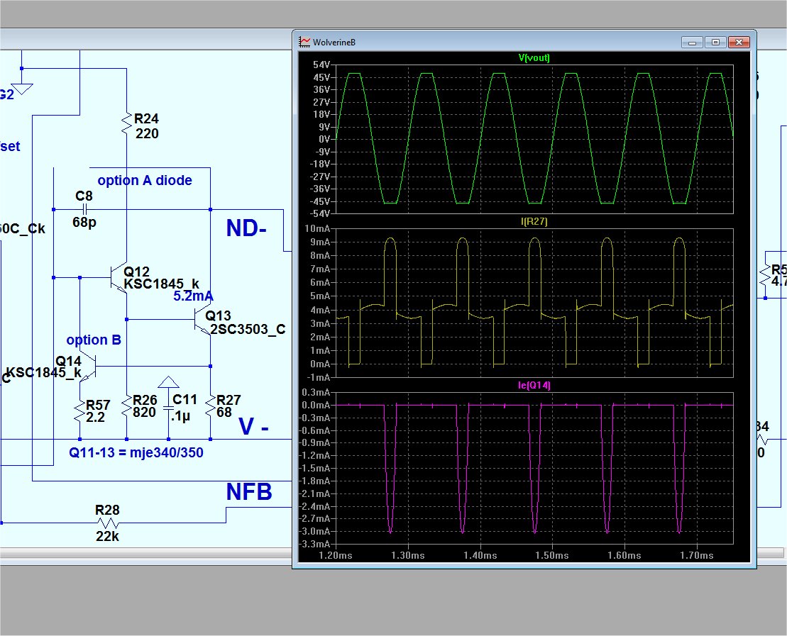

why the diode.
Used this as "option a" on my blameless.
Same 13ppm with or without the clamping transistor (Q14).
"option B" (the diode) some were slightly better , all options just
a few ppm difference.
Both ways get the job done.
OS
