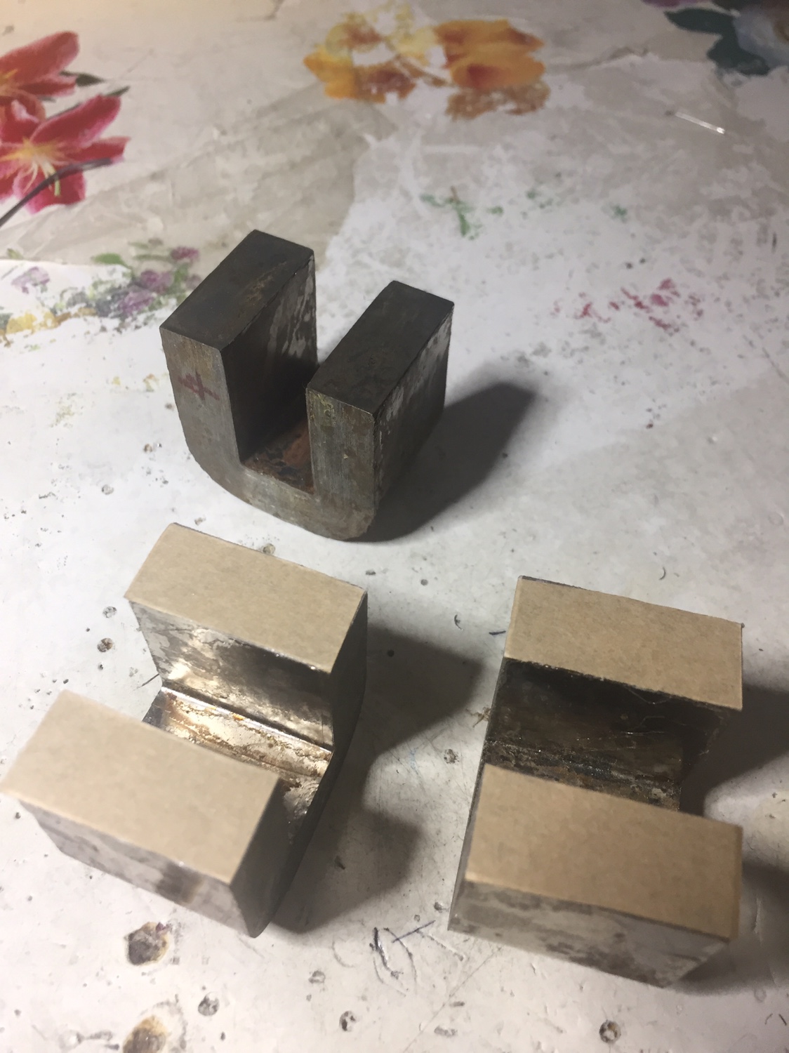

Assuming the gap size is right what happens if you clamp the cores tighter?
Be careful with tight clamping of amorphous c-cores; it is not difficult to deform the C with too much pressure.
I remember tightening the bands to get more inductance, until the inductance got eventually lower :confused:. When applying too much pressure the air gap became wider at the outsides because the C "spread it's legs" :D.
Silicon steel c-cores are a bit stronger (but therefore less sexy).

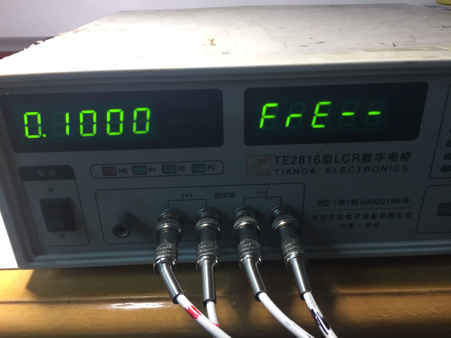

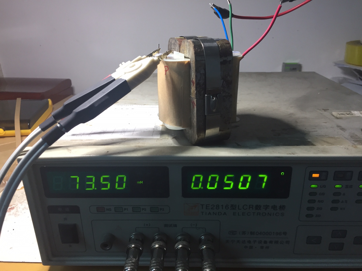

1.Input signal is 1V
2.I did not leave air-gap, how to decide the size of air-gap?
3. The prim have 9 sections and 4512 turns in total

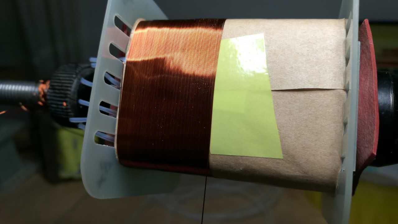

If you have 20mH with 9 primaries and 8 secondaries on that core then I can only think that coupling is not good. You should avoid soldering that large piece of wire in the middle of the layer to bring the wire out. It makes layers uneven and difficult to wind. You should choose the wire to end the layer at the end of the bobbin, not in the middle. If the space is not enough choose another wire or another core. This is not a choke!!!
If you use 1V at 100Hz then that's really a minimum (basically DC) inductance. Induction in the core is really tiny. Use lower frequency with 3-5V and it should much better. If you pass DC for inductance measurement then absence of gap might make it saturate. You need some gap to pass 10 mA DC. If you don't have DC for inductance measurements then the problem might be the core itself. I see that the C's don't match really well....
The reason why you don't get 100H might be because that core might not be what you think? I never buy these things from generic vendors without quality control because bad surprises are always around the corner....

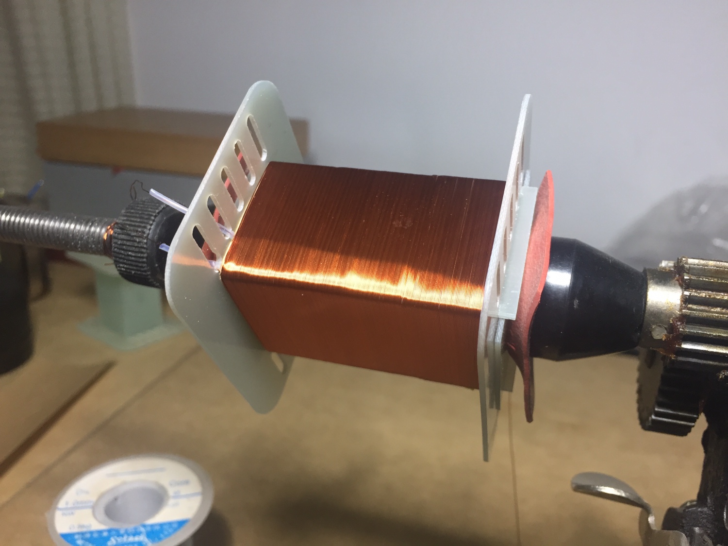

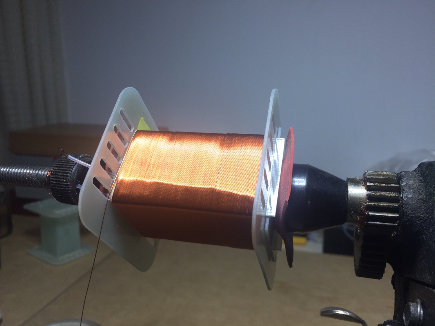

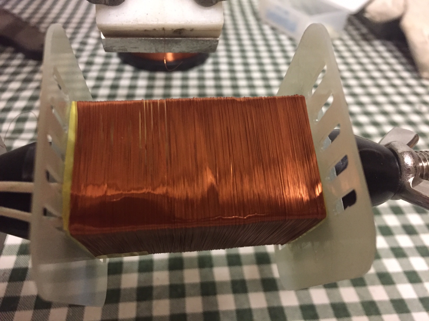

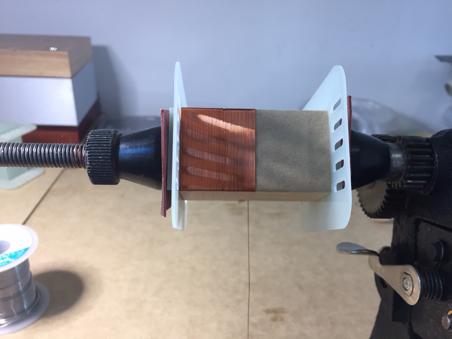

First attempt is failed the wire diameter of Sec is too large
Second time attempt I use 0.13 for Sec
That's random winding; bad quality power supply transformers are wound that way.
It will not give a good audio transformer.
Try to invest more time and patience to arrange the windings neatly without crossing; that will also save winding space.

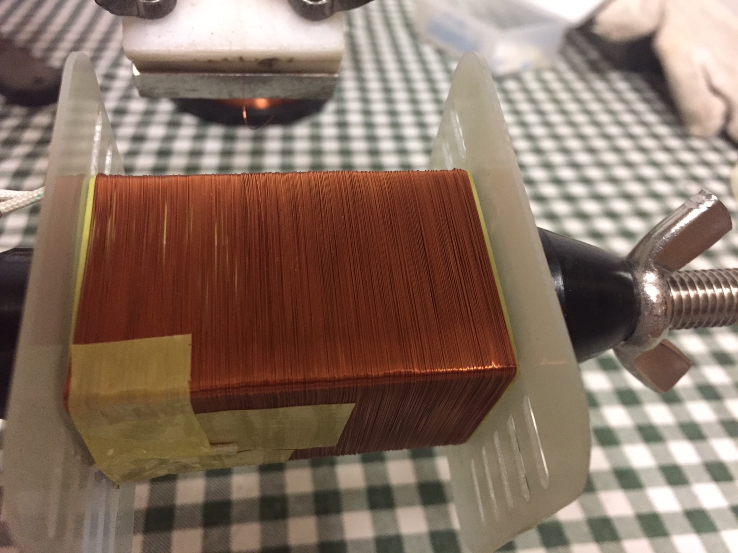

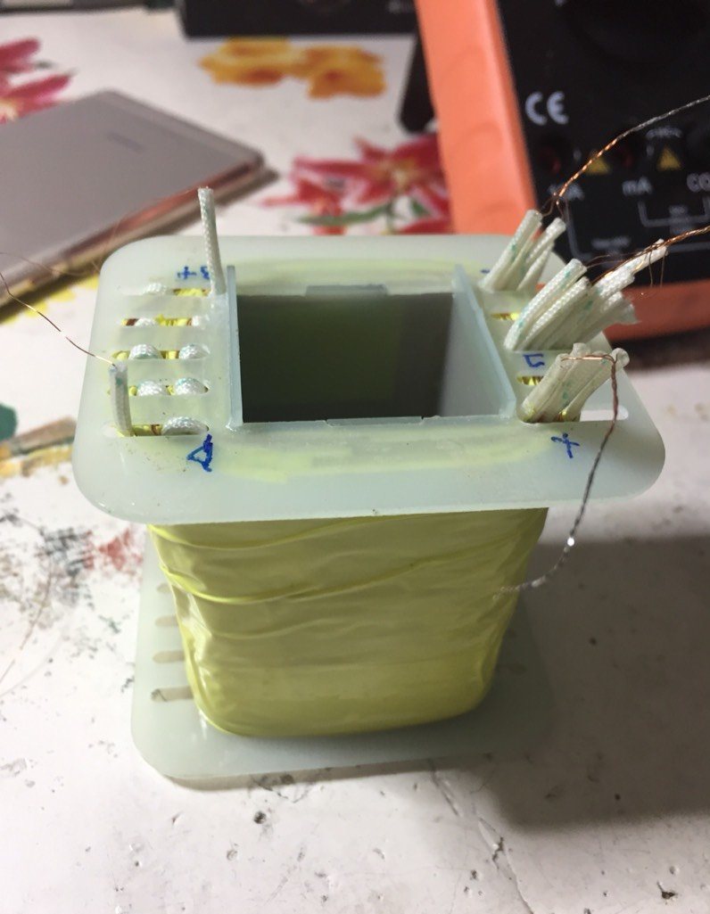

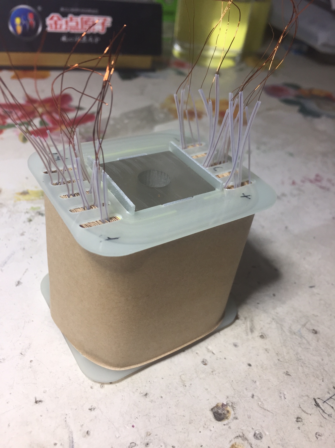

I finished the coil, Prim 4512 turns(0.13mm), Sec 1370 turns(0.13mm, 4 groups parallel connection)
A bad design :eek:
You used about halve the available winding space.

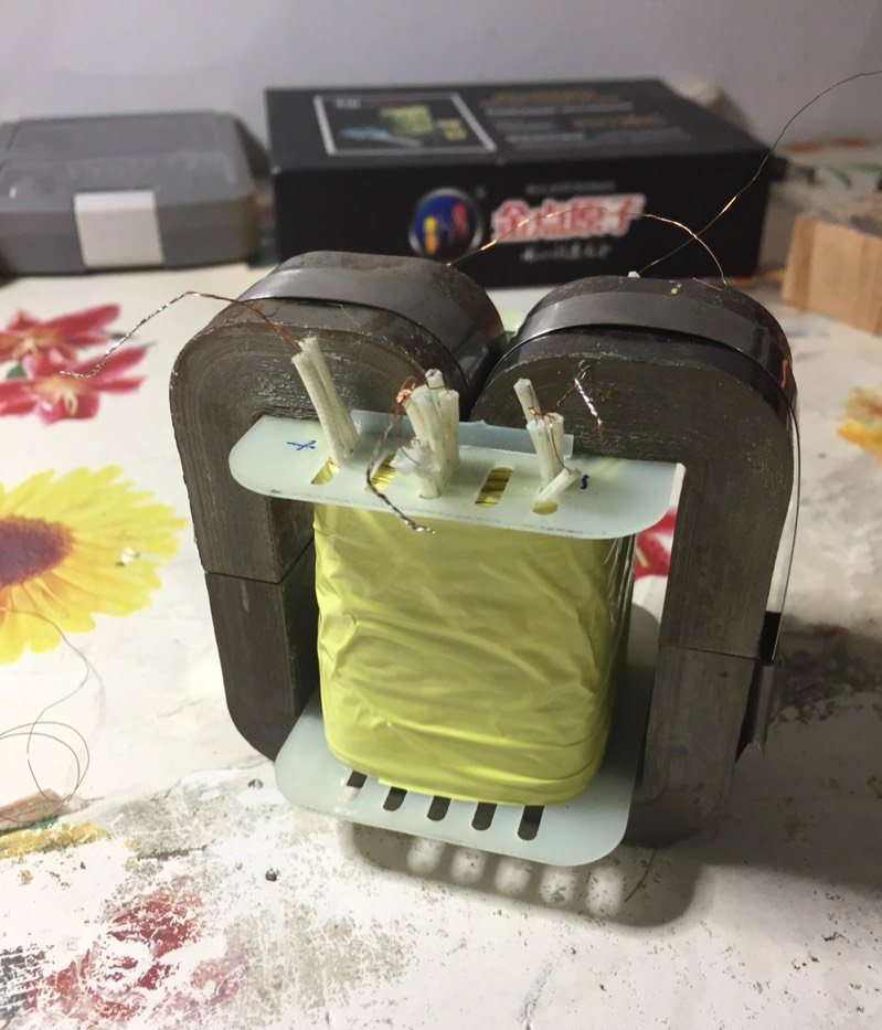

The c-core halves are not tightly kept together by the bands, so there can not be a stable fixed airgap.
Check if the c-core halves are correctly paired; it looks odd.

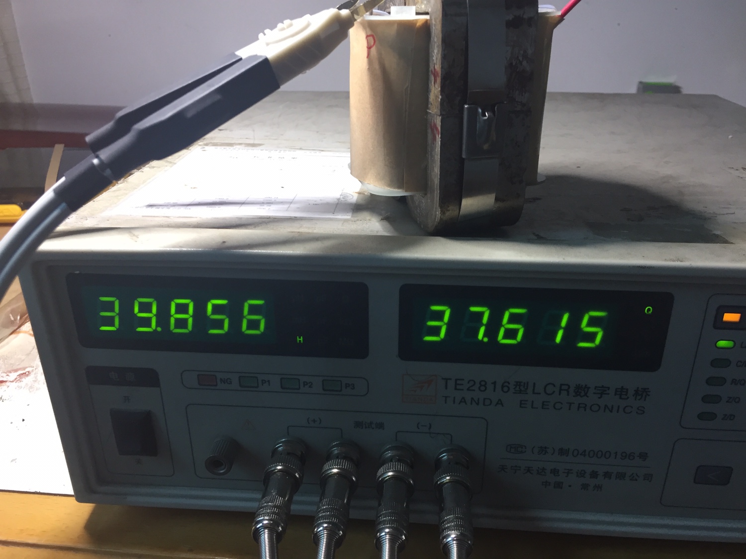

Winding another coil by hand using the same design for comparison
73.5mH is a huge amount of leakage. Do you trust this LCR meter?
A not entirely, but more realistic method of measuring parasitic parameters is to short the secondary, then add a capacitor with a small (10-20nF) value shunting the primary. Then measure the first resonant frequency across the primary. Then measure it again without the capacitor. The later should be the default first resonance and higher than the one with the shunt capacitor
The added capacitor is practically in parallel with the Cp (shunt capacitance), so the resonant frequency will be lowered. To find Cp:
Cp = Cadd / [(Fres1/Fres2)^2 - 1]
Fres1 is the frequency without Cadd
Fres2 is the frequency with Cadd
