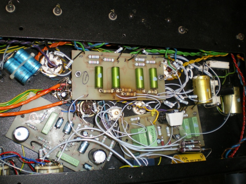

Hi,\\As I don't know much about all circuits, is it possible that you can post some photo's of each of the upgrades? That wil help me a lot!

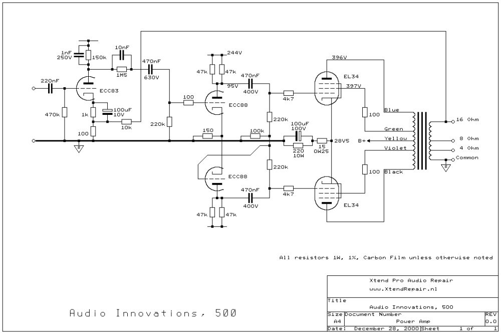

I want to ask you a question. In my amp the voltage at the reference points differ from those in the scheme:
C - 360v. (Instead of 390v) D - 354v. (Instead of 380v.) E - 322v. (350) F - 283v. (300) I - 214v. (235) R - 25v. (28)
DC - 5,9 v. (6,3) but AC-6,3 v - for tubes V4-V9 - correct. 'll Show why? I would be very grateful for the tip!
KOROVIN.

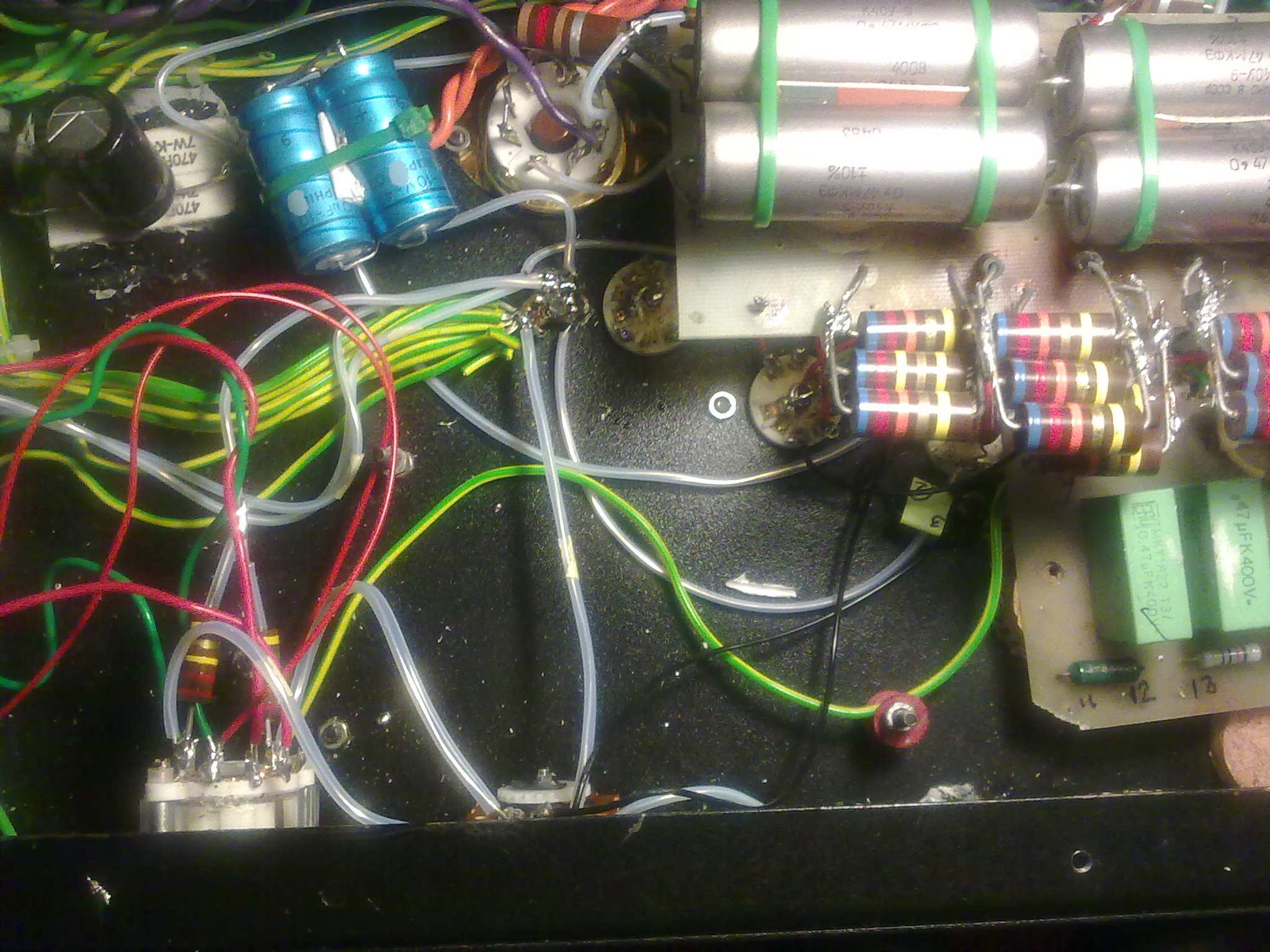

I rebuild the AI500 and placed new paper in oil capacitors and Allen Bradley resistors
that's working super.
I also want to remove the phono stage
Can somebody help with tips for that

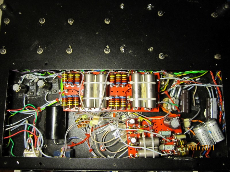

the upgrade ent further ander further.
I got rit of the phono part in the Ai 500 and changed tube settings.
Also I switched the potmeter to another place. I have more room for a shunt attenuator which I shortly want to make.
hereby a pic of the latest AI lay-out.

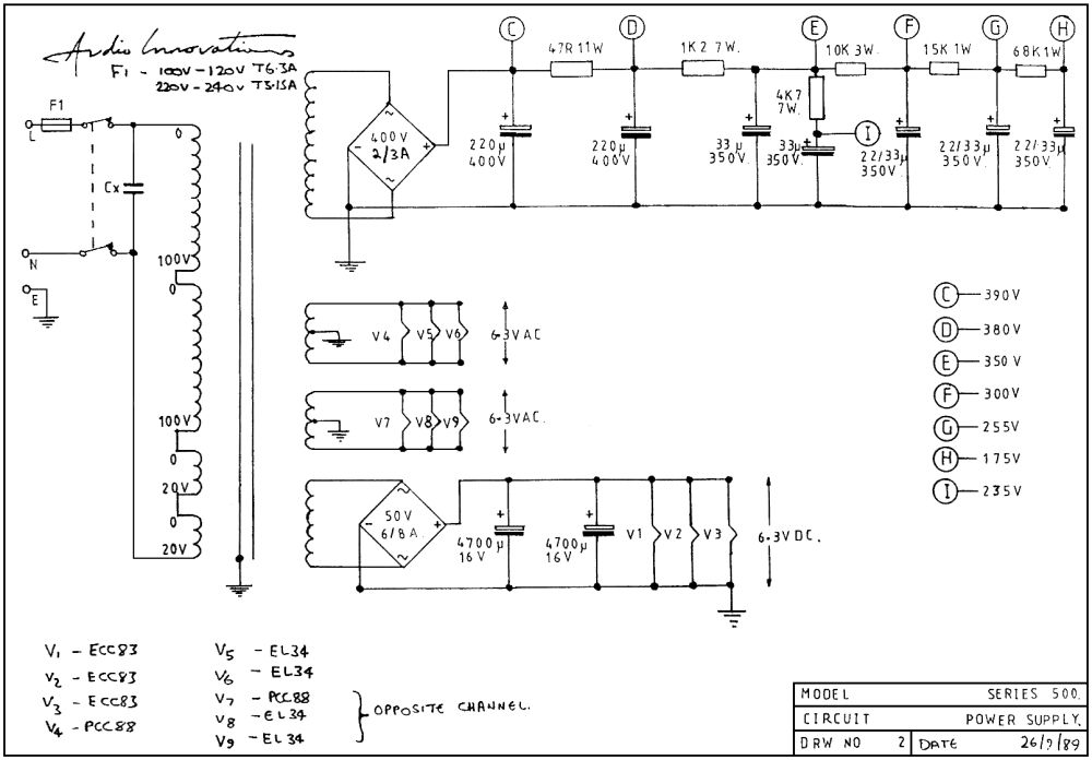

Hi, I am restoring an Audio Innovations series 500 integrated amp, the one with EL34. My problem is connecting the power transformer primary wires. From the PSU diagram from drtube:
http://www.drtube.com/schematics/ai/ai500-89-4.gif
the color wires are not shown, my amp has 8 (I think) wires: blue and brown on switch, and red, yellow,purple, black, orange and grey. Does anyone know how to connect the jumpers? Actually I need 120V. Thanks, Frederic.
