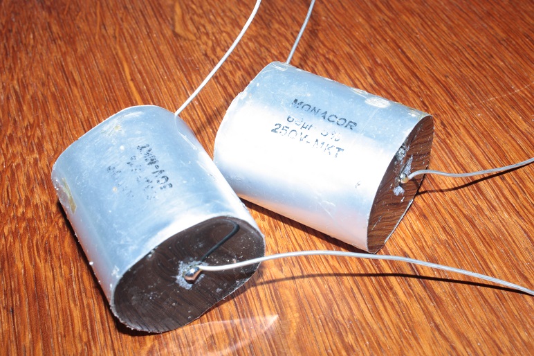

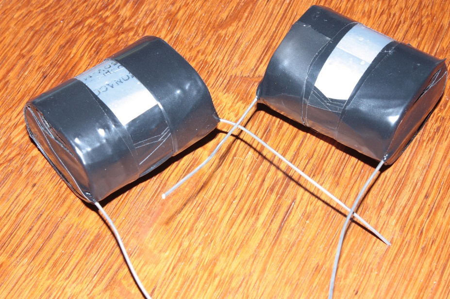

What about tinfoil/polyprop capacitors. They don't seem to popular, but I use the all the time when I need some "reassuring" quality output capacitors. I guess its the weight that makes these attractive. I have never seen tinfoil capacitors being offered by the large resellers. I think only SCR produces them for audio related rebranders. Is there a specific (historical?) use for tinfoil capacitors? Does Tinfoil have properties that challenge metallized foils or the usual metal foil (aluminium)? Or am I being fooled...
