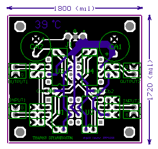

optimized layout,almost done:cool: the PCB board size is as same as my series design - 3886igc,regulator and BLDdriver.

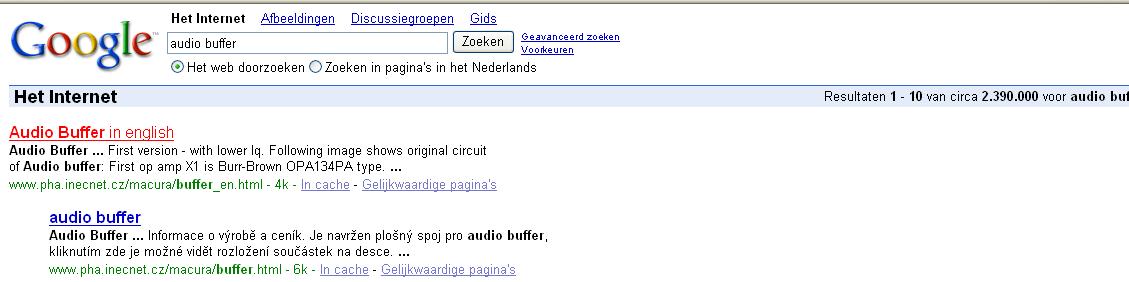

I was not trying to make a point really. Other than that if I type in audio buffer into google..PMA's circuit is the first one I find.

I don't know how good or bad it is really but I would have placed the buffer after the opamp, not beside it. I would also have a whole groundplane... because I like it.
May I ask why you haven't chosen the TO220 version of BUF634, takes up less space and is more current capable. If you for some reason want to use the DIL08 version, why don't you add option for TO220?
I would also recommend that you have decoupling caps from supply to ground and not as you have now. Current is taken from supply to ground since the load is connected to ground.
I think you also should add option for a input LP filter. This is wise to have. You don't have to use but it's good to have it there if you must filter the input signal. Suitable frequency is 50-200 kHz.
Input coupling cap isn't so bad either to have room for. I think Upupa's solution (which is more or less identical to my QRV_04 amp) is a good start. If you feel that some parts are unnecessary, just omit them. Costs nothing and in your case space isn't an issue, or is it?
Hmm I was looking for a way to print the entire thing at one time. To print I had to cut out each image and resize them myself. Has anyone tried these layouts yet or am I the first :) Judging from the resistor spacing it looks to be 1/8w, guess the original parts list has changed.
Adam
Hi astouffer,Thank you for your interest in my designs.
this project is still in progress,I will post the print version tonight:) the source file is in my notebook computer.
P.S.I am on holiday now,hardly surf the NET.please contact me via e-mail.
Judging from the resistor spacing it looks to be 1/8w.
Yes,the resistors are 1/8W (vertical mounting) or use 0805 SMD resistors.
