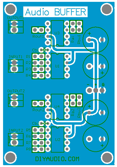

audio buffer layout

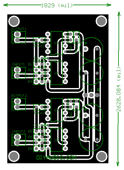

here is my lately work.opa637 pre amp.the unit has gain(setting in 8).
pic1,

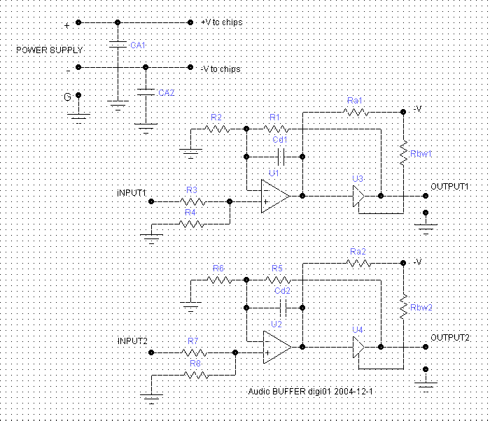

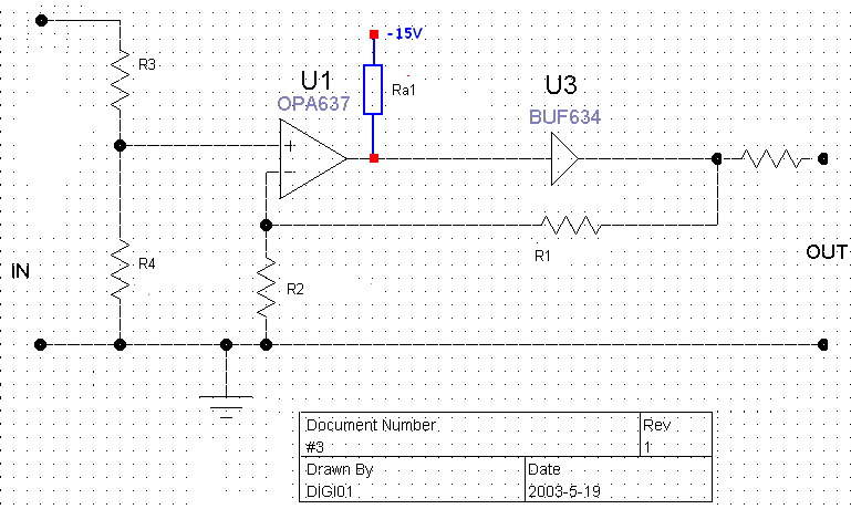

Anybody have a schemactic of such Sound Refiner ?
What Upupa Epops explain, it can be called better an active signal cable.
What is the idea of such a design?
How much refined can my audio signals get, if I try building / using
this interesting device?
How do we measure? .. distortion, noise or what?
Regards
