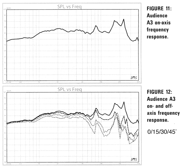

nasty 8.2khz spike there..................

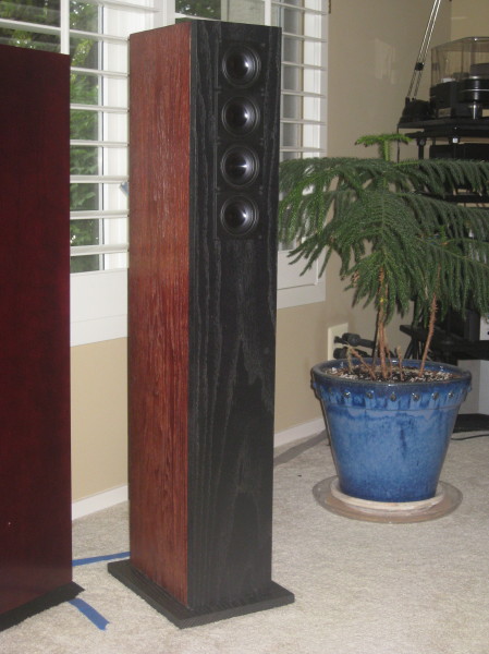

Finally fnished my mini-array of 4 Audience A3s drivers per side in a floorstander. I've now built and spent listening time with 4 iterations of these drivers, from a single driver mini-monitor all the way up to their current iteration.
Each added driver enhanced the sound and made for a better listening experience, these A3 drivers are simply addicting. I always figured I would get to an array of 4 per side as time and funds allowed and I finally made it. My only change was at the last minute when buying materials, I opted for a tower instead of a largish monitor cabinet.

Internal Volume?
Nice! Did you block off part of the tower to reduce the cabinet's volume? What did you end up with in total liters?
They are indeed addicting. I'm now sometimes using both my A3 cabinets and my mains at the same time by having the A & B switches turned on at the same time. I do this when listening to music at day's end.
Internal cabinet volume for the 4 drivers is 10L sealed. I have the cabinet sectioned off into upper and lower chambers in case I wish to add a woofer in the future. For now I'll use that to mass load the cabinets and leave low base up to the subwoofer.
Only thing left to do at this point is fine tune the amount of cabinet stuffing material.

I noticed that one of the articles linked mentioned a rising response on the a3 driver. That plus baffle step would help offset combing.

Hi guys! Just found this thread yesterday.
I've got a pair of these to play with several weeks ago.
My measurements coinsided with Vance's and manufacturer's specs (both T/S and FR) pretty closely - I'm impressed. BTW, Fs is around 70Hz, not 140 as somebody here said. If you mount mine into .85l box, you will get 130 Hz resonance wuth Q=.7.
First I put them in 3.2 l closed boxes (used the same for Zap's HiVi 3b). First day was horrible, by the end of the week they started to play music. Then I ported them and tuned to 65 Hz. I'm runing singe driver per side. The base is pretty impressive, the mid and highs are OK. Something definitelly has to be done about the peak around 7-8kHz. The one on the very top is OK with me, just stay a bit off axis. It actually helps with power response, I think.
I have a pair of HiVi 3B, similar to Zap's, but with a little less baffle compensation. I'd say they are pretty comparable if you match the volumes, but I stil have not run them exactly side-by-side. I'll do that soon. I also have a pair of TangBand TB-1231SH in small MLTLs of my own design. TBs don't have the 8 kHz peak and assosiated shout on female voices and are generally smoother. However, they also are less involving to listen to and low end is significantly weaker.
As for subwoofers, I dont think it's as much important if they are a closed box or open baffle. What is important is the Q-factor. Tune your closed box to Q=.5 (may result in BIG box) and it will be very easy to integrate with these little things. Put a woofer with the Q=1.0 in an open baffle and integration will be a problem.
My solution - I use the Linkwitz transform and can change the Q on the fly to my liking.
