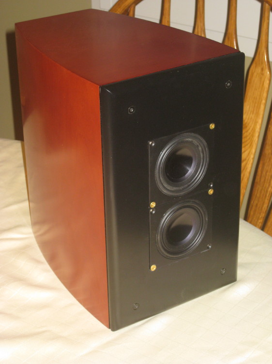

I got the other speaker done last night as well.
You'll notice the gold colored screws, which are just temporary until I permanently mount them. Also internal wiring was whatever I had around, Radio Shack 18 gauge I believe, and just secured over the terminals and not soldered. No filters of any kind at this point and only a hand full of damping material. All this just to say its a temporary set up...I wanted to listen
I did have a single driver in the cabinet at one point and played some music via i-pod and a Sony receiver in mono. I always do this to make sure when I put things in my primary system nothing starts to smoke. This sound was uninspiring at the kitchen table and I started to second guess myself. Useful as a desktop computer monitor I thought, but I want high end monitor type performance.
With the second driver installed things got better, vocals had real energy and presence now. Vertical dispersion is pretty narrow, the highs drop off quickly with your ears above or below listening axis. Still Sony receiver and i-pod in mono at this point.

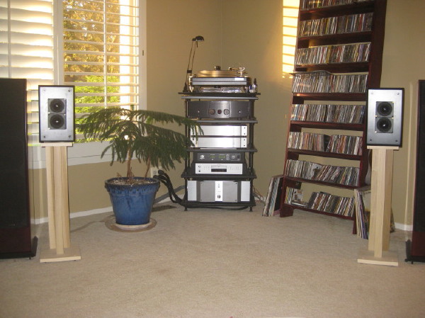

Finished up the second speaker real late, tested it out and moved both into my main system (Pass Labs / Balanced Audio / VPI Scoutmaster front end).
As expected things got much better here. I only got to play a single side of an LP (Ray Lamontagne Turn in Black) at low levels but it sounded promising.
Better high frequencies, broader soundstage and more inner detail than my single CSS FR125s.
I'll post more later tonight once I have a chance to listen more, and at a more reasonable volume.

Please note my comments above are in haste and eagerness to listen and under less than ideal situations...at a kitchen table and then placed on top of ~40" tall floorstanders. Hope that helps put my comments about off axis high frequency drop in a better context.
Later tonight I'll bring out my stands and place them in a much more appropriate listening position for further evaluation.

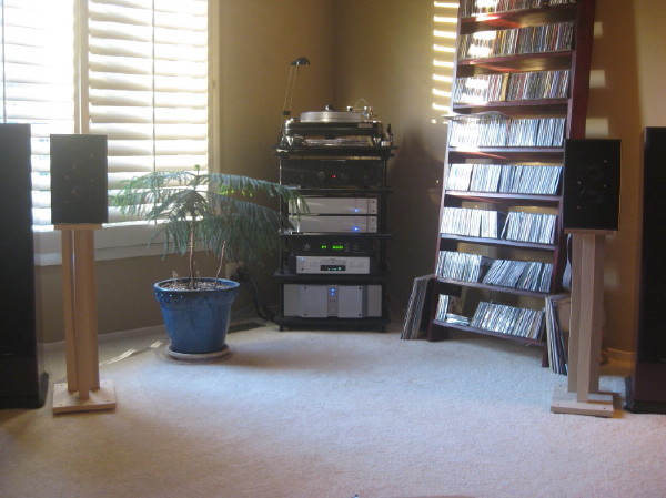

Ok, more listening comments with about 3-4 hours on the drivers.
High frequencies: Clean and clear. Symbols lack a touch of sparkle and shimmer compared to a true tweeter but otherwise very good. Verified with test disc.
Mid range: Plenty of energy here with good vocal presence and realism. Very clean here too, they can dig up low level details in the music. These drivers pretty much nail vocals and acoustic guitar. Play Andy McKee's Art of Motion (solo acoustic guitar instrumental) and prepare to impress yourself and your listening buddies. Likewise on vocals and acoustic arrangements with Ray Lamontagne Till the Sun Turns Black.
Bass: Useable output down to about 70 Hz in my room and where I placed them (see image). Roll off starts after 70 and drops off after about 60. Verified with test disc. I may dust off my subwoofer and experiment more tomorrow here.
Placed on proper stands and reasonably placed they produce a generous soundstage and nice sweet spot in the listening chair.
I see Audience recommends and shows their speakers with moderate toe in. I first started with them firing straight at my ears (images show this set up). After a few experimental placements I angled them in even more with the speaker axis now crossed in front of my listening position. This created good stage depth with a slight trade off in width.
Currently playing Mark Knopfler while I type this from the office which is across the hall from the music room and things still sound pretty good. Always nice when this happens.
In many ways, within their limits, they are better than my more expensive towers. Overall I am digging these little drivers. I want more of what I am hearing and I think 4 of these per cabinet would be great. And that is where I am torn, because of their price.

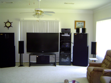

This evening I worked in the subwoofer with the dual driver A3 monitors. I also moved my main floorstanding speakers out of the way for better placement of the A3 monitors as I think these will be in the system a while longer.
It takes more than one evening to dial in a subwoofer (at least for me) but crossing over to the A3 monitors is showing some good and some bad signs.
To the good, their sound seems even more open and free from the speaker with no obvious colorations. To the bad, the subwoofer bass is pathetically slow and not well defined compared to what the A3s put out. I can see this being a lingering issue if I stick with the sub.
Overall, I am even more impressed today than I was yesterday with these drivers and the sound they can produce.
D_Dubya,
I'm glad to hear they sound good to you but am a bit puzzled about the sub integration?
I'm curious about what kind of subwoofer you are using.
My subs are very large and stacked. (235 lbs. ea.) I'm pushing them with twin 1450 QSC amps, have 4-15" Soundsplinter RLP15 drivers, and 8-2100 gram 15" flat passive radiators. They are very smooth. They blend in with all of my music and the movies I watch.
