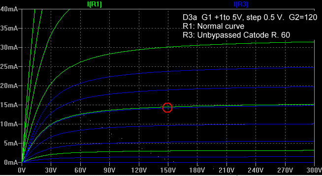

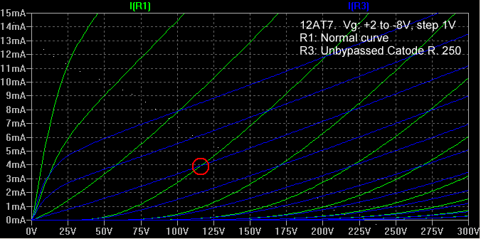

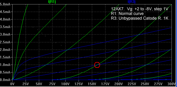

Is it possible to draw characteristics in SPICE to show how the D3A and 12AX7 (or any pentode and triode) curves would change with cathode degeneration? I think that would be useful for some that are struggling with the idea.
Here is my attempt to trace curves in LTSpice with and without cathode bypass for 12AX7 and 12AT7.
Tube models are Koren_tubes.inc
SveinB
Hey Svein,
This verifies what I said in my post #25, that a triodes characteristics goes towards pentode when current feedbacked. Must do the same sim with some different triodes tonight. Still there is no chance to get the characteristics of a good pentode like D3a.
The best I have found so far, when simming a complete 6L6 Schade-amp, is the triode-section of 6F12P. But this is with a large cathode resistor, 1k, and an added CCS in the cathode circuit to make it draw 15-20mA. Gain suffers though.
Here is a D3a with and without cathode bypass.
Depending on the load, fully bypassed Rk might actually be too much degeneration. Bypassing only half of Rk might be sufficient for good linearity, and a bit more gain.
When we remove all unlinearity of the driver, we get no distrortion-cancellation between driver and output tube, and the total THD of the amp will probably increase.
Svein.

Svein,
When simming D3a/Schade best results are achieved with a fully unbypassed cathode resistor. 47ohm for 20mA. Testing with bigger resistors and a cathode-circuit CCS results in, as you say, worse results. The opposite is for the same circuit with a E88CC cascode at 15mA 2*90V.
Off course you must use a gyrator instead of anoderesistor for optimum results.
About triodes, sims are dissappointing due to high levels of even-order harmonics.

Svein, that's a great illustration of how the curves simply change slope with a triode, which shows an increase in plate resistance. With a pentode it mostly just changes the spacing (gm).
If you work out some designs using practical circuit values you will find for the most part that any input pentode over about 5000 gm will result in too much input sensitivity without some degeneration (unless you're building a guitar amp...) The design trick is to get the right sensitivity and input tube idle point where you want it by tweaking the feedback resistor, the cathode resistor, input tupe op point, and parallel plate load (resistor or CCS) on the input tube.

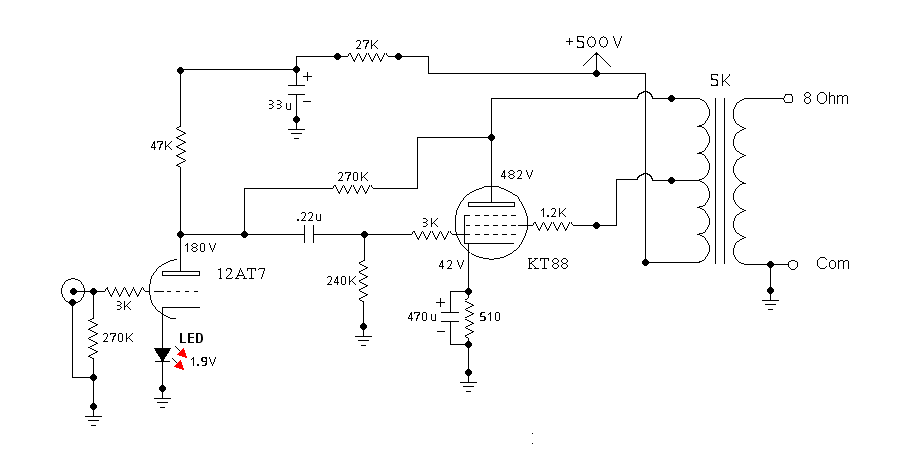

OK. SpreadSpectrum, if I am understanding you correctly you are saying the the Schade feedback makes the input impedance to the output tube effectively very low and this low impedance (steep AC load line) causes the pentode driver to have a better distortion picture than it would with a more normal (higher) resistive load. Is that right? It also appears that the DC load line is much less critical than normal.
He is saying that pentode loaded on low resistance is more linear than triode.
With all that in mind would it be reasonable to use say a pentode LTP phase splitter with plate to plate feedback for each output tube to its respective driver's plate and just set the bias and load resistors for reasonable DC conditions? It would also seem that the PI load resistors might not need to be as carefully balanced as usual either since the AC load will presumably be much lower than the plate resistors anyway.
It is what I did an year ago in Pyramid VII. But plate resistors define feedback ratio, so they must be as strict as feedback resistors.
If one wanted to use cathodyne I suppose that just inserting a CC driver between the PI an output tubes should work just as well.
Finally what do you think of tubecad's idea of using the path trough the feedback resistor to supply plate current for the driver rather than having the normal plate load resistor to supply current to the driver?
In my Pyramid- VII amp 17K load resistors are fed by regulated +400V, while 240K feedback resistors are connected to GU-50 anodes with 800V. That means, both +400 and +800V supply currents to LTP driver.
Why it is Tubecad's idea, I can't understand.
Actually, many Tubecad's ideas were expressed and even published many times before, by other people.
There were few pages in WW magazine where they published "Circuit Ideas"; they honestly printed where that ideas come from. But I don't remember somebody calling them just "Wireless World Ideas".

Keeping with something Tubelab mentioned, I to have built SE amps using shade
style feedback with a triode driver and UL connected pentode, they can not only
perform quite well in the spec department but sound very nice as well.
I am not going to begin to say a pentode driver is not a better device to get the
the most effective feedback out of this design, but having built these amps with
a triode driver an pentode ran in UL I have found most amps do not "need" much
additional feedback beyond the UL connection that a triode driver can work well.
12AT7 or an 6AQ8/ECC85 have done extremely well in this config, we have tried
a few other "cleaner" drivers and gotten more distortion out of the final amp, so
it goes to show that some specs don't tell the whole story, and there is some of
complimentary distortion cancellation that can happen there as well.
When yu can get 10watts out of a single ended KT88 amp with a triode driver at
less then 3% distortion I would consider that an pretty darn good performing amp.

driver to perform rather well when the whole/final design is taken into account here.
Not suggesting one should only build UL style amps, just saying the circuit does work.
(I use UL, Pentode, Triode, whatever I feel the piece/circuit works with)
But this Triode driven UL connected pentode output with shade style feedback I like.
It's nothing special, an the latest amp is still on the bench, when finalized can post.
But basically it's the attached schematic, values "tweaked" here and there, roughly
440v plate to cathode and 82ma on the output with 5.5ma and 180v on the drivers
with a relatively small amount of "schade" feedback using that 270k resistor.
Makes a fairly simple circuit that I think works pretty well.. (about 1v sensitivity)

Since it is still on the bench, have you been able to form an opinion of the sonic results of the different feedback arrangements, esp. the effect of the rather modest anode-grid feedback.
Svein.
I've been running this same basic circuit arrangement on various pentode output
tubes, an only 1 so far did not sound as good or better with the mini anode-grid
feedback scheme in place and that was an EL500 for whatever reason.
I misquoted I believe as well earlier on the output and distortion on the KT88, it
was I believe 10w at 3% not at less then 3%, with clipping and 5% at 12.5 watt.

I'm a little surprised that 12AT7 can drive KT88 to full output
swing with two kinds of strong local NFB wrapped round that
output? Would have one grid or the other too easily tip-over
into forward conduction before full output could happen?
No proof to back up that statement, just a gut feeling....
