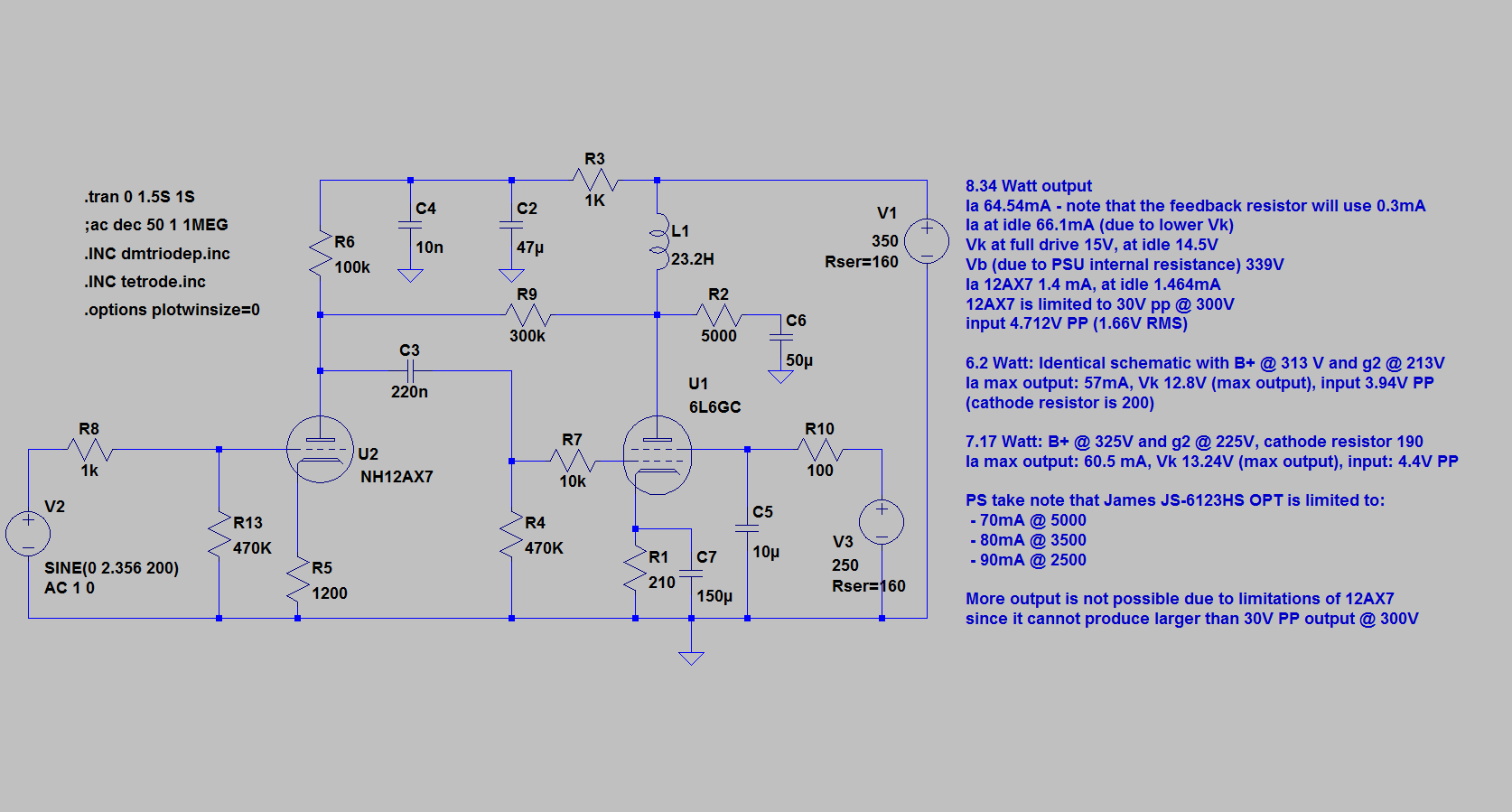

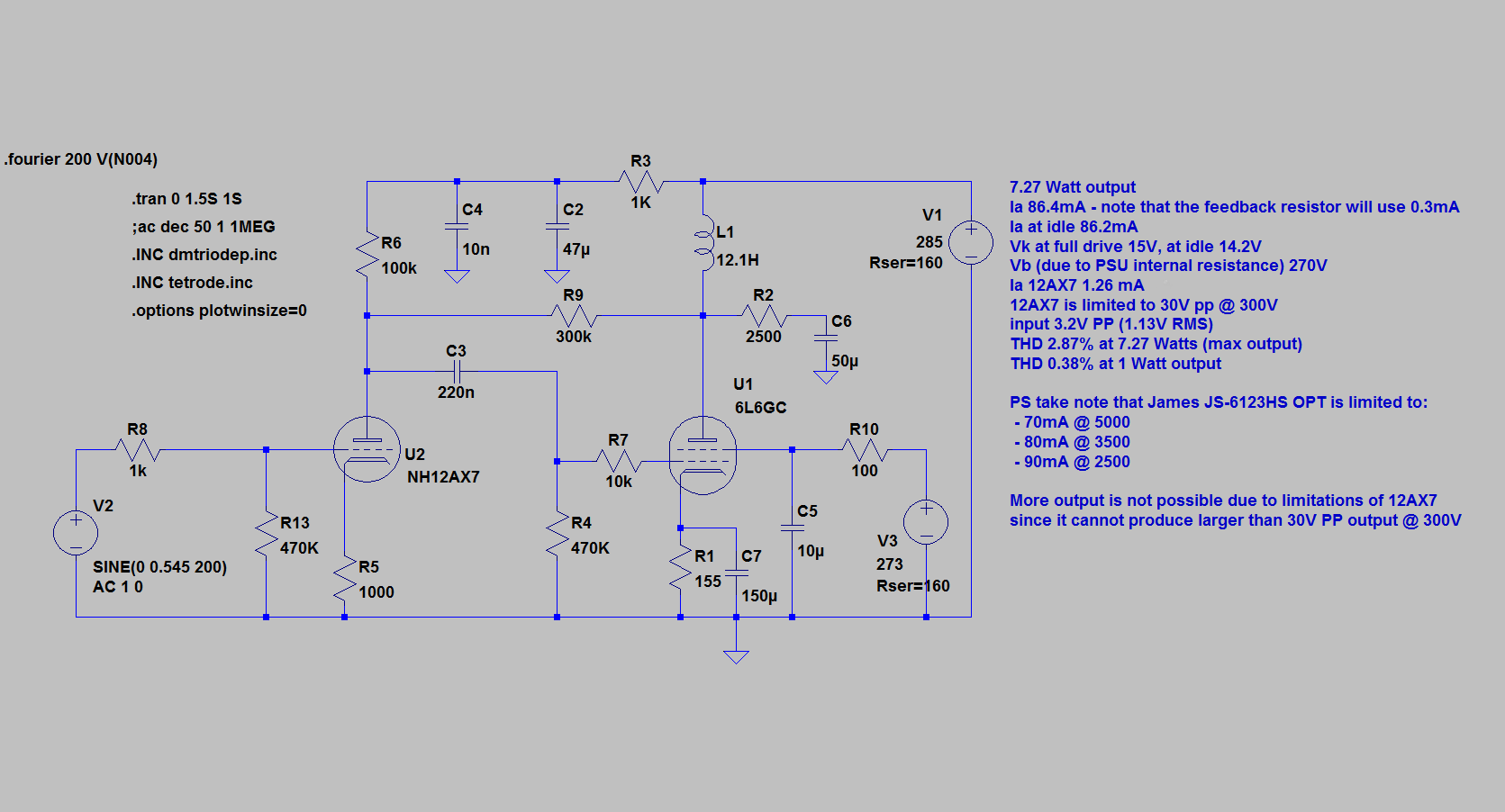

During the past week I've been learning LtSpice and modelling the different options for my 6L6GC SE amplifier. The power supply is not yet on paper but I'll be using a CCS feeding a OA2 and OB2 gas voltage regulator (more stable and less noise than zeners and the heat is above chassis) and use that voltage reference through a 10 turn put to "fine tune" the screen voltage. (The pot will be feeding a high voltage mosfet which will be acting for the current supplier to the screen)
I've mentioned elsewhere the existence of a self adjusting voltage regulator (with a mosfet too) so I am not tied to using a fixed B+ voltage. (Basically it becomes an electronic choke)
I did search long and hard for some decent 6l6GC SE amps but they are thin on the ground. In the end I found Alex Kitic's RH807 but I did not like the screen voltage dropping resistor which goes against recommendations made by KenRad for longevity of the tube. Some others remarked that the 12AT7 was not the best choice so in the end I wanted to find out what was true and what was old wifes tales.
I am attaching two sets of schematics - I am imposing a 30V pp limit on the 12AX7 output voltage swing since above that level distortion increases a lot (just my personal view on the matter, others are welcome to their views.)
The 12AX7 turned out to have a lower noisefloor (depending on design between 5 and 10 dB) than the 12AT7 plus the THD for the 12AX7 was about half to two thirds of the 12AT7. Confirmed that the 12AX7 is the lower distortion tube. There is also some interaction between the feedback resistor value and optimum performance. Came up with two OPT configurations: one for 2500 Ohm and the other for 5000 Ohm. The latter is the most flexible and can be adapted to different voltages with decent performance yet the 2500 did not exhibit that same flexibility. I ran out of time trying to find a 2500 solution with other voltages. It yielded the lowest distortion though.....
All transformers are James that I obtained directly from Taiwan.
I ran out of time to model properly an OPT so I made a "simulated" fix by using a choke and a resistor. Since it is not a part of the feedback loop I can see no issue with this. (having seen it elsewhere)

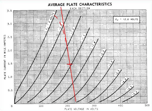

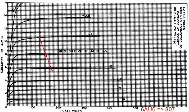

Schade driver loadlines
I think the notion that triode drivers are unsuitable for this service is a gross oversimplification of the question.
How about looking at some idealized loadlines for the driver with low effective load resistance of the feedback network (assuming current mode feedback)?
This will illustrate the issue some have with using a triode.

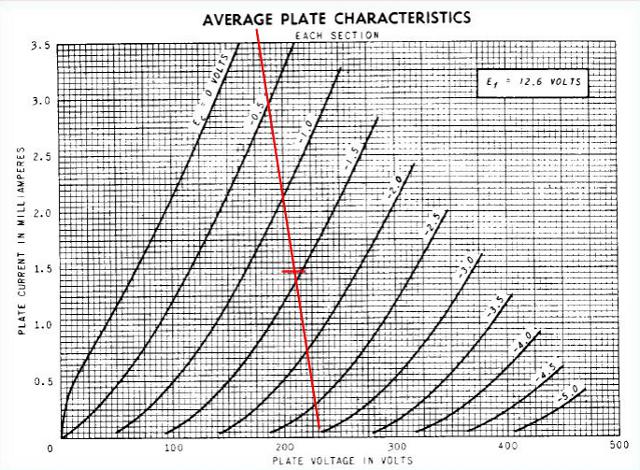

First slide is the 12AX7 in your circuit. You can see why the swing is limited to 30V P-P but actually it doesn't look too nonlinear up to about 50% FS. This is what you get, pretty much. Not shown is how the effective load resistance decreases as the gm of the 6L6 decreases, which actually curves the load line flatter at lower (toward the left) plate voltages. Using an unbypassed cathode resistor further linearizes the V-I curve and increases the plate resistance, making it a better V-I converter.

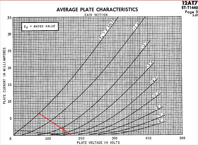

next is a 12AT7 and you can see why this one is unlikely to work well due to linearity and interaction of it's own low plate resistance with the V-I function.

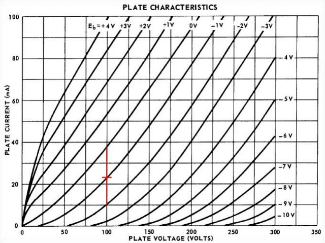

Third is a pentode, showing why this is a better voltage-to-current converter because of the flat plate current lines. As the effective load resistance changes through the gm curve of the output tube, the output current remains a more linear function of the pentode grid voltage.
Last, an illustration of why it's not always evil for triodes to work into low load resistance. This is a 6922 as the bottom device in a cascode.
To me it looks like some triodes are suitable in this position and AM's measurements seem to indicate satisfactory performance.
Here's an illustration of the effect of the output tube gm curve on the driver load line. As the driver plate voltage decreases, it has to swing more voltage (dotted red line) to the output tube grid to maintain the output tube plate swing. This is the Schade current mode feedback at work.

Thanks for the diagrams - they illustrate at least two points: 1 some but not all triodes can be used effectively in this topology and 2 pentodes have an inbuilt design characteristic that makes them a more likely candidate for this topology.
The curves also gave me a better insight into what is actually going on....
Best of luck to AM in the move. I detest moving. It is too bad that there are apparently no small signal pentodes in current production but I suppose the 6AU6 is plentiful enough for many years. Of course then one is working with two itty-bitty sockets instead of one simply tiny socket.
Hmm, I wonder about 6AU6 LTP PI with Schade for PP.
