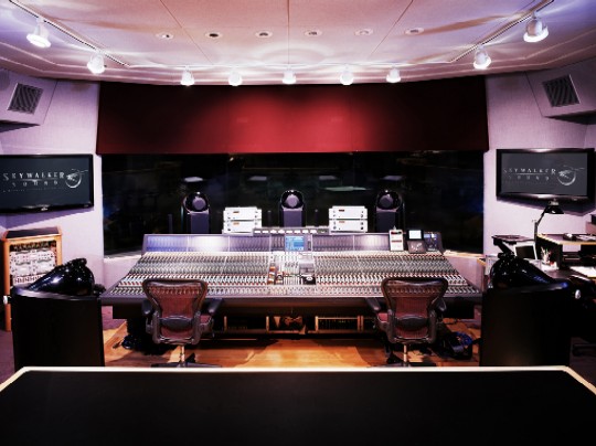

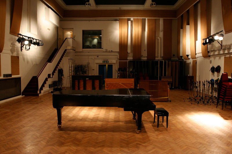

Here's two examples. The first is Studio 2 at Abbey Road Studios. The second is a mastering suite at Skywalker.
What you want is a balance between too live and too dead. This is achieved with moveable panels, careful microphone placement and room selection. Sometimes you want a live room, sometimes you want a dead room. There is no perfect environment for recording or playback.

And as a side note, there is nothing impressive about Abbey roads from a technical point of view. A lot has changed since then. Abby is famous, but not for the sound quality, only because of the Beatles.
From a subjective point of view, the recordings from Abbey are absolutely terrible. They lack any proper LF response and the implied stereo separation is enough to make you cry.
Oddly enough an old Beatles record can benefit from some echo to create stereo, as they were not recorded in stereo, rather mono and inserted into right and left tracks.

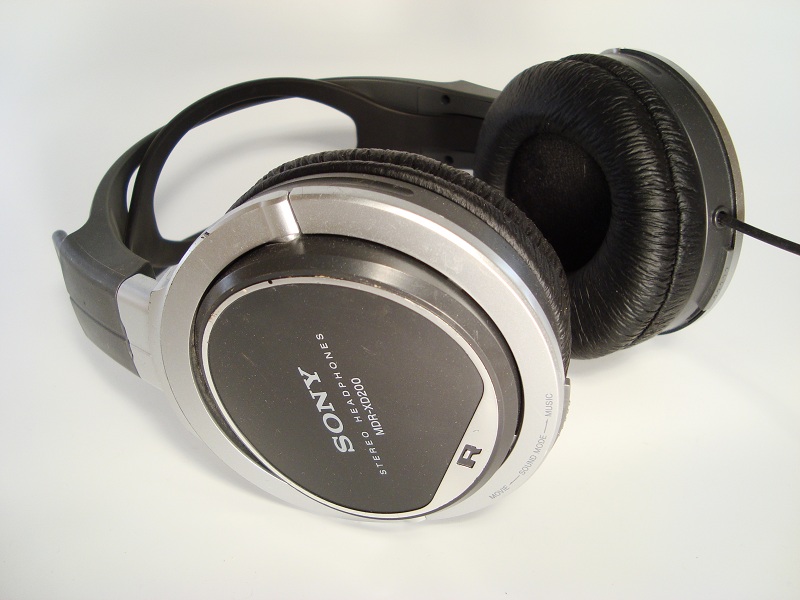

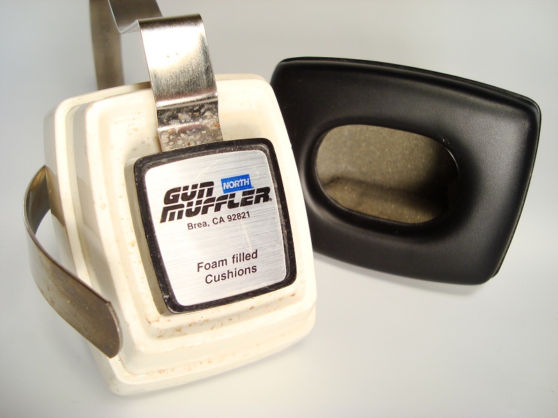

Here's how I go about it.
If you notice the hearing protection in the first photo basically consists of a sealed cup and roughly 1/2" of open-celled foam.
So I just apply this technique regular cans by dampening the rear outer chamber wall in a similar fashion to the safety muffs.
Now, when you first put on "hearing protection", it does seem different at first, but you get used to it very fast.
I myself am too the point where I am not comfortable using tools without hearing protection, you will easily adapt to the comfort of silence.
Even a lowly pair of modified Sony MDR-XD200 will reproduce high fidelity much easier then a "treated" room.
