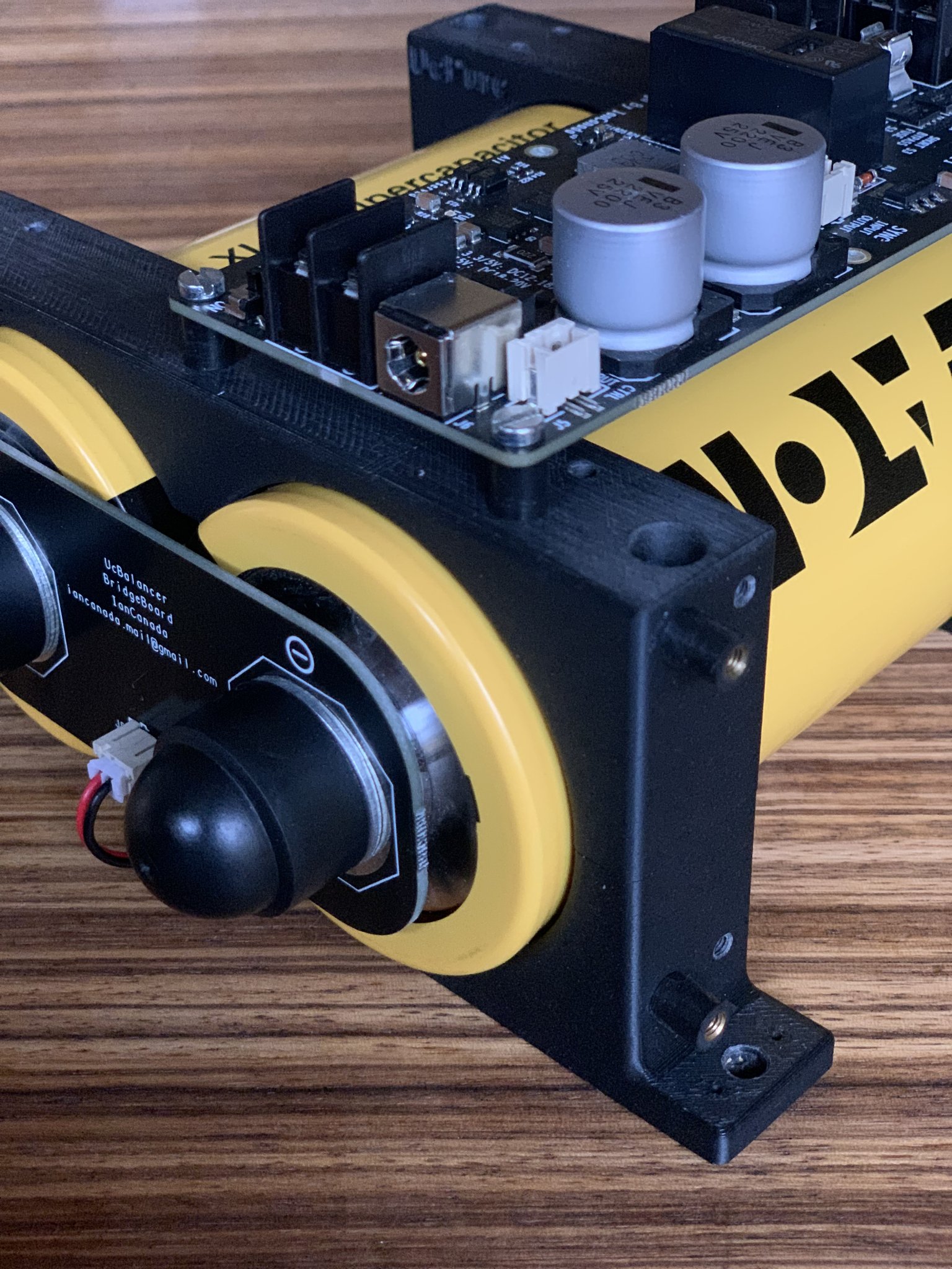

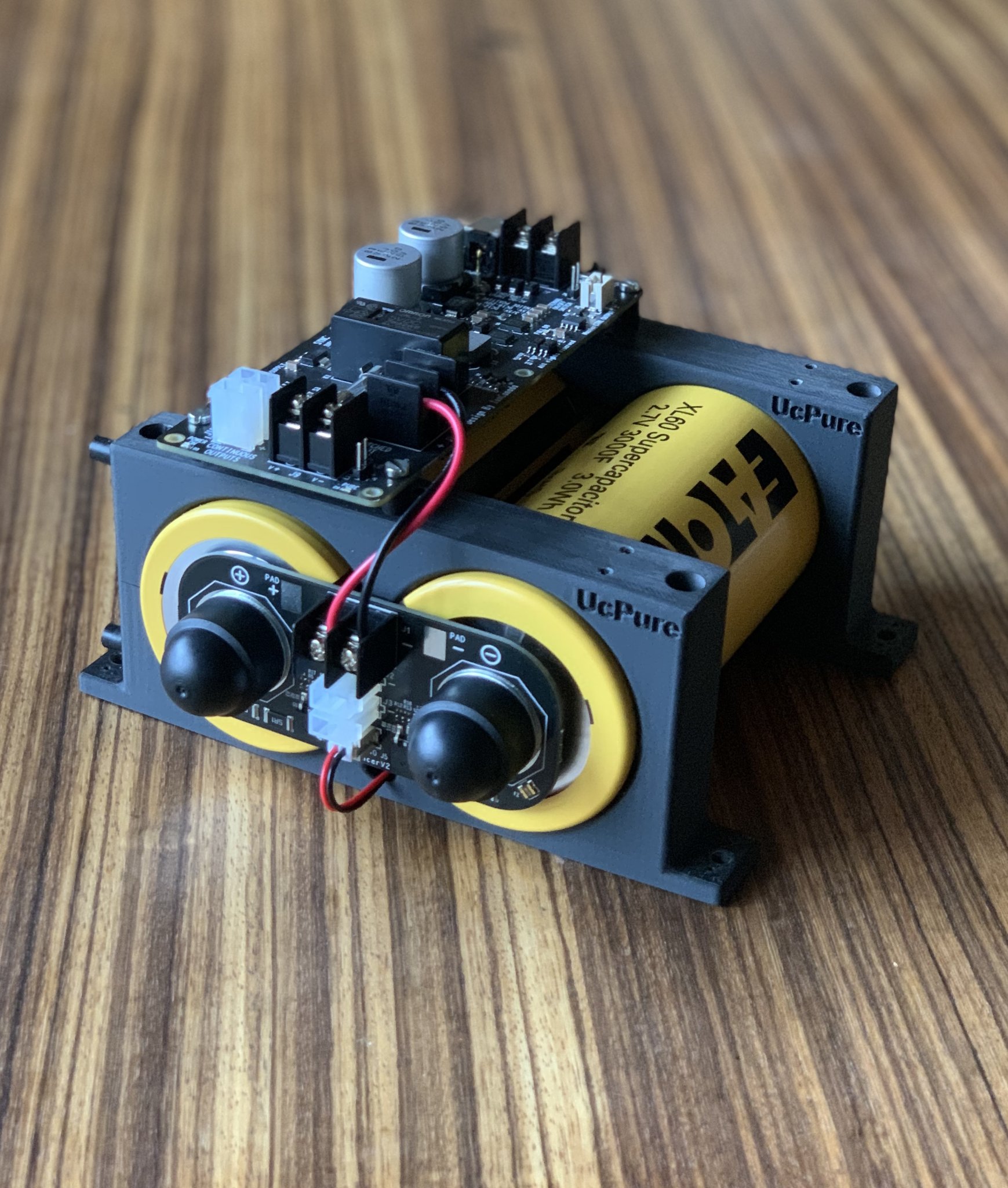

Finished version 1.2 of the UcPure holder. Small changes with a bigger base, larger flanges and holes for the wire to the balanced board were made. Not all was really necessary, so and updated and slightly narrowed V1.3 is in the making.
I am using some small M3 vibrating dampers under the PCB. M3 Dampers
They are actually really great and much softer than expected providing some movement and hopefully absorbs some vibration. Does it matter to improve SQ? Don’t know🙂
Still a great fit with 4 pieces for the UcPure.
I’ll expect to use them under my StationPi as well.

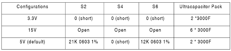

Hi
I have the UcPureMkIII ultracapacitor power supply, UcBalancer protection board KIT and two Eaton XL60-3R0308T-R (3.0v) in the mail that is going to power the FifoPi Q7II.
The way I understand it, the UcBalancer should be 2.7v default mode, and the UcPureMkIII in 3.3v mode by shorting s2,s4 and s6 on the back of the PCB with solder balls.
The manual says jumper settings. but can't see any jumpers in any of the pictures I've seen?
is this correct
Regards Roy
is this correct
Regards Roy
@RoyA, well, these are solderable "jumpers". For 3,3V you solder off the S2 21K and S6 12K resistors from the first (bottom) side of the UcPureMkIII board and replace them with either a solder ball or 0 Ohm resistors. Yes, the term "jumper" may be easily misleading here.

The 3v setting is for 15v power suppliesHi
UcBalancer manual says.... Please note, for 3.3V and 5V applications, I don’t suggest using the 3V configuration even you have 3V ultracapacitors.
can someone explain why 2.7V default mode is recommended even you have 3V ultracapacitors
for 3.3v and 5v ultra capacitor power packs 2.7v is the right setting for UcBalancer.
When you are making up a 15v ultra capacitor power packs you need to have the UcBalancers set to 3V
