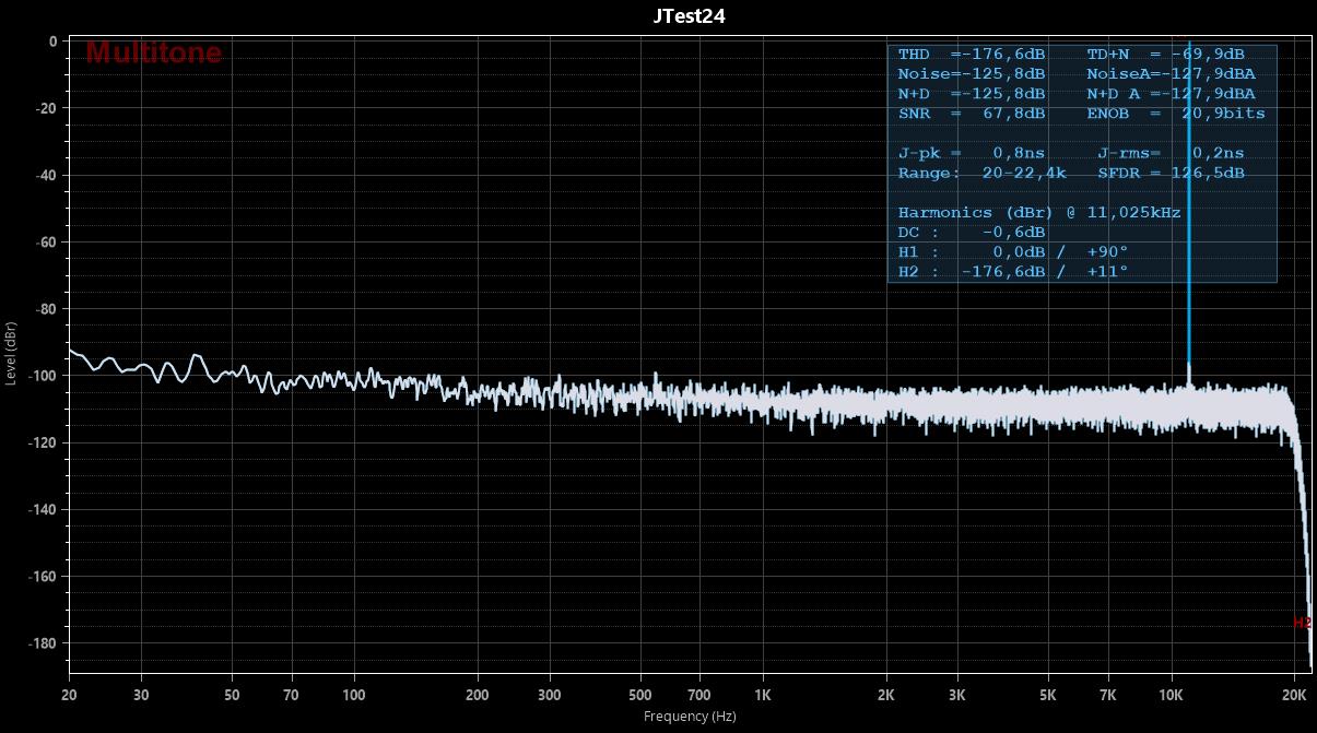

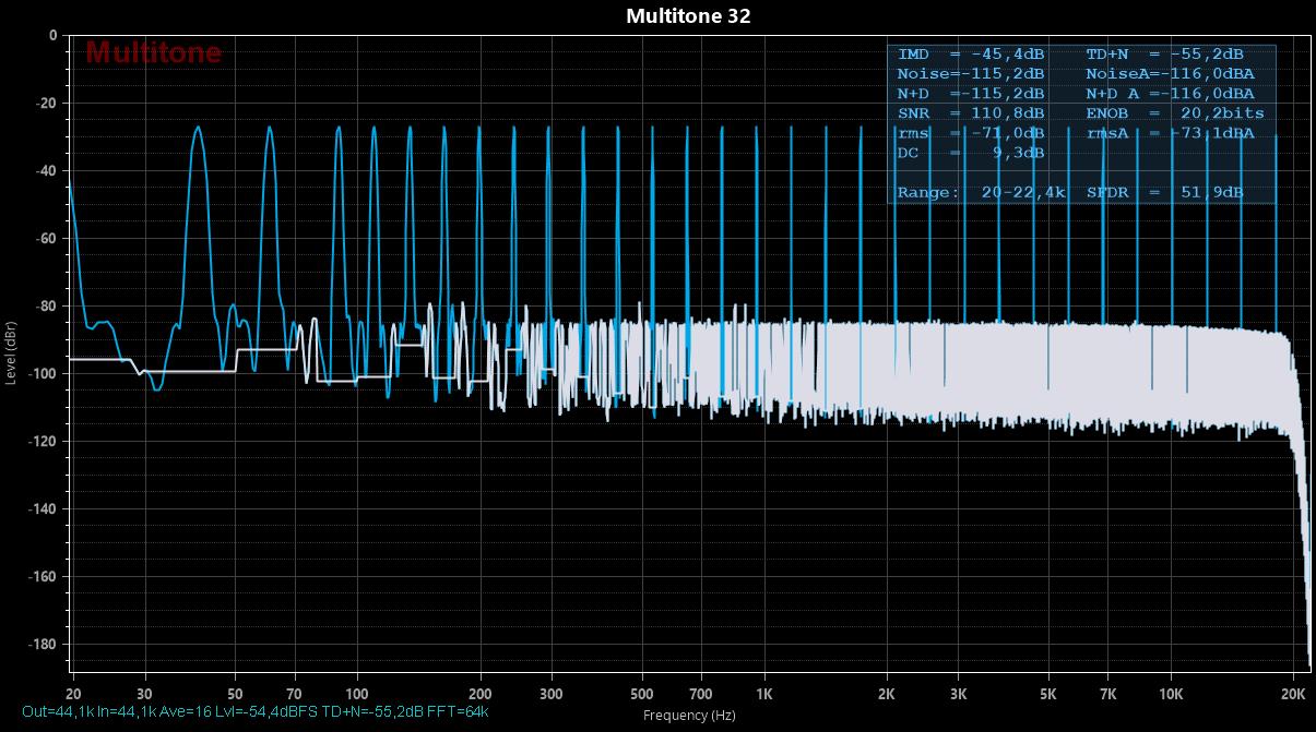

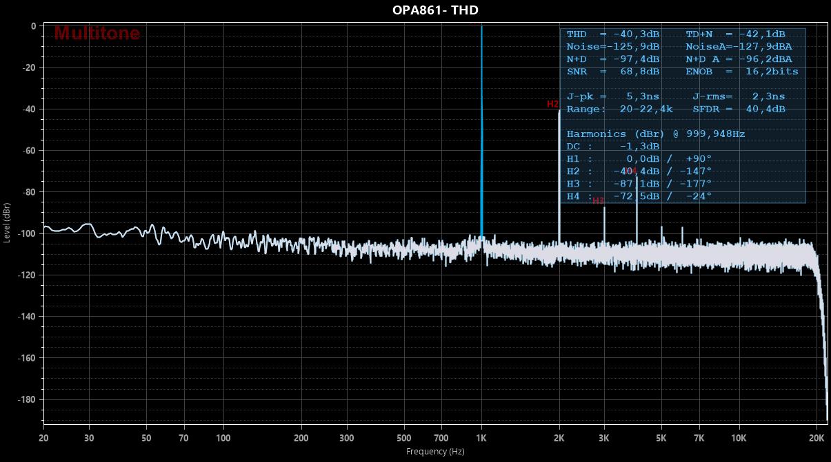

I’m using multitone software for measurement and my other DAC SMSL DO300 measure in the same setup, approx as the specified by the manufacture. So i think it’s a problem with OPA861, could be some wrong parts on the board, i don’t think the Anamero could generate that amount of H2 and yes it’s worse than a tube amplifier.What are you using for input? Have you tried different input usb devices with different software? It's probably something regarding your input format / driver / software and possible the ammenero make sure it's flashed with newest software
Kind regards Lars

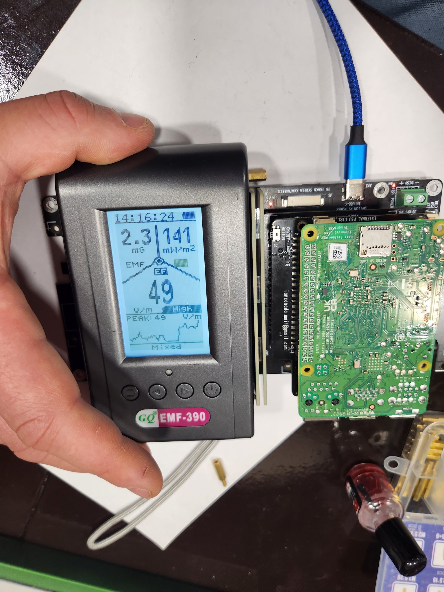

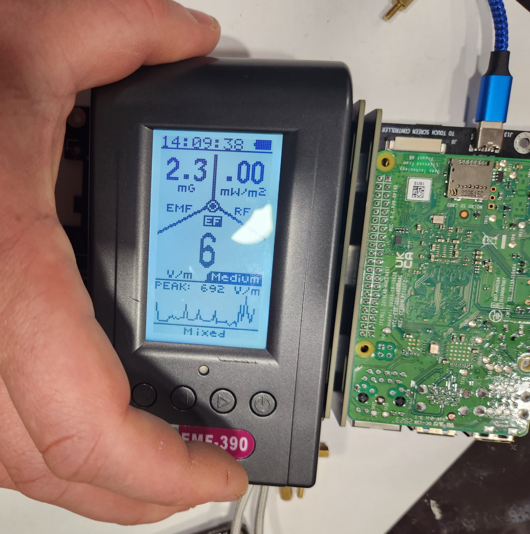

No my grounding was self thought up, hasn't posted here my entire build as it's not done yet. We are talking multiple layer enclosure of mdf, pure copper plates, sorbothane more copper plates and the entire thing housed in a pure custom cut grainte enclosure. Everything to ground. Individual boards in copper enclosurers that'd are also grounded.
I have a lot of Ian gear. A lot. I use a large toroidy tordial I had custom made too, their supereme audio version.
I power everything from a ps audio powerplant as well. Isolation and grounding are incredibly important, as is power quality.
One would think the shieldpi pro II would help but here it hurts. Station pro here running off battery pack for testing. The noise level is less without the shieldpi pro II. The rf fluctuates but here it was 0 without the shieldpi pro II. It would go as high as 100 at times but generally was less without it, than with it.
When powered by wall cheap phone ac to dc 5v converter you get an Ef of 500-600 on the Emi meter.
I measure the effect of all my grounding and noise this way. I also wrap all cables with skived ptfe and then a copper foil layer and then another layer of ptfe and the copper is connected to ground as well. This also makes a big and measure difference.
