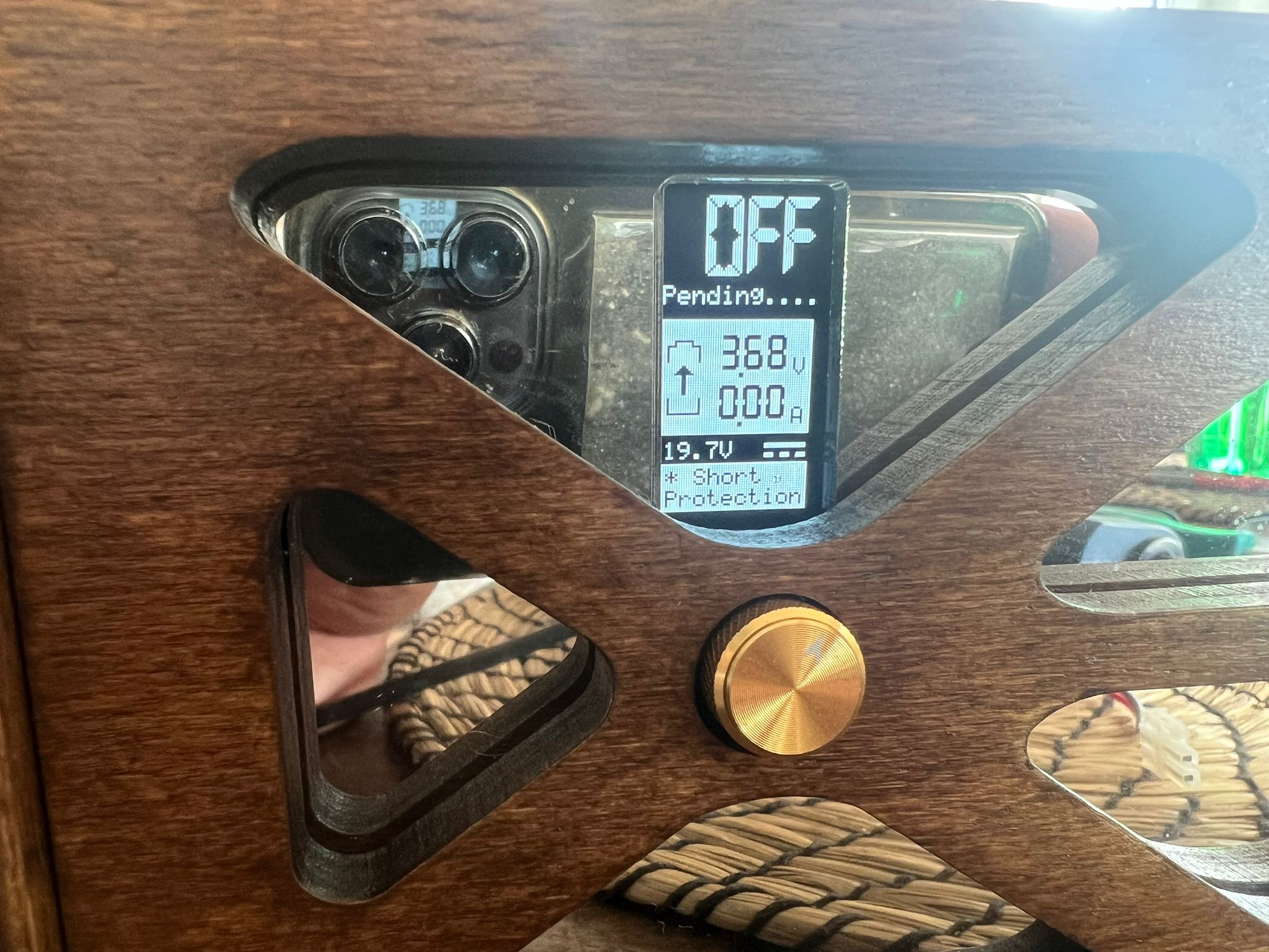

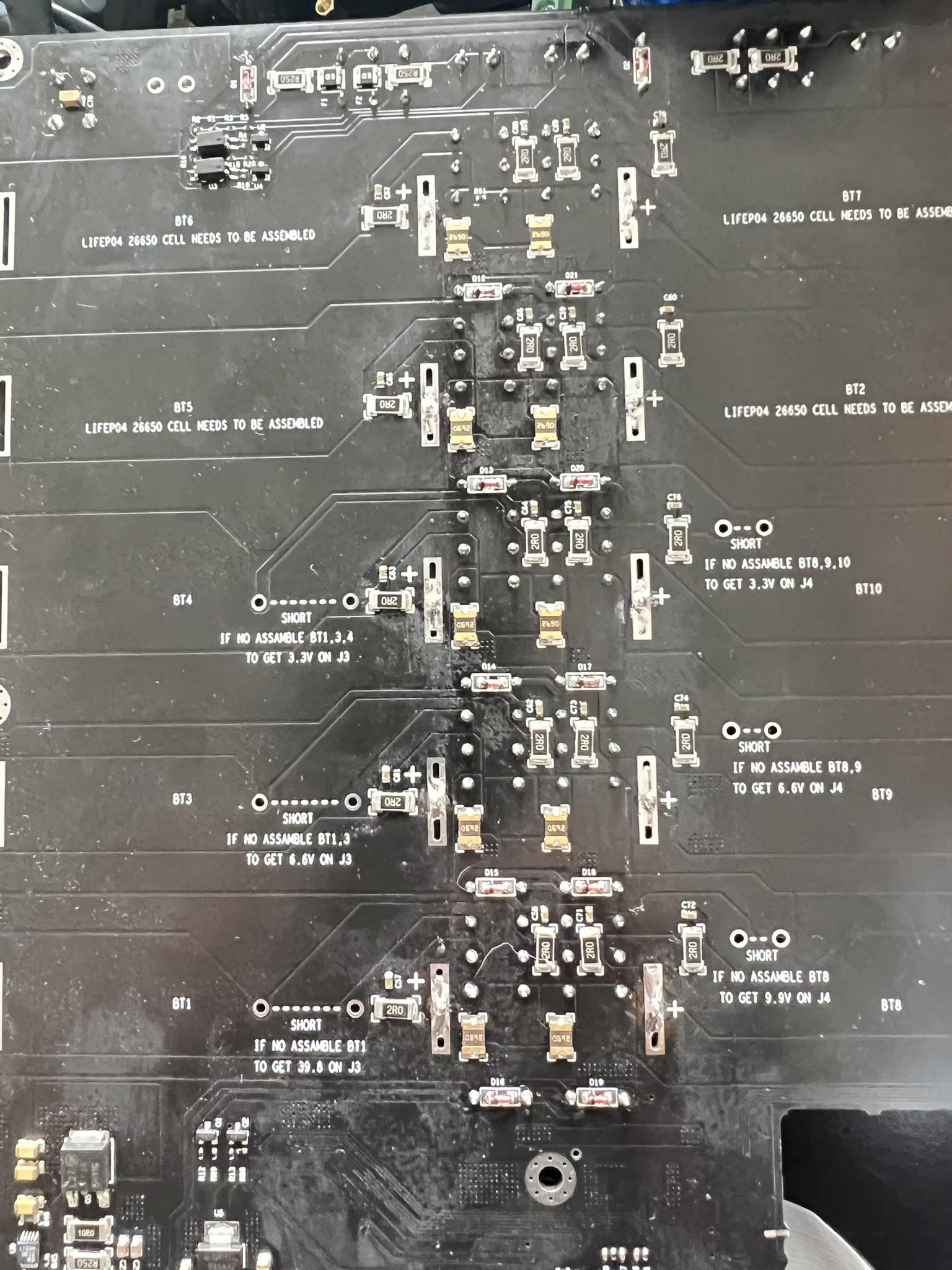

hello; i have massive problems with the LIFEPO4 MKIII Batteries Power Supply
..the pdf is incomplete was only added from the first version, and only improved...where to solder bridges; is no longer apparent in the pdf, because the lipo holders have long been soldered to the board, and nothing is described on the back panel....
the power supply looked totally dirty, not even the soldering grease had been removed, full of fingerprints, dust, etc.
i could live with that...then i also found out where the bridges should go, because i read the 480 page thread...and other users also complained...
from the first second i got the error message " short protection" . then the board simply burned down
before that i had written to ian via private messages in diyaudio...everything was connected correctly...i had shown him a schematic before...everything was perfect...but no, the board had an error from the beginning... i must have bought parts from you guys for 3500-4000 euro just on ian canada.... i build very proffesionell with a lot of love...my posts get hundreds of likes on facebook and co...so i promote ian well...i would be happy to get help or at least an answer...but since one week i don't get an answer several times; neither by mail nor by pm
this is how the board looked from below
short protection message
@Aiello
I'm sorry I was out of town.
No or low 3.3V output will trigger the short circuit protection. You have to check the fuses.
LifePO4 power supply is my old product, I'm not recommend it for new design. You can use the LifePO4 Mini and UcPure to get even better performance. Please see the attached recommended configuration.
There are a lot of manual soldering works. You can use alcohol to clean the soldering flux.
If any PCB trace was damaged by short circuit then you will need send it back to me to repair .
Please let me know if you have more questions.

the board is completely burnt down and the fuses are ok; had i written all this to you
just bought the board; why do i get to buy old stuff now?
your list looks good. were your words, had listed every part to you in the mail...
i asked you specifically about the config i had in mind; each build part told you if i should buy it that way or if you had any objections...that was right before i bought it...and now you say better not buy it
and i had 3.3 volt and 5volt hanging on it, the dual mono and the raspi...i hope it didn't scrap those parts too now
am very very unhappy

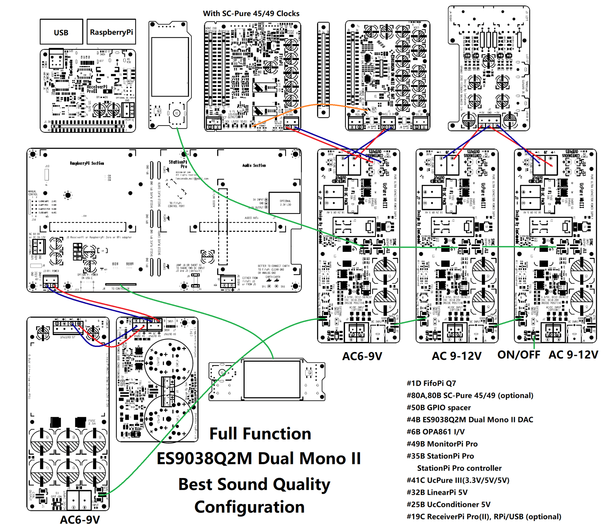

Hello all,
I am building a DDC with Ian Canada boards. I have a few question on power.
Here’s a list of the component I have
1. HdmiPi Pro (#17B) or TransportPi AES
2. FifoPi Q7 (#1D)
3. StationPi Pro (#35B)
4. LinearPi 5V(#32A)
5. UcConditioner 5V (#25A)
6. UcPureMkIII
8. MonitorPi (#49A)
Amanero Combo384
2 small ultracapacitors for the UcConditioner
2 large ultracapacitors (with a boarding board to buy very soon) for the UcPure
The Amanero Combo board is on the RPi section of the Station
On the audio section, I have the HDMI Pro on top of the FifoPi Q7
I have installed the two jumpers on J9 of the StationPiPro since I want to test with only one source of power for now.
1- It is possible to plug a USB-C with 5V LPSU on J13 to test the DDC without the ultracapacitor boards?
Next, I will mounted the UcConditioner on top on the LinearPi.
V+ and V- are connected to J2 input (UcConditioner) and J6 output (UcConditioner) to connected to J3 of StatoionPiPro. I would test my project with this set-up,once I know the DDC is working.
2- What transformer do you suggest, is the Hammond 1182N6 is enough for 5V?
In the last phase, I will add the UcPure MkIII, I will connect the power output to J5 of the StationPiPro and remove the two jumpers at J9.
3- Do I need to buy another transformer or a dual would be OK? Which one do you recommend?
Any hints will be appreciated.
Thank you for your help! :)
Yves
Here are my answers for now.
1- Yes. But, you need 3.3v for FifoPiQ7.
2 and 3- I am testing with one torrid transfo for now (Dual 6v and 12v). I’ll let you know if I need an extra (I.e. one for each PS).
