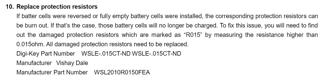

I made a mistake using my LifePO4 mkII: i inverted the polarity of the battery in the BT6 position (I saw some sparks but nothing more).
Now when I turn on the system i have the correct voltage on J1 and J2 (i'm using the system with 4 battery but i'm using only J1 and J2)
BUT
when I turn off the system and it goes in "charging" mode, the BT6 doesn't charge the battery.
All other 3 batteries are charged properly.
the problem is that if battery BT6 is below the threshold, the system charges the other batteries continuously without interrupting (and therefore overcharges them).
If I remove the battery BT6 (to try to use the system only with the other 3 battery, BT7, BT5 and BT2) the voltage meter on the board measures around 2V, and so again try to overcharge the battery.
I suppose I burned something but I don't know what.
Can you suggest me something to control or to change on the board ?

Thanks to Ian that suggested me to check some protector resistors behind the board. It seems I have two resistors burned. I've already ordered and I'm waiting for them.Hi to all,

I hope this will solve my problems and I don't have nothing else broken.
I also checked in the board manual and effectively there is a section that describe how to solve the problem.

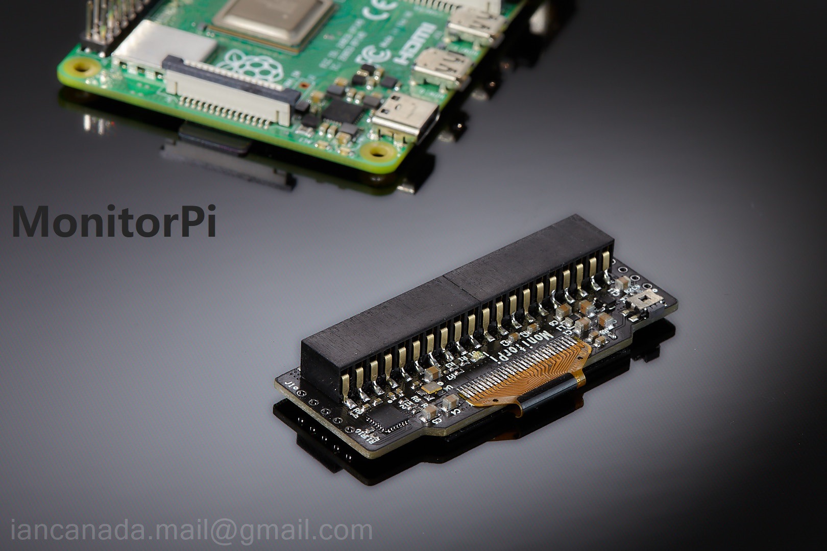

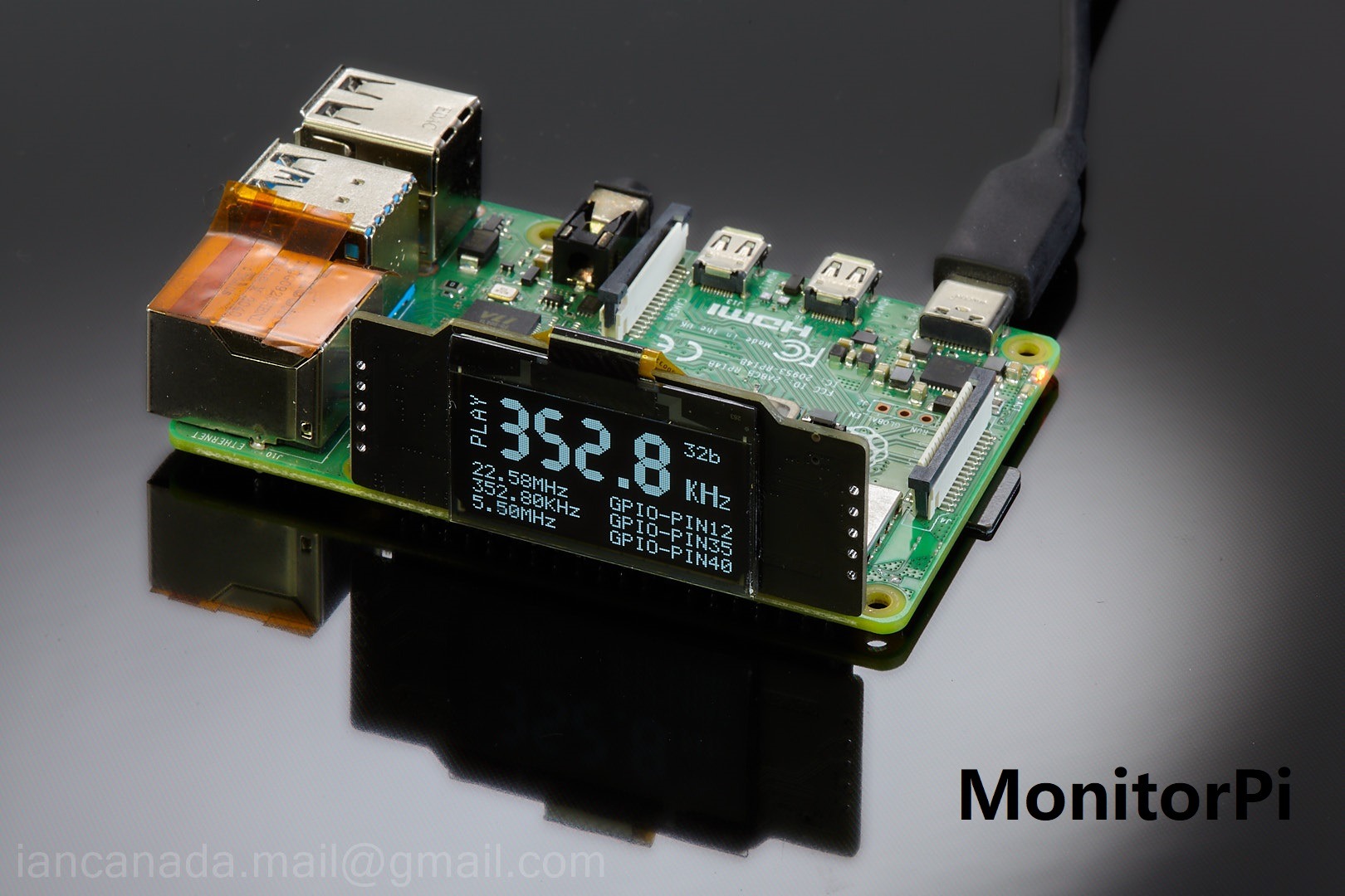

MonitorPi
I finally made it to integrate a real time I2S/DSD signal analyzer into a tiny ARM chip.
MonitorPi is a universal digital audio signal analyzer & OLED display. It can be applied to any RPi audio application and/or any other audio application. Even just on top of GPIO of a RPi only.
MonitorPi is capable of analyzing/displaying signal up to PCM768 KHz and DSD1024. No software/driver is needed. The OLED screen is 1.3”. I’m trying to use a big font to make it clearly seen in the distance.
It's a really interesting gear. By using it we can have a nice display for any project. And debugging a system will be also no longer an issue.
