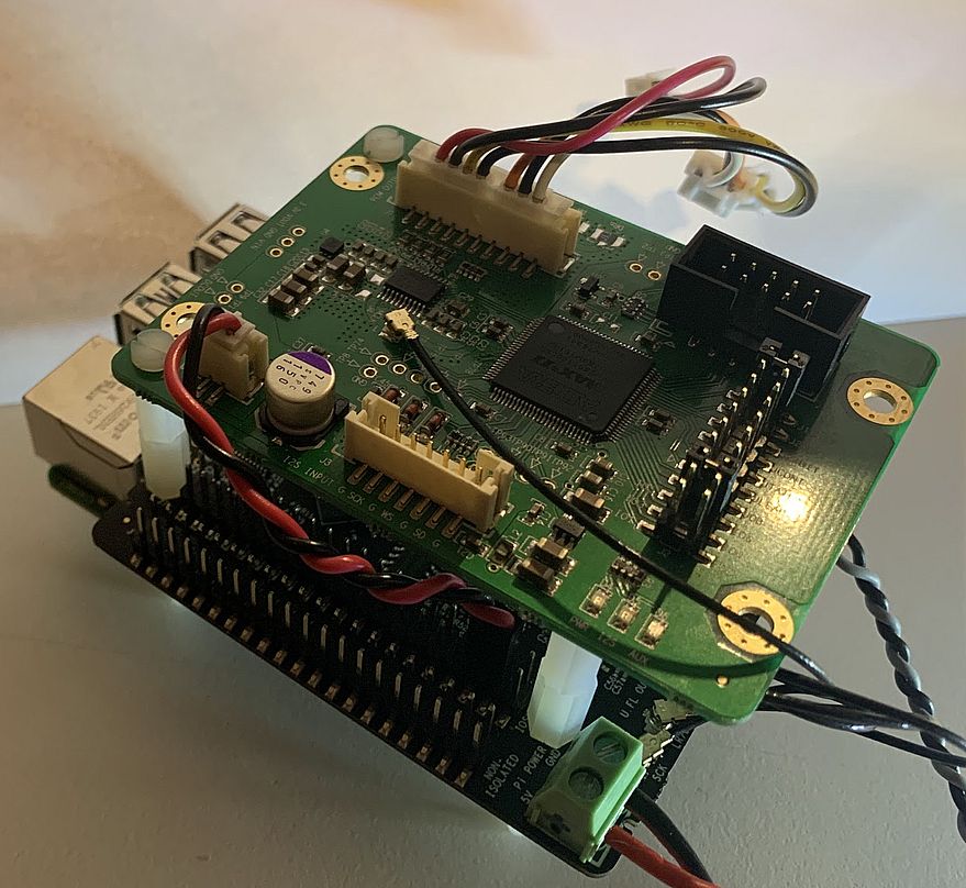

Is anybody using SinePi successfully with a FifoPiQ2 and two external Andrea clocks? I'm having problems.
The FifoPiQ2 is working perfectly with two Crystek XOs, but when replacing these with the SinePi and two external Andrea clocks (45/49 MHz) the SinePi relay keeps switching between the two clocks no matter what the FifoPi input sample rate is. The clock outputs seems fine.
Hey - You need Q3 to manage two XO's without OE Pin. Worth the upgrade with the reclockpi though. Pretty significant for clarity, I was surprised.Is anybody using SinePi successfully with a FifoPiQ2 and two external Andrea clocks? I'm having problems.
Edit: I use Andrea Clocks..
Hmm... that is not what is written in the manual...
In the introductions it says: "works flawlessly with FifoPi Q1, Q2 and Q3".
The only place Q3 specific functionality is mentioned is for the "half sine mode" with one local square wave crystal. Here it reads: "the local XO doesn’t need an OE control pin if you use FifoPi Q3 or higher".
If what you say is correct SinePi does not work flawlessly with FifoPi Q2. It is in reality only compatible with FifoPi Q3.
Anyway, I hope you are wrong and that Ian will take a minute to clarify things.

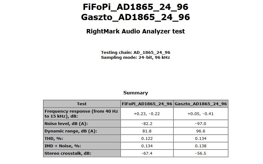

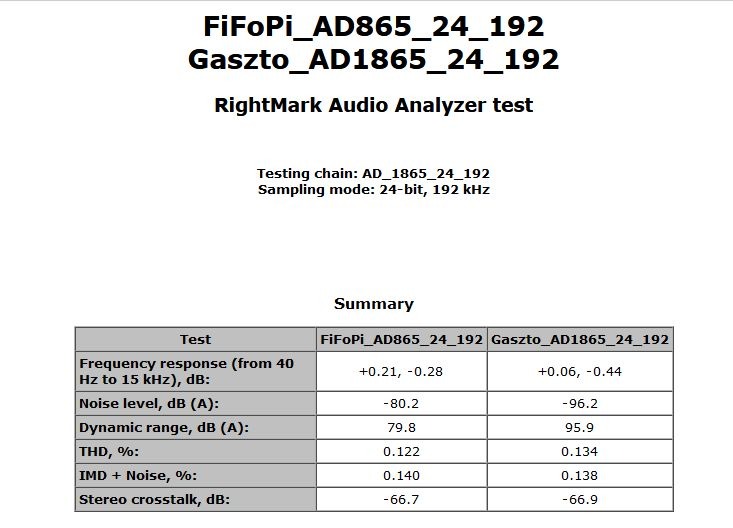

Hello,

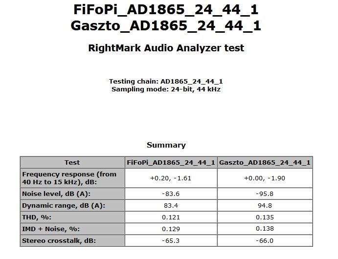

I 'm using FiFoPi Q2- I2StoPCM - AD1865 DAC, but is it a step back in sound quality comapared to my previous setup (RPi USB port - JLSounds - AD1865)
With USB - JLSounds the sound stage was more defined, there was a big air around the instruments. Now it is dull.
I did some measurement (before and after) with my ESI Juli@ sound card, and the Noise and Dynamic was better.
I connected FiFoPi and I2Sto PCM card with U.FL cables, as short as possible. The power supply is for the clean side of the FIFoPi, and I2StoPCM card are two parallel LT3045 (I used same power supply earlier for the JLSounds card)
Anybody have an idea what is wrong? I think FiFoPi should be as good as the JLSounds or better.

External clocks are connected via coax (gnd/signal) to SinePi and there is no connection for an "enable pin".
I may have a defective SinePi and for the moment I'm just trying to find out if it should work.
The continuous switching of the SinePi relay occur only when FifoPi Q2 is receiving a signal. It happens independently of the number of clocks connected (2, 1 or none), making me think that the problem may be related to the square wave conversion.
If you say so - have a good eve.This is from the description of Q3 that came out a long time before SinePi and the information refers to square wave clocks plugged directly into Q3.
The JLsounds is great, but I prefer using I2s over HDMI - less conversions. Try the reclocker, that really made a significant difference for me.Hello,
I2StoPCM is also an old design.

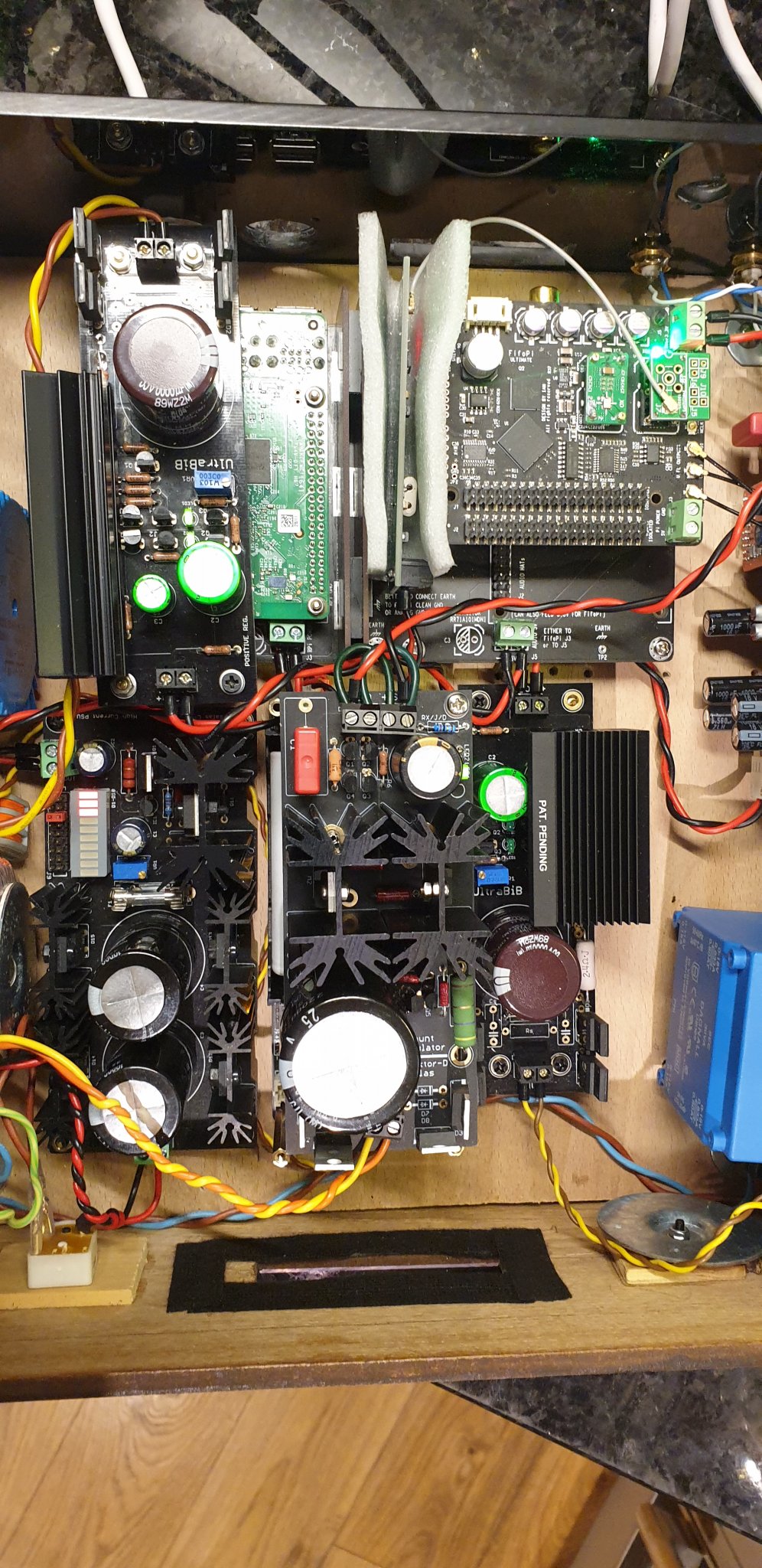

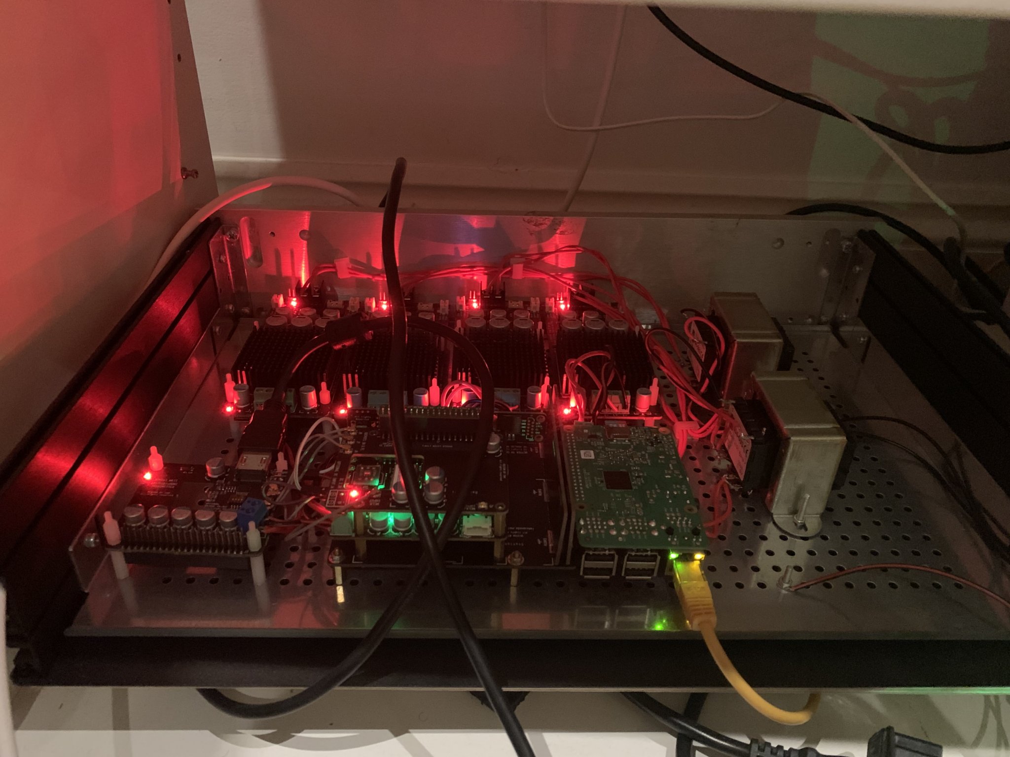

Whilst I am here and Ian is on a R+D sabbatical. I have been fiddling around with my dac/streamer for quite a bit now - I think I'm on year 2 now (maybe year 3). These are old photos, I'm super happy about the clarity/tone and since broken it into pieces for a proper case (waiting on stationpi pro). It has sent some expensive off the shelf stuff back to the shops or friends houses!
I am getting ready to take what I've learnt (had a couple of Dac projects on the go for a while now) and build an end game streamer/dac. Key differences for my personal end game is R2R for conversion (so much easier to get good sound out of a R2R chip - ESS is hard hard work but worth it imo for the benefits of SDM but also the benefits of R2R (If that makes sense)... - but waiting for Andrea's discrete option), ATX for streamer.
DAC: Please ignore build quality like that 5v dirty side , I on average rebuild once or twice a week to test something new - not much has changed here though apart from ultra caps on the dirty side of the FIFO. There is also an external 19v LPS for the battery board you cannot see in the photo.
The streamer has changed substantially - there are 7 rails now, plan to add ultra caps on rebuild but still need to be purchased. There are two toroidy transformers now, much larger VA. 1x for pi side/FIFO dirty Side and 1x Clean side. I also have two Andrea clocks for streamer, but want to see if I can hear the benefit of double Andrea clocks..
I have to say congrats Ian, the sound I have achieved from this gear has really really surprised me and anyone that has visited.
It's certainly dealt with my OCD nature for a while I think I have tried most power supply/clock options out there on this project.

Forgot the output stage! That's taken the longest to get right. I have gone for a hybrid output stage. I use transformers (Ivan's Copper primary and silver secondary - amazing and worth every extra) for IV conversion with Z-foils. I have it set-up so the ESS chip only sees 2.5ohm load (Game changer) and it pops out 0.2v output to the real gain stage - that brings it up to around 1.8v something (Testing tubes)
I had this and mentioned to Ian. I think after a few resit's - they do get loose. I've redone a few Fifo Q2's and Q3's clock connectors to get that tight fit again. Sinepi is a nice design with the ReclockPI because it applies pressure from the top and prevent's the sinepi moving about. A nice functional improvement, not sure if it was intended, but there wasn't a lot of vertical space for the sinepi - so must have taken Ian a little while to get it right.Dont know if its the integrity of the pins seating in the socket...
I'm a big fan of the Reclockpi
Serious setup Sebby. Nice work.
