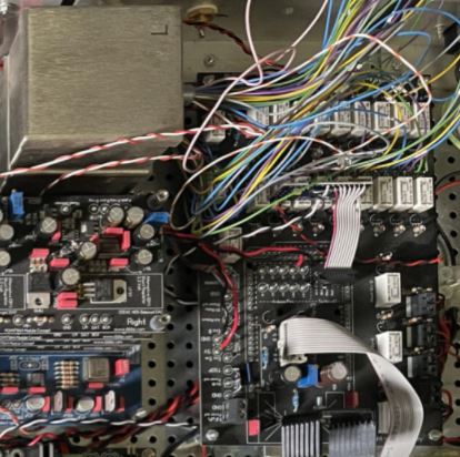

Hi Simon, what’s that board on the right?
Hi - not sure which board you are referring too?
If you mean this PCB then this is the "brains" of the DAC in terms of the overall control of it.
It covers.....Remote control for input selection and the inclusive TVC volume as well as rotary volume control, driving an LCD display, controlling the mute features and more.
Test routine to display the core PSU voltages on the LCD for test purposes
Its all run by an Arduino so had the write the software too.

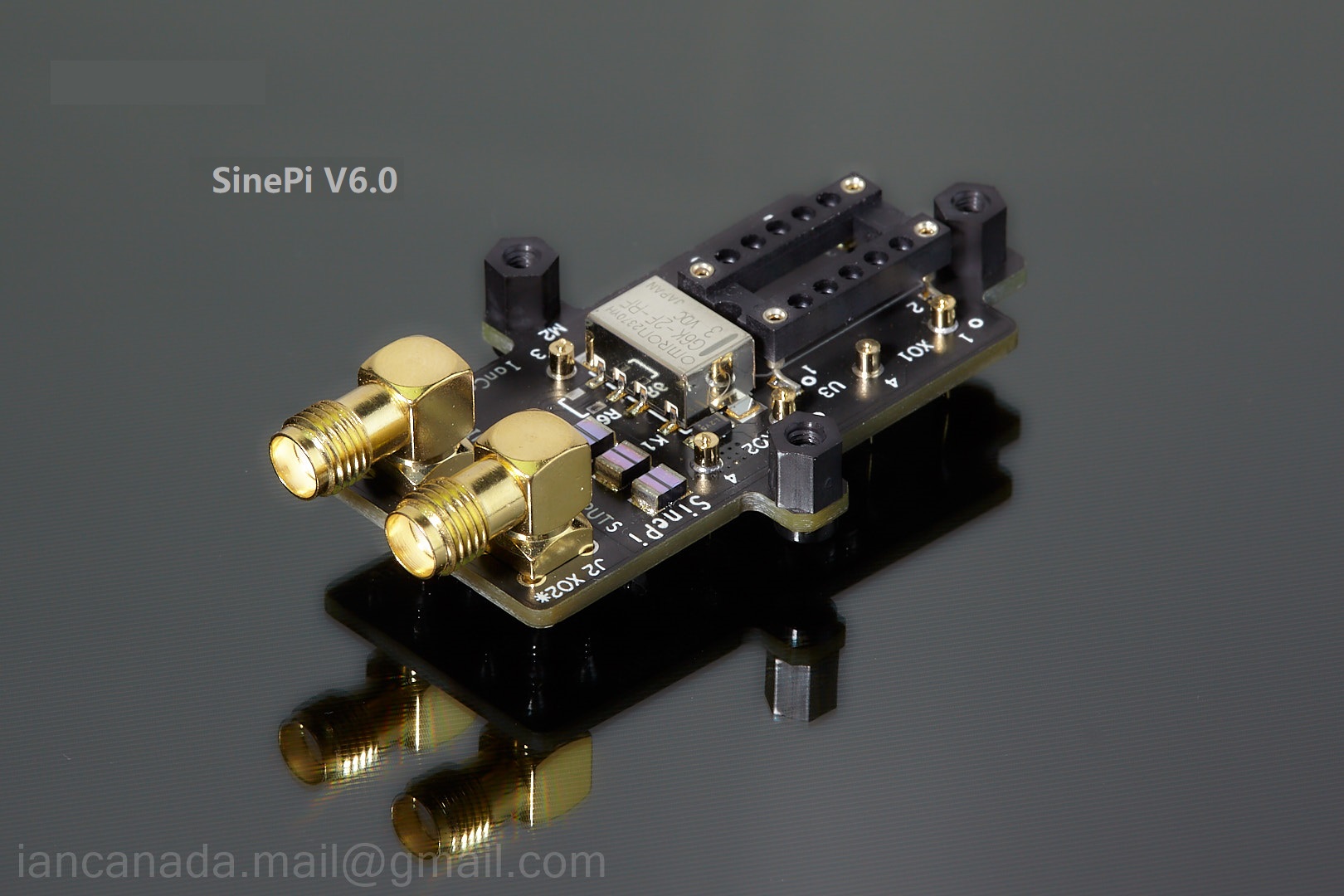

The SinePi is almost down.
The only thing I'm concerned about is the cost for such a low quantity production. But no worry, I'll figure it out.
I'm down for one as well.
Me too, I have a Neutron Star clock and would definitely like one

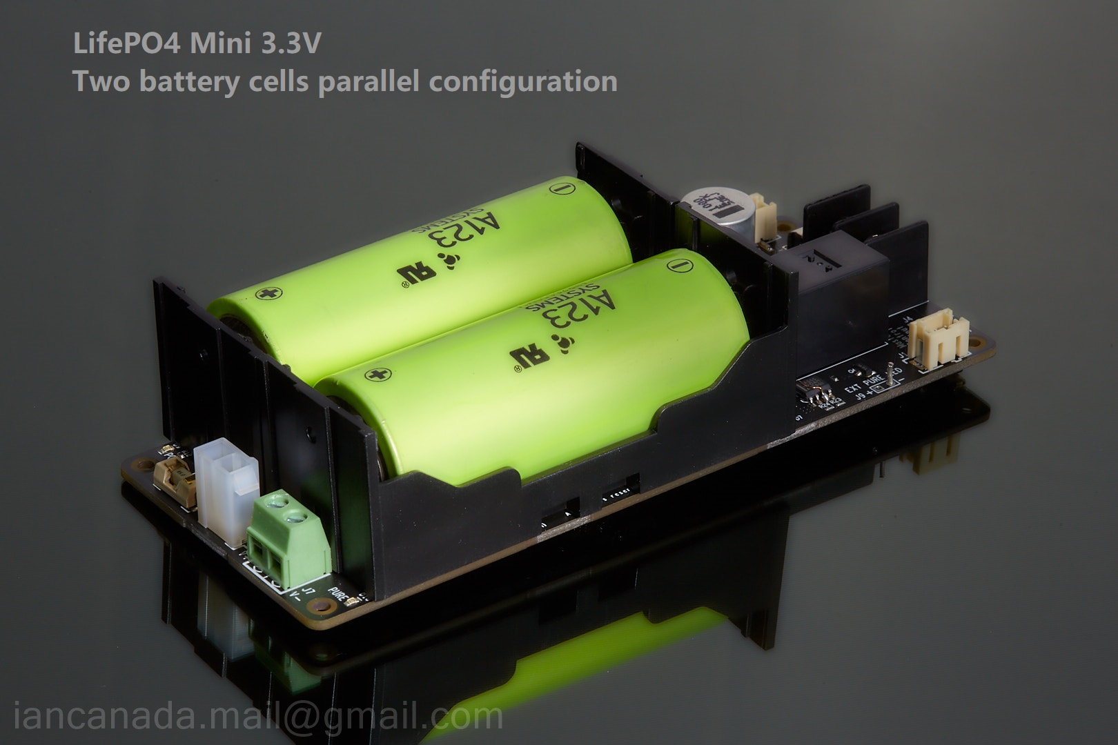

Looking for the best power supply solutions for SienPi (or FifoPi clean side)
SinePi sine to square converter (squarer) can be looked upon as a high gain amplifier. That’s why a better power supply can also make more improvements.
I did a lot of tests trying to find out the best power supply (shared with FifoPi clean side) for SinePi . Here is the list of the three top power supplies I experienced. They really make an audible difference in my system.
Long story short, here are the results
No.3: LifePO4 Mini 3.3V in two battery cells parallel configuration
Better than all low noise LDO active power supplies. And also better than the other 3.3V LifePO4 battery power supplies in single cell configuration. I have to say the sound quality was gorgeous. It brings all the DRIXO OCXO low phase noise performance to the best possible sound quality level as it should be. It was playing very musical, warm and flawless in my system. BTW, LifePO4Mini is a low cost pure LifePO4 power supply I designed recently.

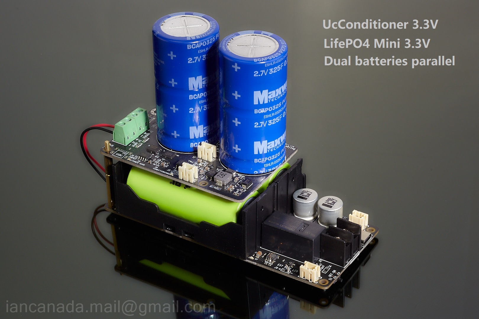

No.2, UcConcitioner3.3V with the LifePO4 Mini 3.3V two battery configuration
With all the signature that No.3 has, but better 3D image focusing, sound stage and high range.

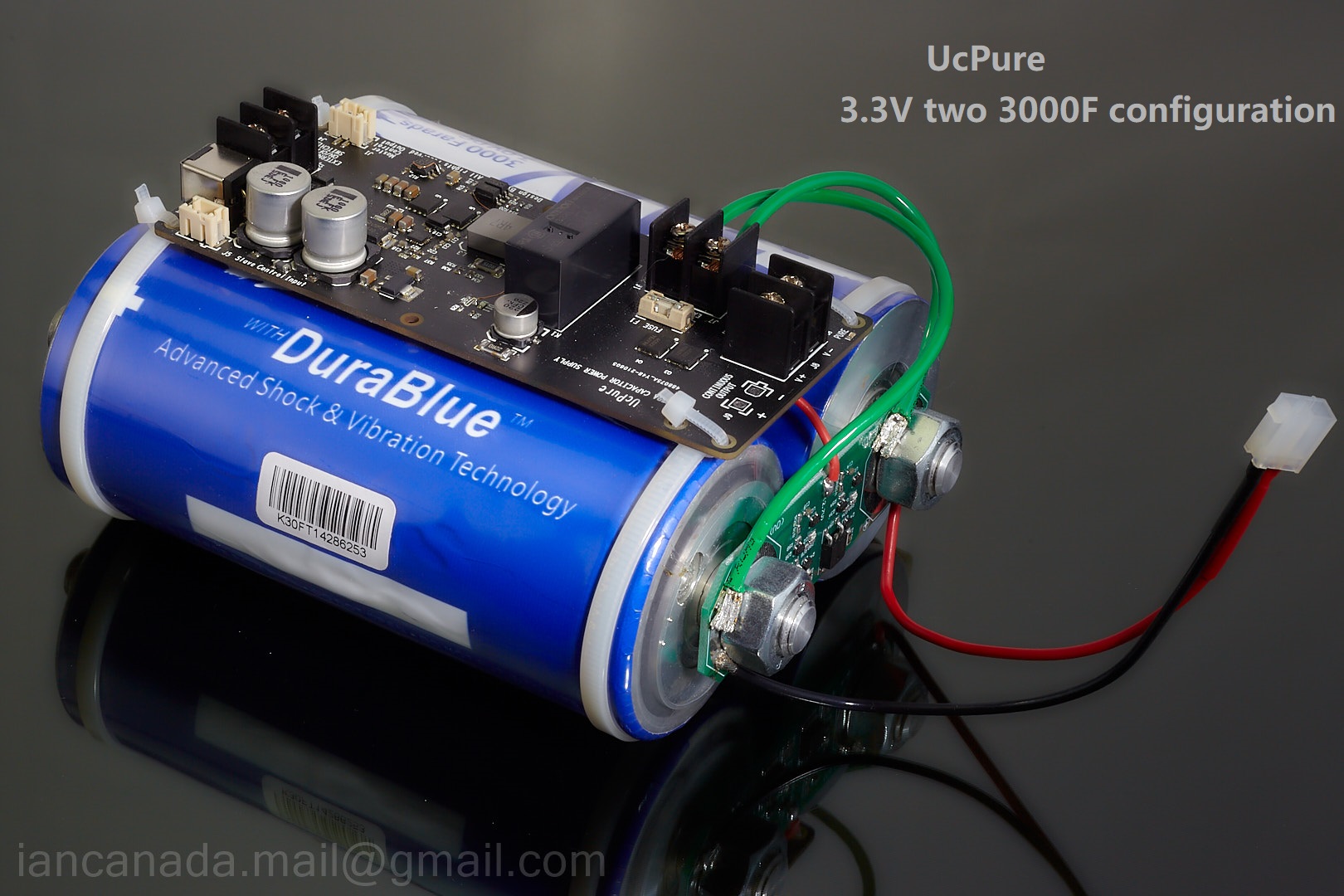

No.1, UcPure 3.3V with two 3000F ultracapacitors
This power supply is very special, it uses two 3000F ultracapacitors in pure class A mode. There are no active components so could get the best low 1/f noise performance. I have to say it’s really a game changer. No doubt the sound quality is the best. Better than both No.3 and No.2. Soundstage was wider and deeper. With more details in the air around the atmosphere. The 3000F ultracapacitors themselves could be even more expensive than the power supply. That would be a disadvantage.
And also, any two amplifiers sine to square configuration will have RF crosstalk issue as long as they share ground or power rail. My tests show that the crosstalk can degrade the time jitter performance at output. I have a smart idea for SinePi V6.0 to make it the first design that uses a unified sine to square converter for both frequencies to eliminate this crosstalk issue. Nobody has had this idea before.
All the 3 power supplies are galvanically isolated from the input at working mode. So, common mode EMI noise will also be eliminated.
Please note, all of the tests were done in my system and based on my own experiences. The results could be different under different systems. And also, different persons may have different subjective experiences.

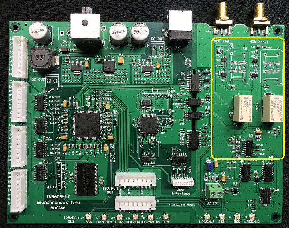

Hi Ian,
so we have to add the second sine to square converter to our FIFO, otherwise you are not the first using a single sine to square converter for both frequencies.
It looks like somebody has already had this idea before.
Sorry to say but it was pretty obvious.
Andrea
