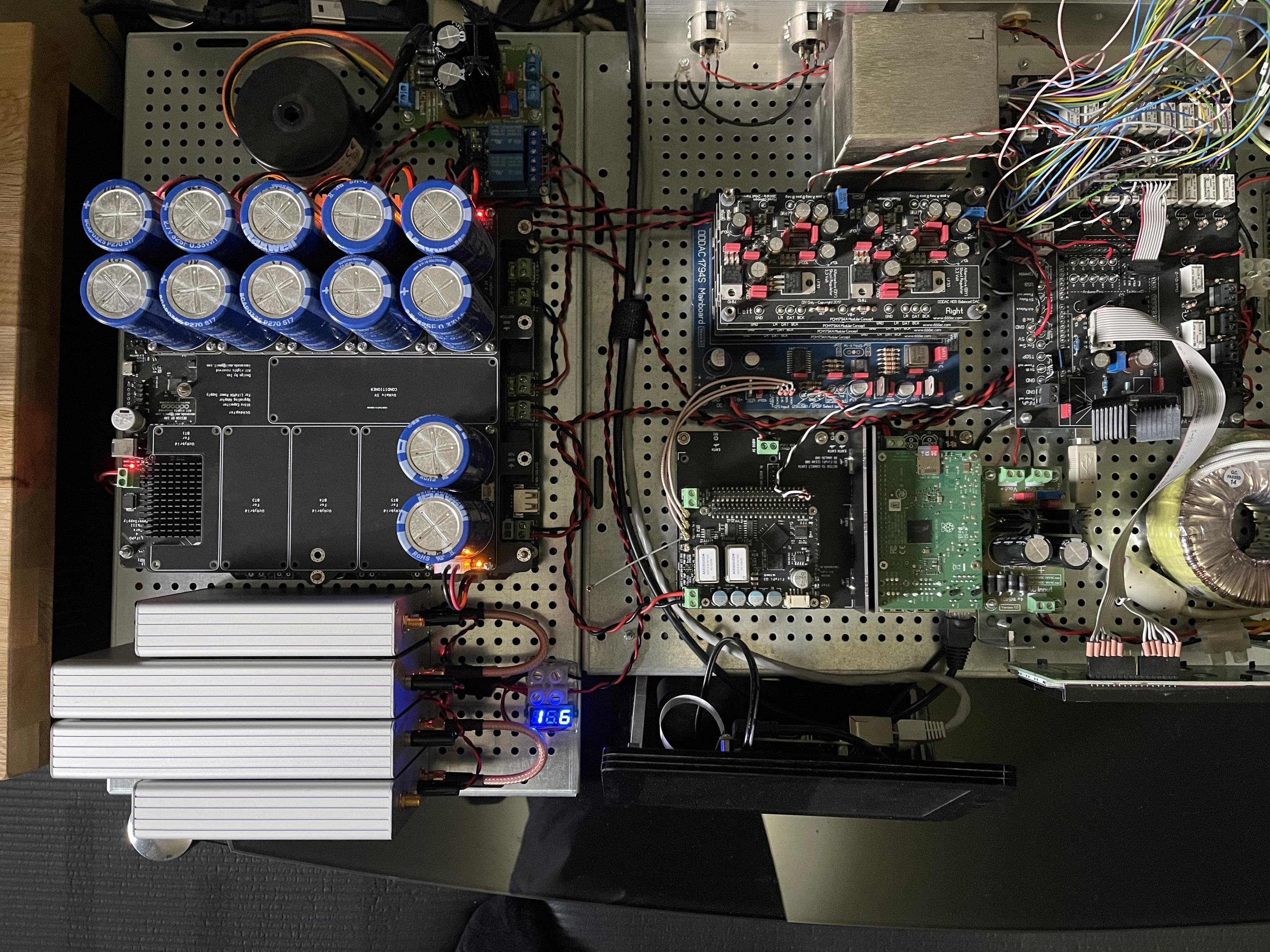

Mine is a relatively simple implementation of Iancanada streamer with TDA1541a DAC and Lampizator output. The modular chassis has served well. Four separate isolated boxes in one kit for PS, DAC, Triode output, and streamer. But simple compared to many here as I have not used batteries or supercap conditioners. Bottom side is Ian's streamer lego kit. Above are the rest.

@jimk04 They are Salas shunts. I tend to reuse parts where possible. These supply +5,-5-15V to TDA1541A as well as +5 in the lower section which acts as a prereg to the clean side of FIFO and Reclock. Then Ians reg on ReclockPi. I used a zener emitter follower for the dirty side of FIFO and a high current 7805 to Rpi. So nothing fancy, but seem to do the job. Part of the clean up with StationPi was to build a better supply for Rpi. The big can cap on the underside contributes to 85mF CRC filter which can supply very low ripple.

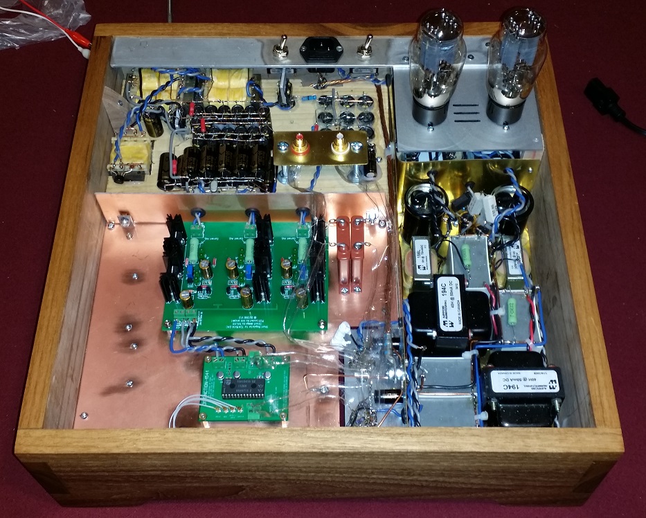

@iancanada - thankyou. I use a simple 60r resistor IV. The key is a very good resistor. I wind my own manganin non inductive resistors for the I/V and the resistors in the triode output amps. Makes a surprising difference. The photo of the top side is a little dated. It now uses some nice copper coupling caps from Miflex. Again, I am very impressed with the sound your FIFO system is producing.

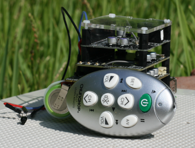

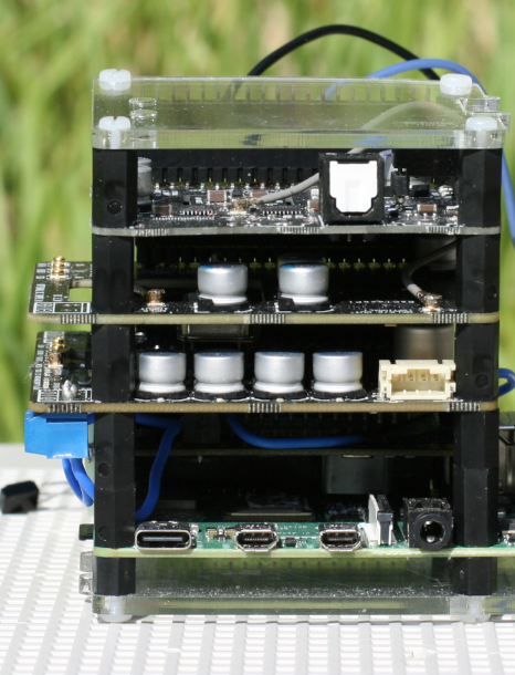

I do optimise so I need RPi 8GB. 3-4GB to load the OS into RAM and another 4GB for the Squeezelite AudioPlayer Buffer.
I definitely feel my little transportable can compete with the expensive commercial offerings after moving to AudioLinux. It's just a dream to have this much power in such a small package. If AudioLinux was not available for the RPi, I would of likely switched over to a 12V PC solution just so I could run AudioLinux. Fortunately, since the RPi is pretty powerful these days, a RPi AudioLinux option was released.
[Photo Attachments]
I'm in the middle of configuring IR Triggers and Hotspot, so please excuse the mess. I'm running the optional Ian GPIO terminator on top so the top lid is not level.
