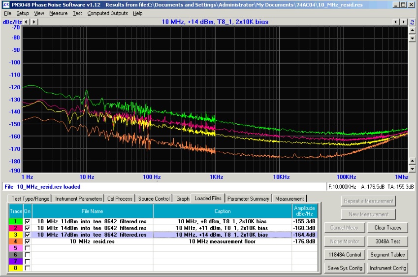

Hi peufeu,
the 74AC04 as a sine to square converter has been measured many time in the RF circuit, and its residual noise is well known.
I attach a plot of the phase noise measured with the old HP 3048.
Noise floor of the tools aside (the old HP 3048 has higher noise floor) the residual noise is the same we have measured with the Timepod.
If anything, HP 3048 measurement is optimistic against the Timepod.
Andrea

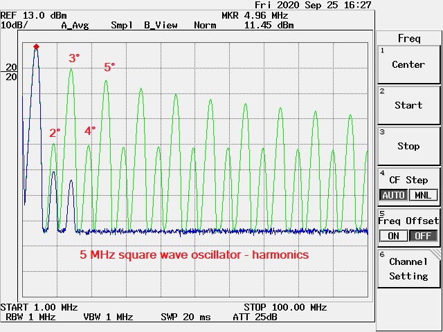

Hi Ian,
I hate to repeat myself, but since your assumptions are far from the reality I have to do it.
We have already demonstrated that the Timepod measures correctly square wave oscillators, let me recall here.
We have measured the phase noise of a 5 MHz CMOS output CTS oscillator with and without a low pass filter with 7.5 MHz corner frequency before the input of the Timepod to suppress the harmonics above its fundamental.
The first picture shows the spectrum analysis of the square wave at 5 MHz without the input filter (green curve) vs the same square wave with the filter at 7.5 MHz (blue line).
As you can see the spectrum of the signal without the low pass filter is charged with lot of harmonics, while inserting the low pass filter the harmonics practically disappear.
This means that the first 4 harmonics (10MHz, 15MHz, 20MHz and 25MHz), which have the higher energy, are not attenuated by the Timepod LPF at 27MHz.
They are captured by the ADCs exactly as are, so there is no conversion into sine wave.
The second picture shows the AC characteristic of the filter we have used.

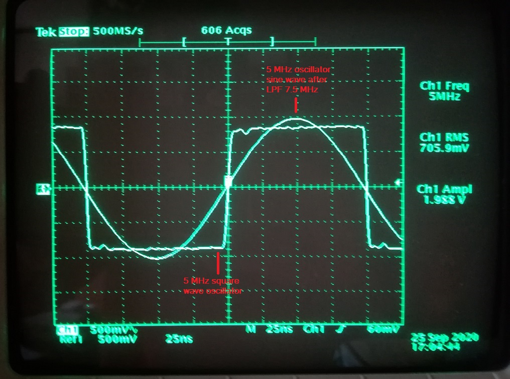

The third picture shows the oscilloscope snapshot of the waveforms.
The square wave output of the XO as is, and the sine wave obtained from the same XO filtered by a 7.5MHz low pass filter.
This means that the Timepod will measure the original XO square wave against the same square wave converted into a perfect sine wave.

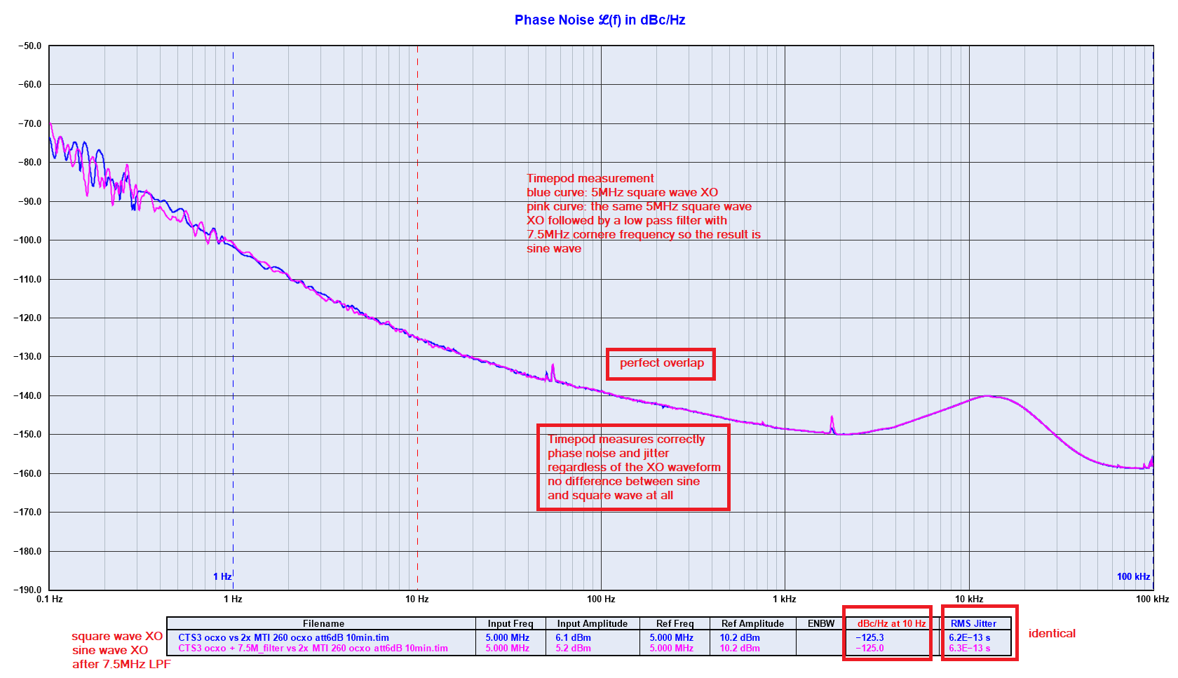

Finally the fourth picture shows phase noise and jitter comparison between the 5 MHz square wave XO with (pink line) and without (blues line) the low pass input filter.
As you see the two plots are exactly superimposed and the measured jitter is exactly the same, the harmonics of the square wave don't affect phase noise and jitter measurements in the least.
Measuring a 5 MHz square wave its harmonics fall into the passband of the input filter used in the Timepod (27MHz) but phase noise and jitter results are exactly the same, which demonstrates the reliability of the gear even with square wave clock.
So, please stop telling your own story when the reality is the opposite.

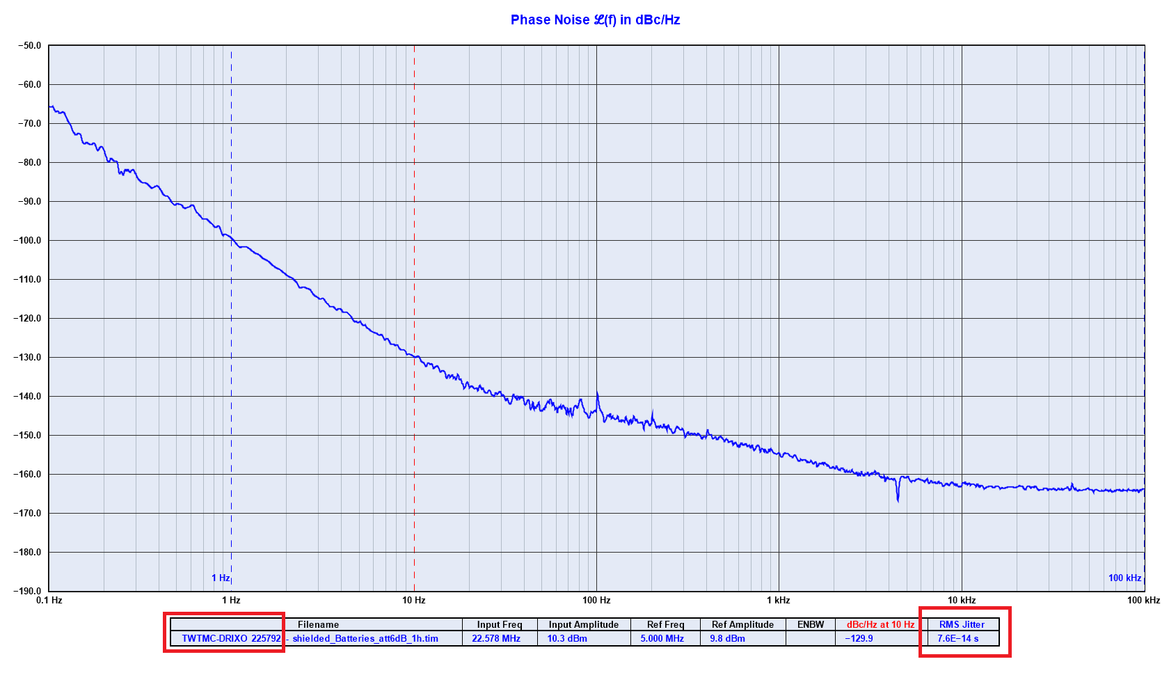

Since Ian said he trust the Timepod when measuring sine wave oscillator, please take a look at the plot of the DRIXO at 22.5792 MHz.
It's a sine wave oscillator so Timepod measurement is reliable: the measured RMS jitter is 76fs.
I assume Ian will design the perfect sine to square converter so the jitter is not degraded during the conversion.
Therefore the jitter at the output of the sine to square converter will be exactly the same of the sine wave oscillator.
Then, how one thinks to measure a jitter of 76fs since the Lecroy digital oscilloscope has a jitter floor greater than 2ps?
Sorry but it's not possible without a different and suitable tool.
