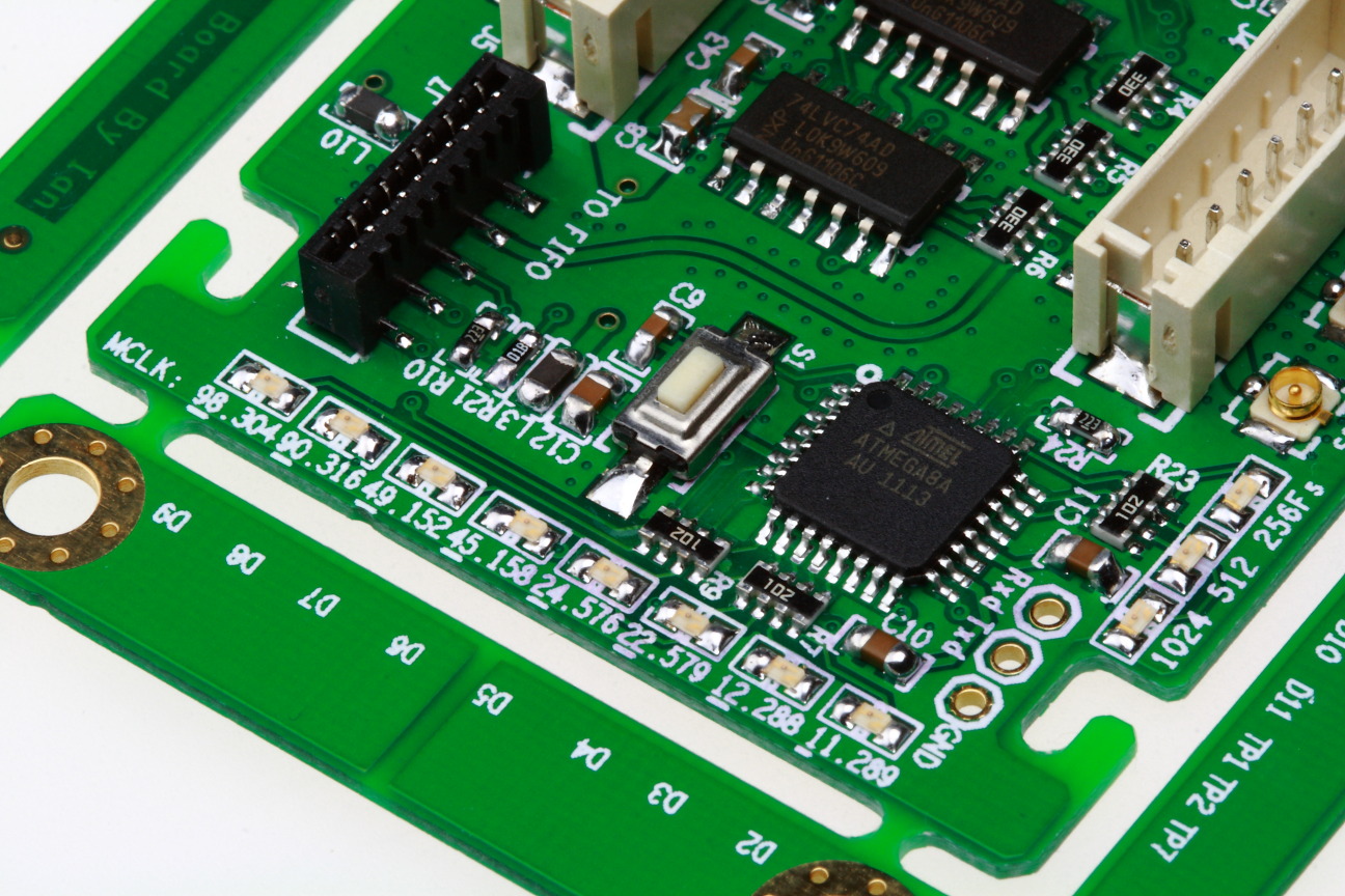

Rally cool looking board. Just a few questions, that I might suspect answers:
1. I see Rxd and TxD contacts - what is the purpose of those? Is that for I2C that could be used with Hifiduino? Since right now Hifiduino does not display rate when used with FIFO, I hope new board will fix that. I think I recall earlier that conversation.
2. Is it possible to use new clock board stand a lone without FIFO? I am just curious since it will be good to have such variable clock board for experimentations. I see no reason why not, besides having something to select frequency, but I stand to be corrected.
Thank you
AR2
Hi AR2,
hochopeper gave correct answers, I just have a little bit addition to qusetion 2,
I think you want to use this Si570 board as a stand along digital audio clock generatior. The answer is YES.
This clock borad can be used as multi-frequency audio clock generator with 8 frequencies. You can use the on-board push button setting the frequency at any time. The set frequency will be saved into on-chip flash memory and will be recalled each time for next power up.
Ian
Si570 Clock Board - Frequencies and xFs
Si570 clock board is designed to support digital audio stream from 44.1 KHz to 384 KHz, and xFs from 256*Fs to 2048*Fs. By taking the advantages of Si570, it could generate 8 audio frequencies, they are:
11.2896MHz, 12.2880MHz, 22.5792MHz, 24.5760MHz, 45.1584MHz, 49.1520 MHz, 90.3168 MHz, 98.3040MHz.
Among all of them, 90.3168 MHz and 98.3040MHz are optimized to ESS DACs.
Si570 clock board can work at both stand along mode and FIFO mode.
When working stand along as a universal digital audio clock generator without connecting to a FIFO, frequencies could be set manually at any time by the push button. The current setting will be stored into onboard flash memory and will be recall automatically after each power up.
When working together with a FIFO, frequencies and xFs will be switched automatically according to the input I2S Fs and the preset frequency and xFs combination group. Those combination groups could also be programmed by the on-board push button and will be saved into on-board flash memory. They are:

Group4 is highly recommended for ESS DACs and might be set as factory default.
An optional third party external controller could be used for display the clock board status and taking control of the frequency switching via UART port. But it's not a must.
Ian

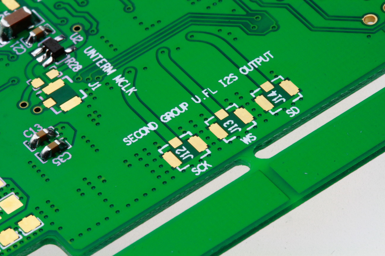

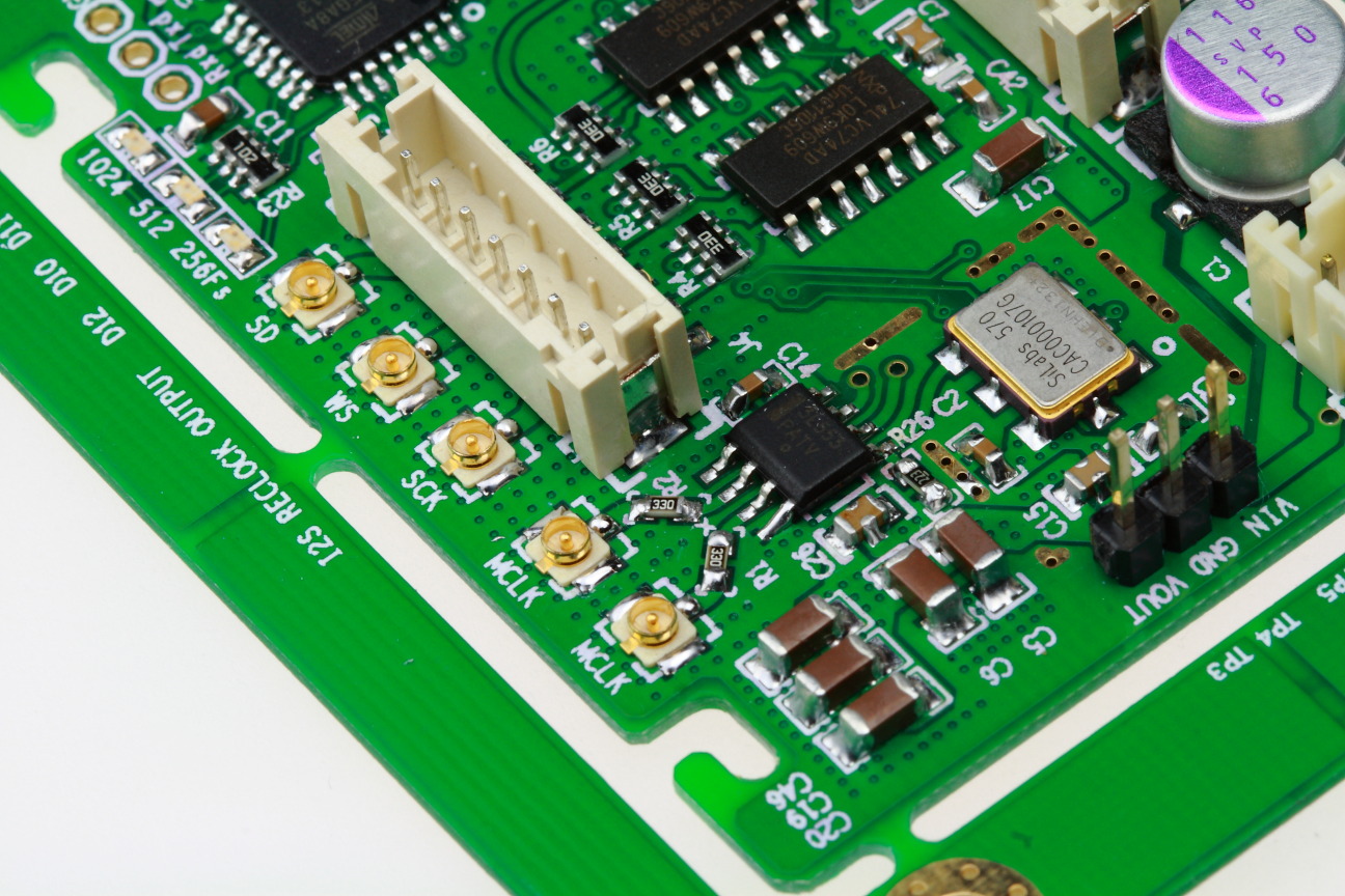

Si570 Clock Board -Native support DACs in dual mono
Si570 clock board was designed be capable to support DACs in dual mono configuration natively.
It has two MCLK u.fl output sockets with drivers independent from each other. Each of the sockets was driven by a dedicated clock driver to ensure high quality low jitter MCLK signals being fed into both DAC blocks. Carefully designed PCB layout matches the impendence to 50ohm transmission lines which optimized to the good signal integrity (SI) driving u.fl coaxial cables.
Additional group of u.fl socket footprints of I2S output signals for the second mono block were placed at back side the PCB. Each I2S output signal has its own source termination network to reduce both reflection and cross talking.
To run DAC in dual mono mode, I’m highly recommended using u.fl coaxial cables with same length to guarantee signals arrive at each block at same moment. Please keep in mind, every 1 inch 50ohm coaxial cable will cause roughly 120ps delay on signal!
That’s one of the black magic of a digital cable: vibration and jitter
Ian
