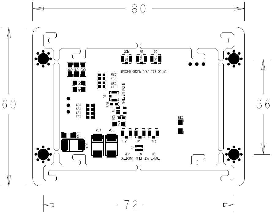

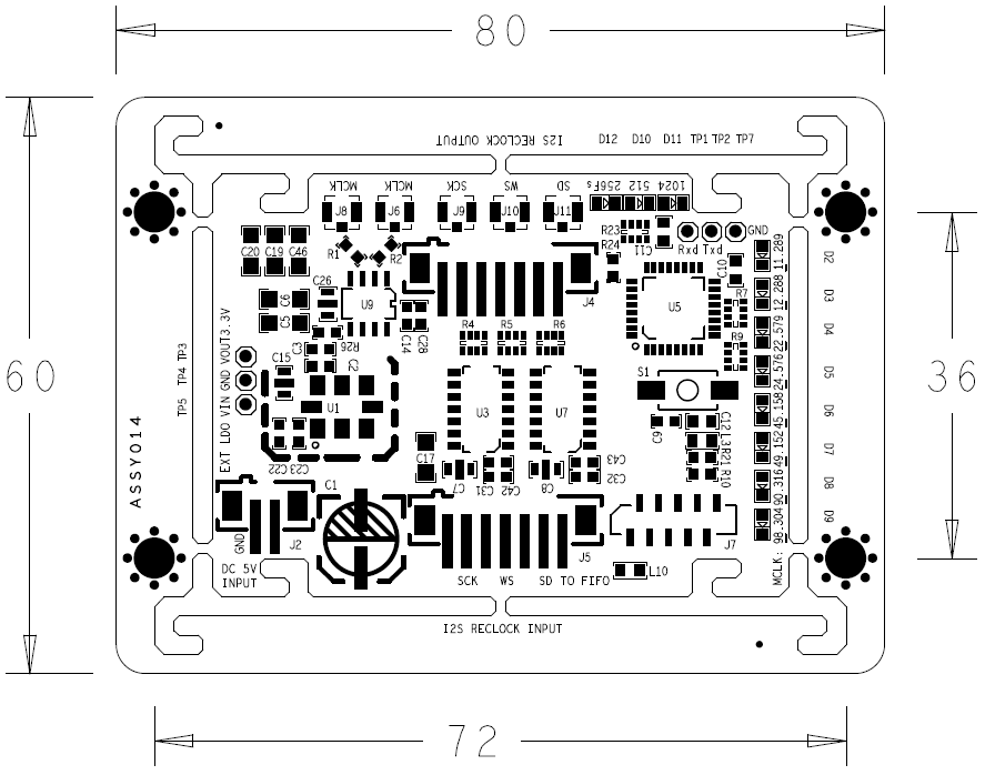

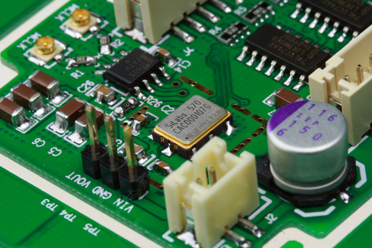

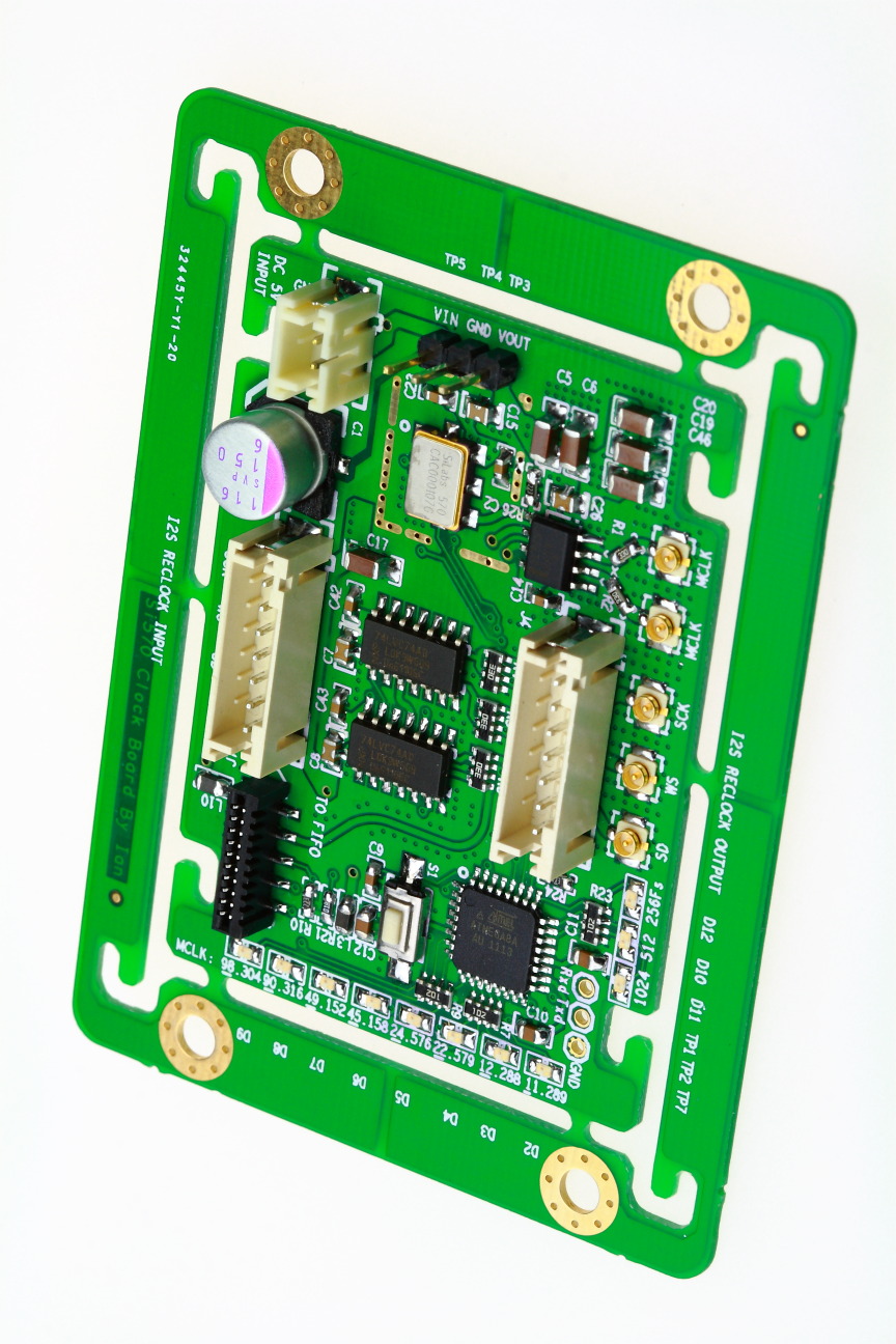

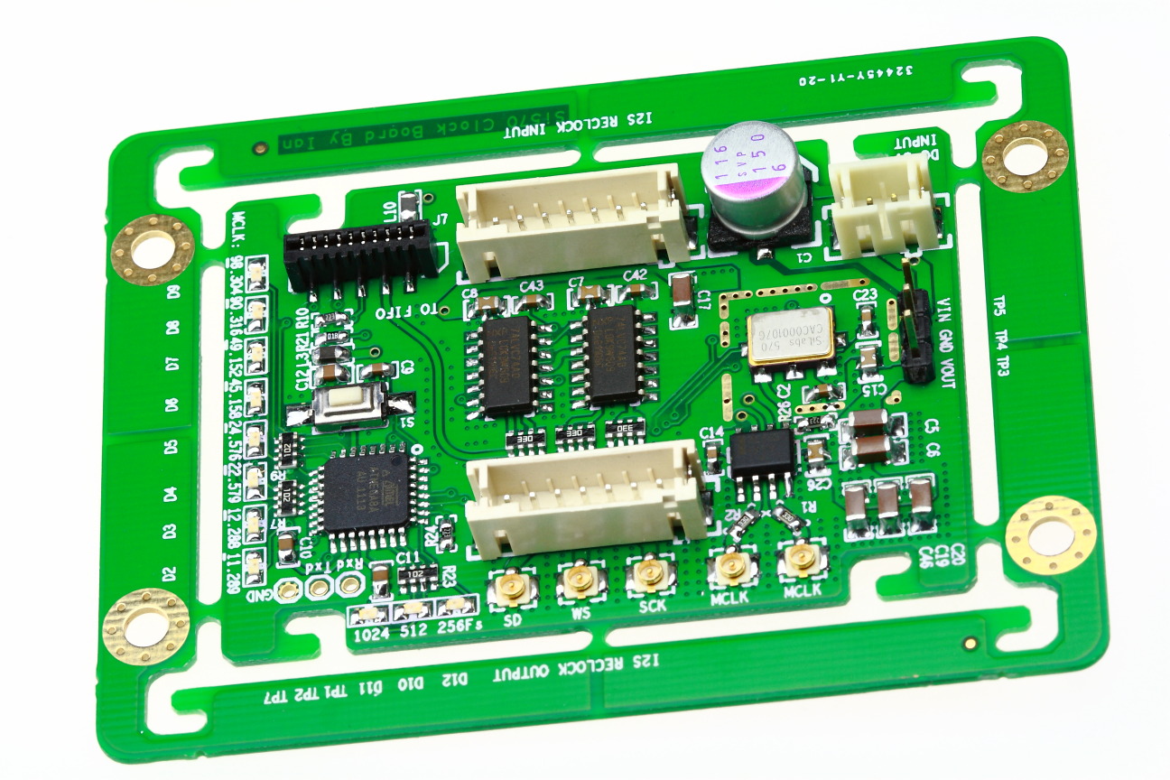

Si570 Clock Board V3.0 – First glance
Si570 Clock Board V3.0 has been running with my system for more than three weeks. The sound was so good. I was pretty much afraid of that the good sound is gone if I disconnect it from my system for taking pictures. That's why I didn’t post it until now. Another psychological problem :).
Form V1.0 to V3.0, the design of this small clock board has been revised for three times, as well as three generations prototype PCB. Plus the coming production version, what you will get from the GBIV would be the fourth generation. Sorry for the too much delay, it’s the other side of pursuing perfect. But I'm glad having improvement for each revise. I like the word from a friend: "Good things worth to wait"
There are three main changes implemented to V3.0 from V2.0
1, Removing on board LOD which is being considered as one of the bottle neck of this clock board. Making it’s possible using high quality low noise external power supply to boost the Si570 performance, as well as experiencing different power solutions.
2, To make it optimized for ESS DAC, inverting the MCLK according ESS application note. But it could be jumped back to normal clock phase for further research or other applications.
3, Under the help of simulation software and jitter measurement, carefully re-designed the layout, make it enhanced for high frequency low jitter clock generation up to 100MHz
More information about this Si570 clock board will be posted later

Ian, is that mounting points for an RFI sheild that I can see there?
I know you will explain this later but I will ask anyway, is there an extension to the USART API to control the inverted/normal MCLK or is it hardware jumper only? I ask because swapping these settings with software might allow quicker switching for better A/B comparisons of the settings.

Yes, it is for the optional RF shield :).
Ian

Congratulations Ian!
Rally cool looking board. Just a few questions, that I might suspect answers:
1. I see Rxd and TxD contacts - what is the purpose of those? Is that for I2C that could be used with Hifiduino? Since right now Hifiduino does not display rate when used with FIFO, I hope new board will fix that. I think I recall earlier that conversation.
2. Is it possible to use new clock board stand a lone without FIFO? I am just curious since it will be good to have such variable clock board for experimentations. I see no reason why not, besides having something to select frequency, but I stand to be corrected.
Thank you
AR2
Hi AR2,
I think I can answer those for you :)
1. There is an API doc for the serial port in this post here.
2. The clock board is hard to use separately to the FIFO. I agree it would be nice but the only time that you can change the MCLK is when the input FS changes, within 100ms of 0xC1 event being sent from Ian's Si570. I am reading between the lines but I think this would be reliant on additional comms between the FIFO and Si570 to trigger this event in the Si570 local controller (on Ian's board). Since the FIFO protocols are not published (Ian was asked a few pages back and he has said he is reluctant at this stage to expose these internal workings of the FIFO) there is no way to trigger these events to allow the clock to change frequency separately to the FIFO eco-system. I think it may be possible to use the Si570 as a fixed speed MCLK for other systems at whatever MCLK rate was set previously and rely on async clocking.
I am writing separate control for Si570 already that will be available publicly when it is ready, but will not run on an Arduino. For hifiduino it would need glt to write some additional code for hifiduino to support Si570 comms to calculate the current Fs for output to your DAC LCD/VFD display when using synch mclk (which is what I think you're trying to achieve mainly right?).

Looking good Ian! A wish for the GB4. Please gather all things possible to be ordered so that one don't need to visit GB 2 and 3 for isolator, regulator and cables etc...
For iso. and reg., please provide assembled.
Can Si570 still be regarded an embedded solution i.e. no controller is needed in order to play music on different sampling rates?
TNT,
Si570 external controller is only for either custom mclk at each Fs or to all an arduino to display current Fs, xFs and mclk on an LCD or similar.
There is no need for external controller for normal operations. There is a link in the Si570 section of the wiki to an earlier post by Ian that lists the standard mclk frequencies selected by Si570.
Hope that clarifies things for you :)
