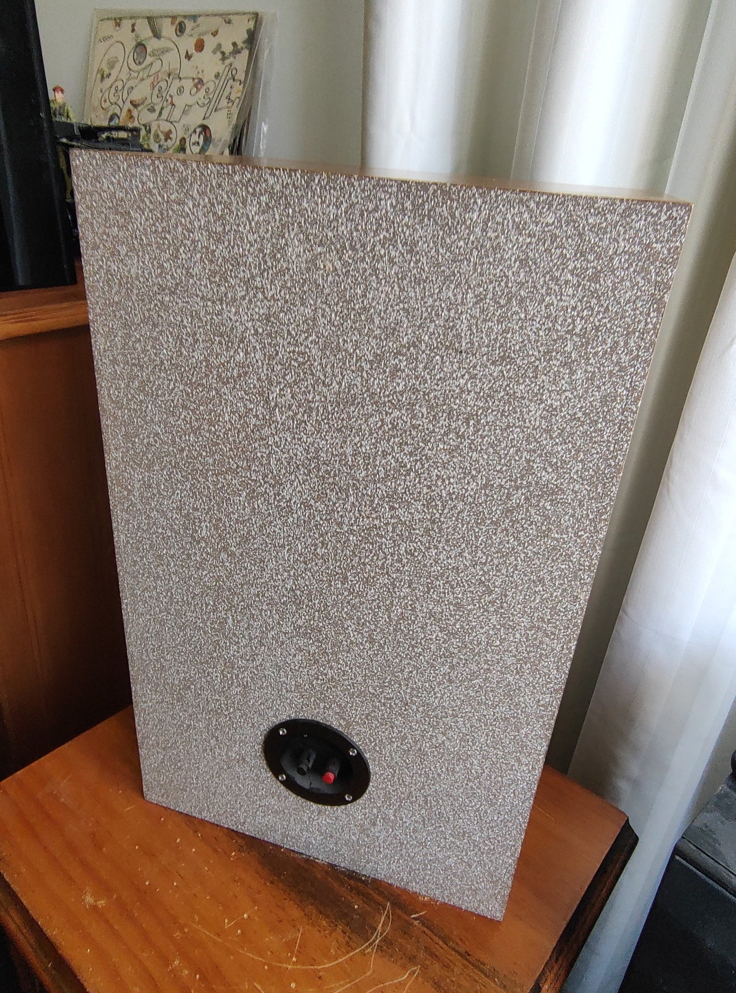

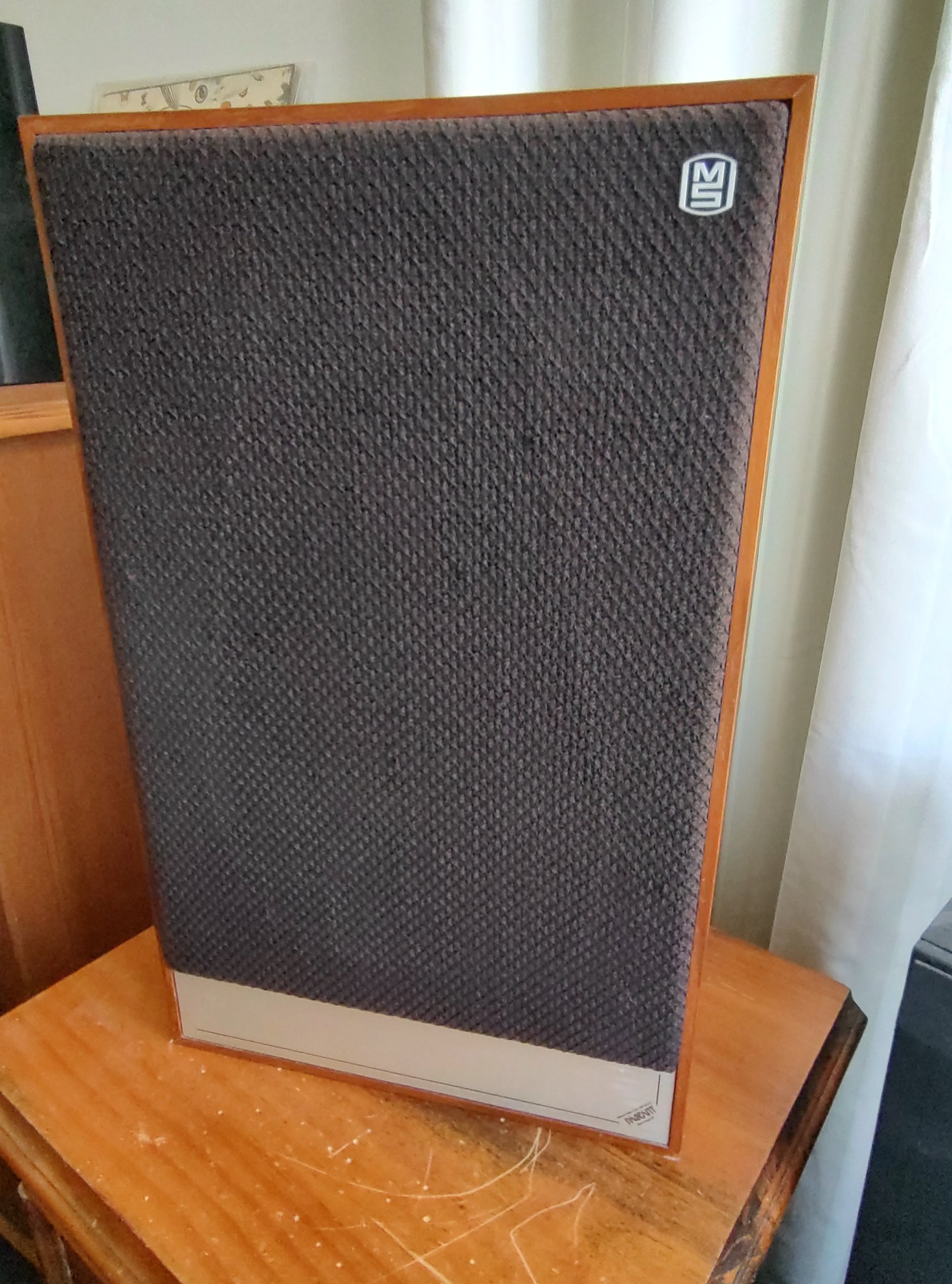

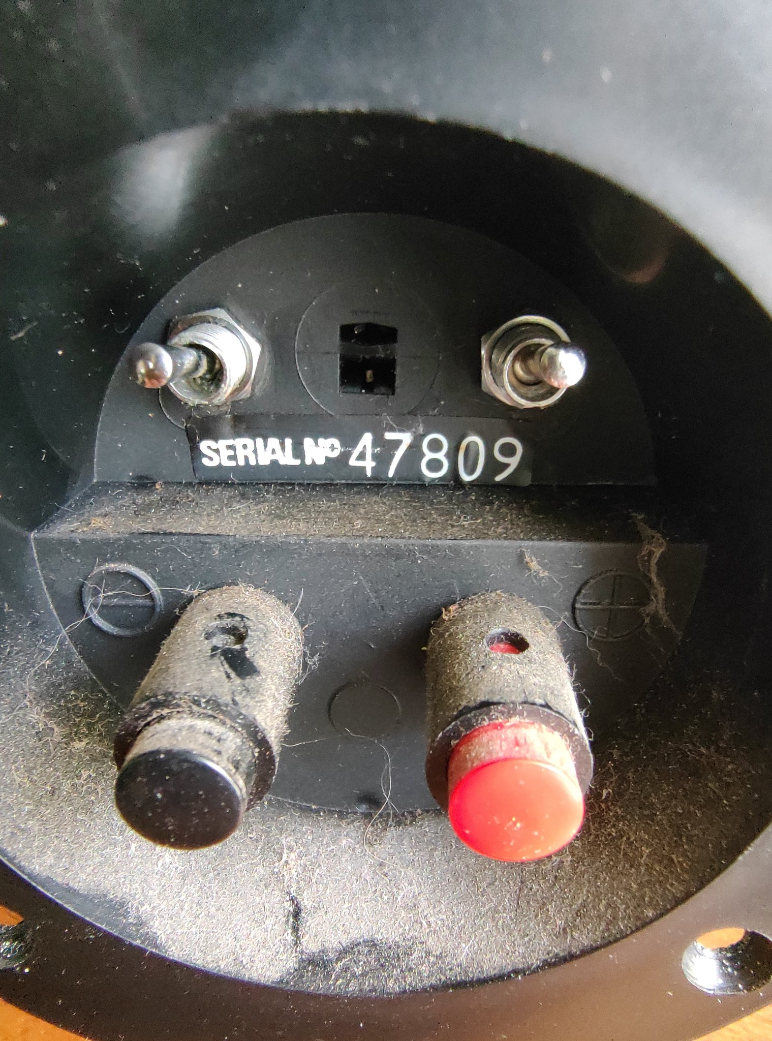

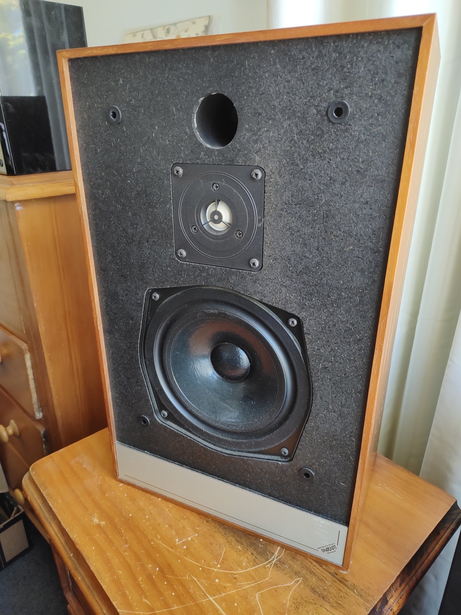

Hi
Just some shots of the speakers themselves.
At least one of them.
Interestingly the serial number on each of them is the same.
My sisters JBL's from the 70's have consecutive numbers.
It seems some manufacturers allocated individual serial numbers for each Loudspeaker, where as others allocated the same number for each of a pair.

Thanks Allen.
The toggles on these switches are smaller than the usual toggle I'm familiar with.
Each switch has three wire points on the rear to which wiring can be connected.
Do you think non MS parts are available?
Or should I try to by pass the two switches altogether and, if the resistors are currently engaged on the -ve pole of the switch positions, bypass the resistors altogether?

Sorry to hear about your mother, Cliff, but welcome back to the forum.
I would certainly replace those ELCAP capacitors with modern bipolar electrolytics. They are probably well out of spec by now.
Replace the 5 uF with 4.7 uF.
When the switches are in the down or 'cut' position, resistors are introduced to attenuate the mid and treble drivers.
Currently they are in the up or "level" position and it sounds like Allen B is correct.
It would be best if you were to bypass the switches and their associated resistors and run the mid and tweeter direct from the crossover board.
This vintage speaker requires as much 'brightness' as you can muster!

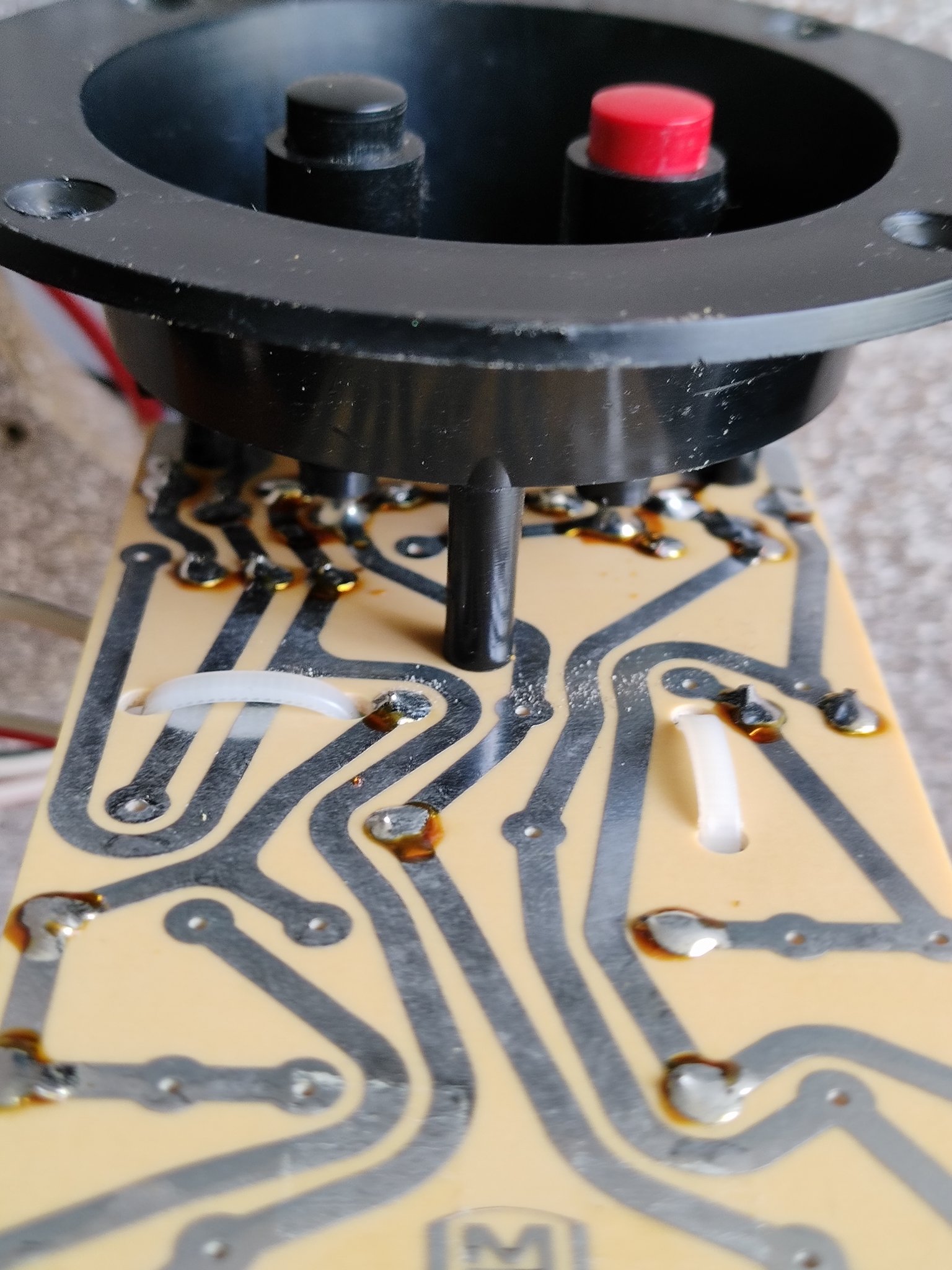

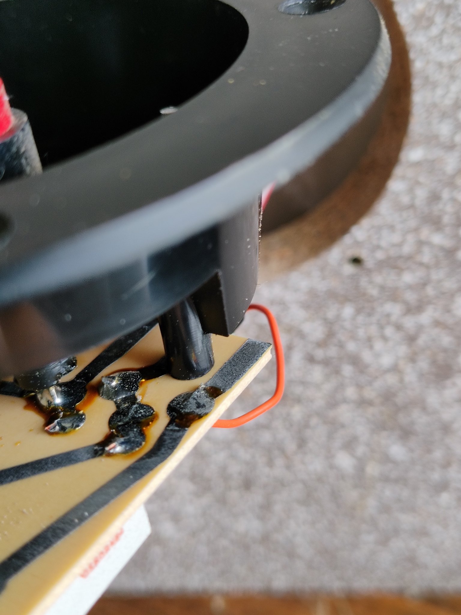

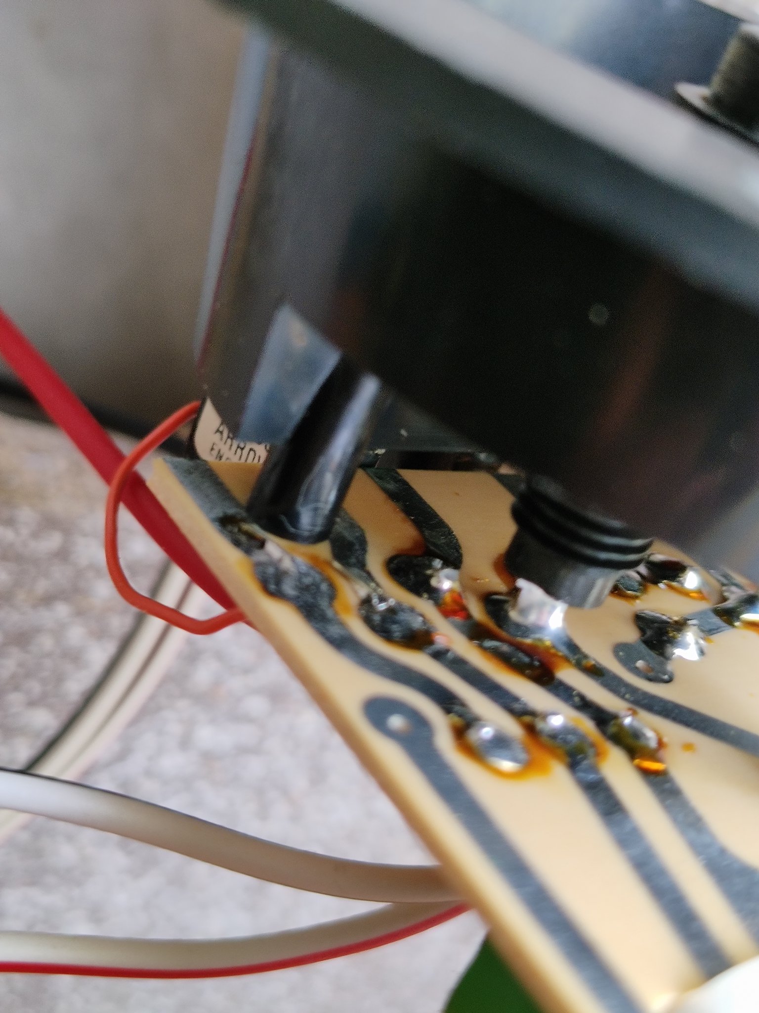

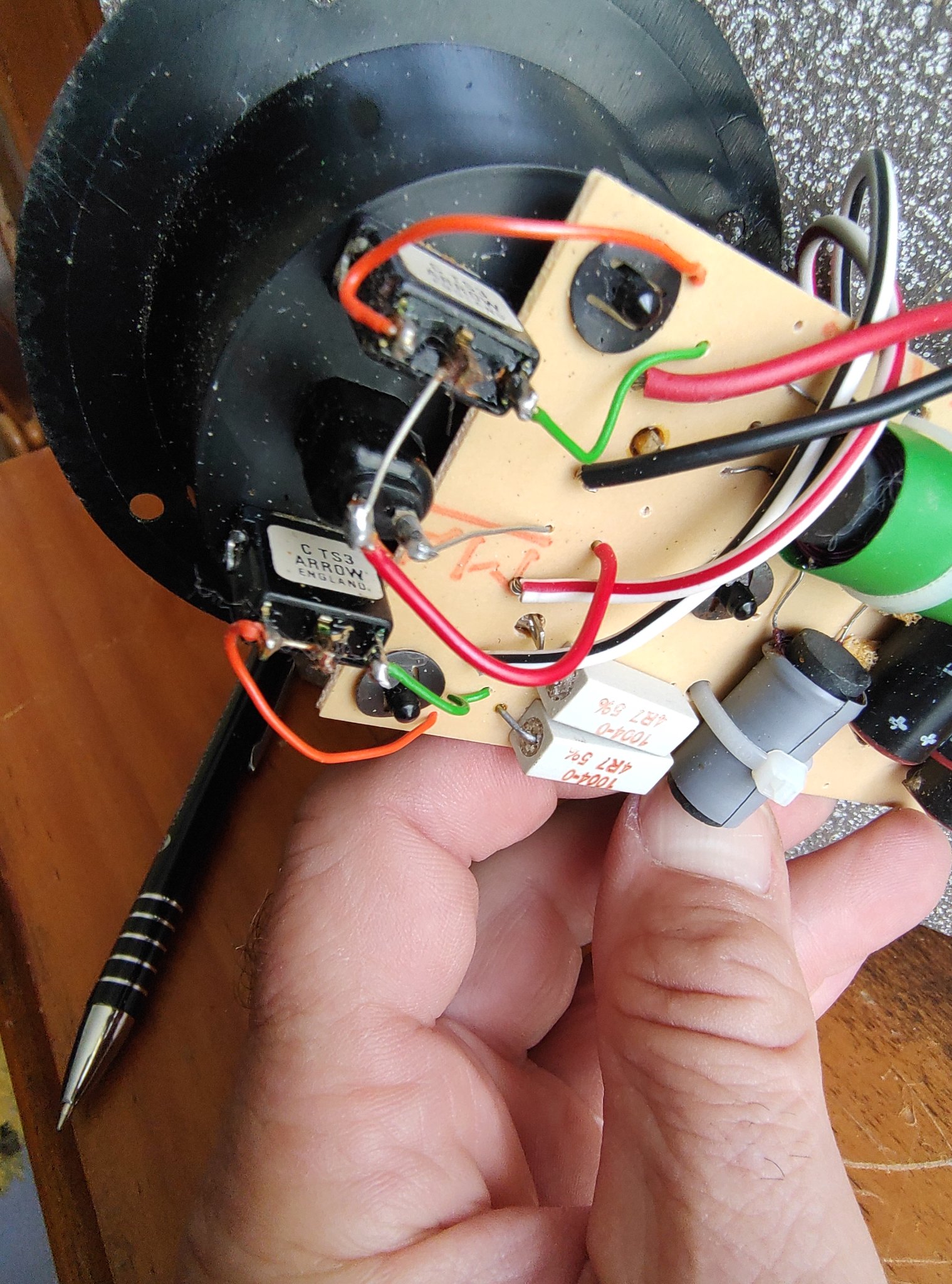

Hi.
Here are shots of the circuit board, switches & wiring.
I'll next try to follow the wiring.
The jaycar electrolytics are +-10%, perhaps a little too cheap & cheerful for the speakers.
Trying to locate an Oz source for the Mundorp E Caps which stocks the range.

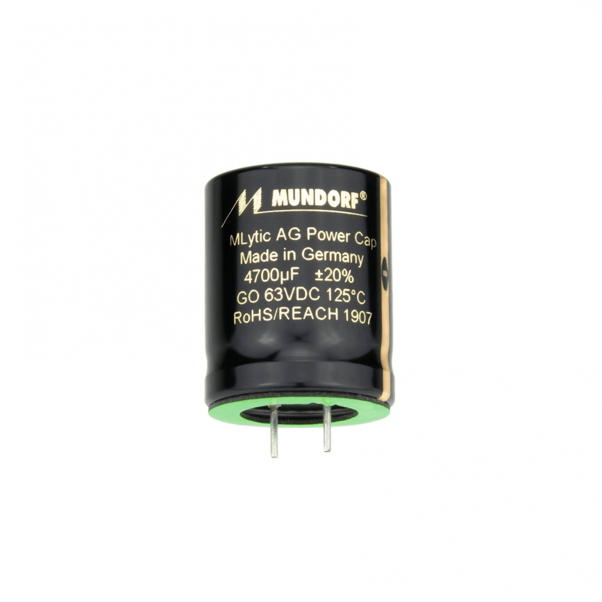

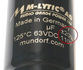

The tolerance is not necessarily a factor to judge by with electrolytics.The jaycar electrolytics are +-10%, perhaps a little too cheap & cheerful for the speakers.
However, M-LYTIC audio grade power caps are not like the ones used in loudspeaker crossovers.
They are power capacitors used in amplifiers where the tolerance can be larger. They come in values from 1,000 uF to 47,000 uF.
https://www.mundorf.com/audio/en/shop/Capacitors/Power_Caps/MLytic_AG/
You don't think the point remains?
I think that +/-10% is adequate for a simple crossover network like the one in question.
The original black and red ELCAP capacitors are unlikely to have been of closer tolerance than that.

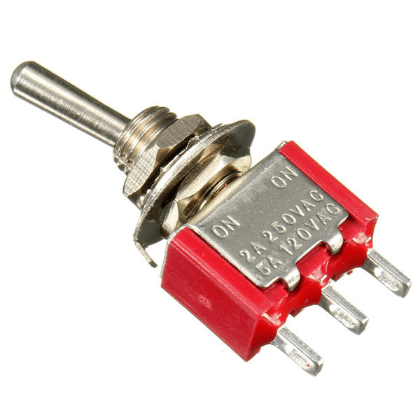

Cliff, the simplest way forward is to replace the switches as I've indicated. Personally, I've no desire to make myself dizzy by trying to unravel the wiring!
I don't see the logic in a statement like this. You can narrow down tolerance simply by measuring them and selecting one that has near the exact value. We could also get into the variability of electrolytics over time, but again tolerance is not necessarily the spec to tell you that.I think that +/-10% is adequate for a simple crossover network
I'm well aware of that and have frequently done so.
P.S. Make that +/-5%.
Thanks Galu.It looks like it would be much easier to simply replace the switches.
Look for a 3 pin on-on SPDT toggle switch that would fit the existing mounting holes.
I'll work on tracking down some replacement switches.
