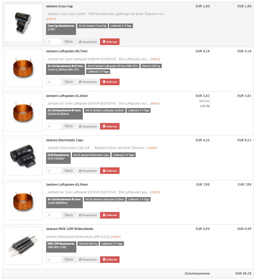

Thanks!@thimios
Here you can find the preassembled and tested crossover for the Asathor
Asathor WeichenSatz (Paar)-Asathor[/url
or save 40€ or get better/differnt parts by building it yourself
This will show you the values you need to get for building your own
[url]https://image.jimcdn.com/app/cms/image/transf/none/path/s72d3b302c13e9e1f/image/i1631479eec6c4fe6/version/1577747191/image.jpg
obviously per speaker so x2.
You can get everything you need for this build from THLP, all the drivers, crossover components and anything else you need. They are inexpensive but do not discount shipping and you need to request a quote, I believe they quoted me 35€ shipping, still good overall price. But it is one stop shopping.
There is also an overview of the shopping cart with Jantzen components at the Quint store. Of course, all comparable components from other manufacturers also work. Pay attention not only to the inductive value of the coils, but also to the resistance.
You may also find a local dealer who sells the components. Otherwise, I can also recommend TLHP, although I tend to support Quint because they were kind enough to provide the chassis for the Asathor.
