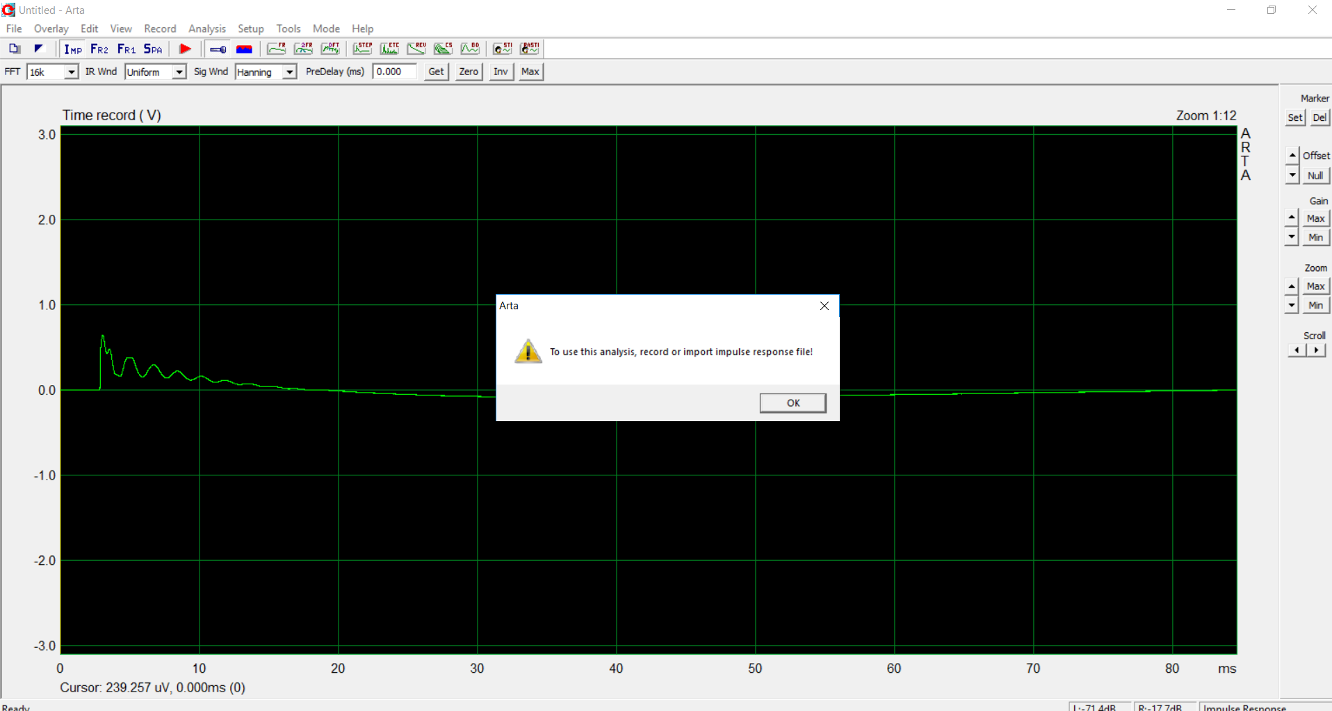

Hello,
I did impulse response measurement using External Excitation. Any idea why Burst decay and some other tools won't work? Says "To use this analysis, record or import impulse response file!"
Thanks!

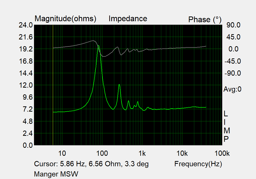

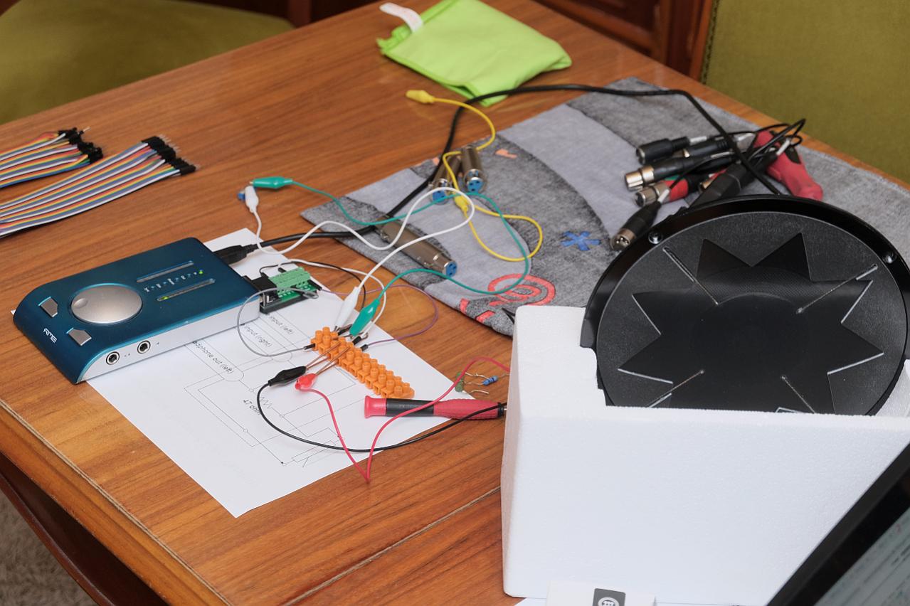

In attachment I send you simple impedance jig that enables impedance measurement without power amplifier. Just use headphone output (RME outputs 3/4) as generator with reference resistor 47 ohms.
Use RME inputs 3 and 4 as unbalanced one.
Best,
Ivo
Works very well. Ref resistor 47R, 38R value in Limp to get proper reading. Is calibration necessary?
