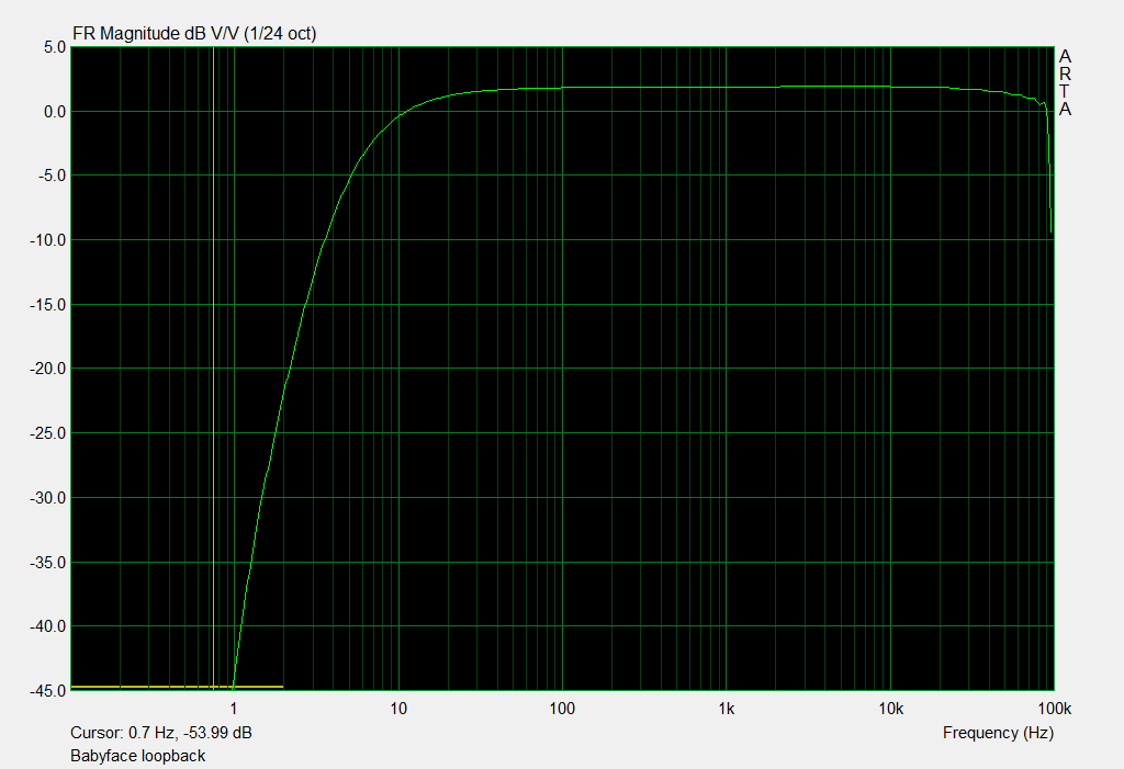

Found it was driver related now I see TotalMix. Loopback ok?

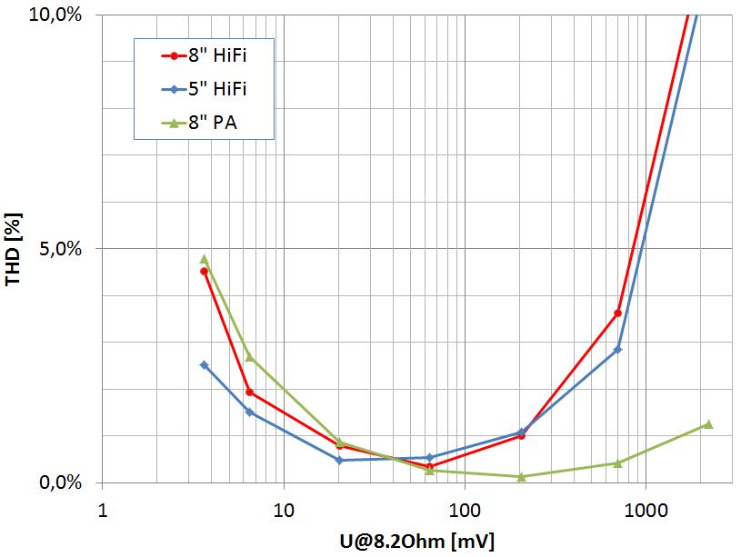

Hi Rich08,
yes it's the terminal voltage (original manual, fig 3.1 or 3.2, left in).
The following pic shows max THD (as defined in original Manual on page 25 "a) Procedure in Stepped sine mode") as function of terminal voltage for 3 different drivers.
Regards
Heinrich
Are you sure this is THD? The high values at low drive voltages make me think this might be THD+N. Or is this maybe some mechanical stiction in the drivers that cause higher distortion ratios at low drive voltage?
The measurement shows THD, but when signal is low the noise contributes to THD value. Some other effects probably arises like hysteresis of suspension and...
Heinrich has made nice measurements to show that we can find the excitation level that will gives as "small signal regime", which is optimal for measurement of impedance and TSP estimation.
Small signal regime is important because in estimation of TSP we are using assumption of constant BL or constant compliance.
How to find optimal value of voltage is a problem as voltage is not the same on resonance and in pass-band (except when referent resistor is much smaller than Re)
We must use two step process with stepped sine excitation. In first measurement we find frequency with maximum THD and than try with larger or smaller voltage to get minimum THD.
What frequency region is important? Generally it is on frequencies at or bellow resonance, as in that range membrane has large displacement and compliance additionally exhibits creep effect (change of compliance with frequency).
Ivo
