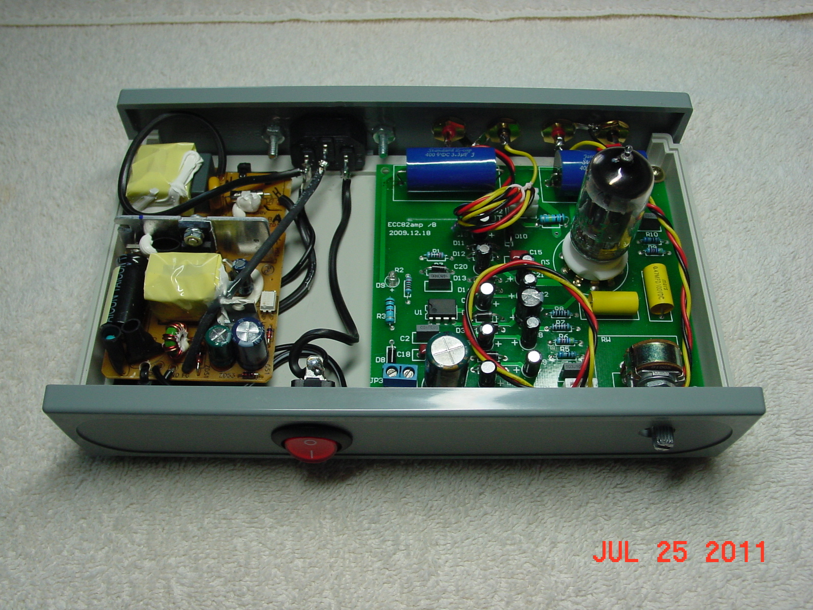

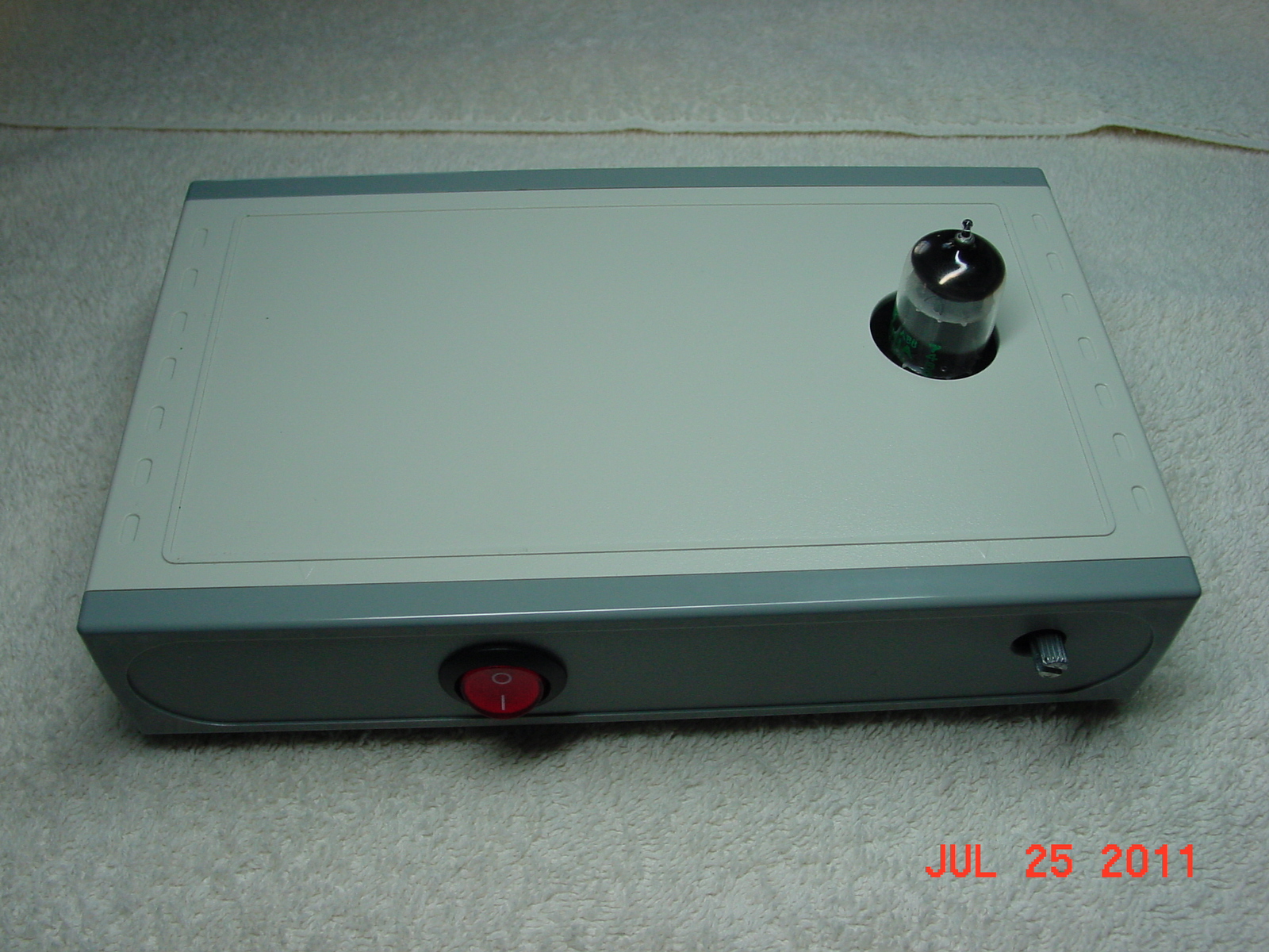

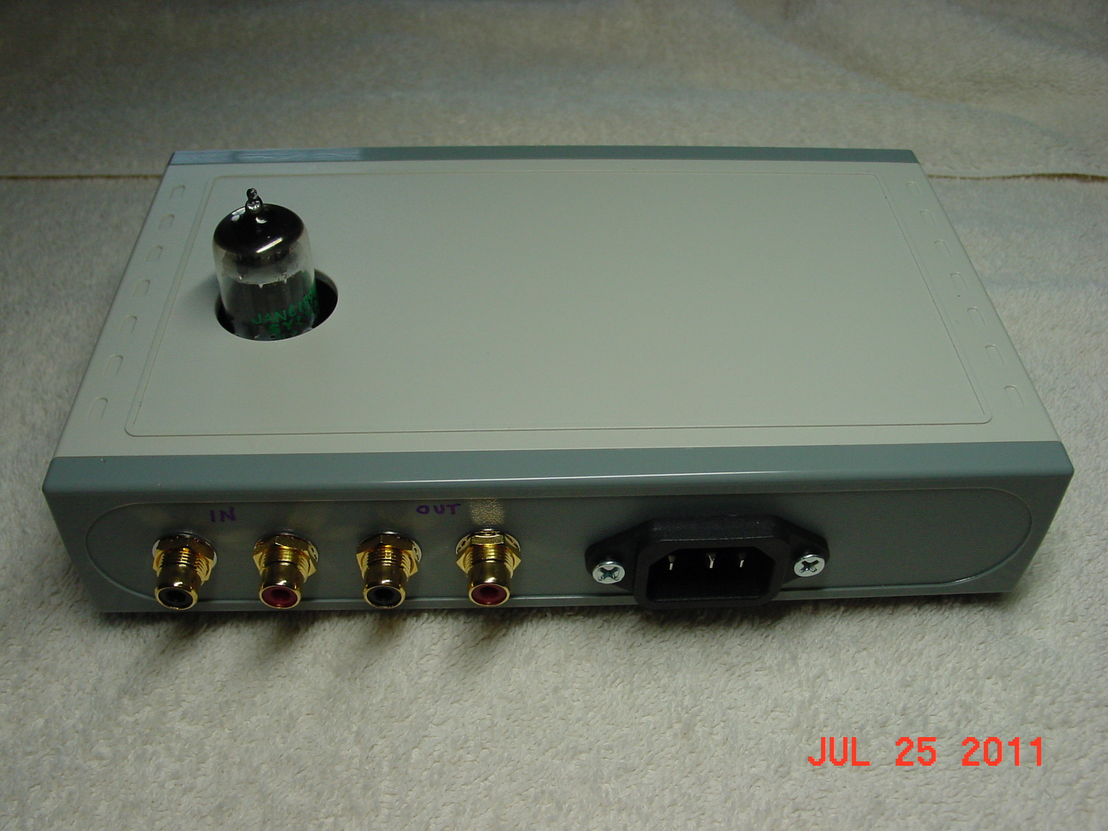

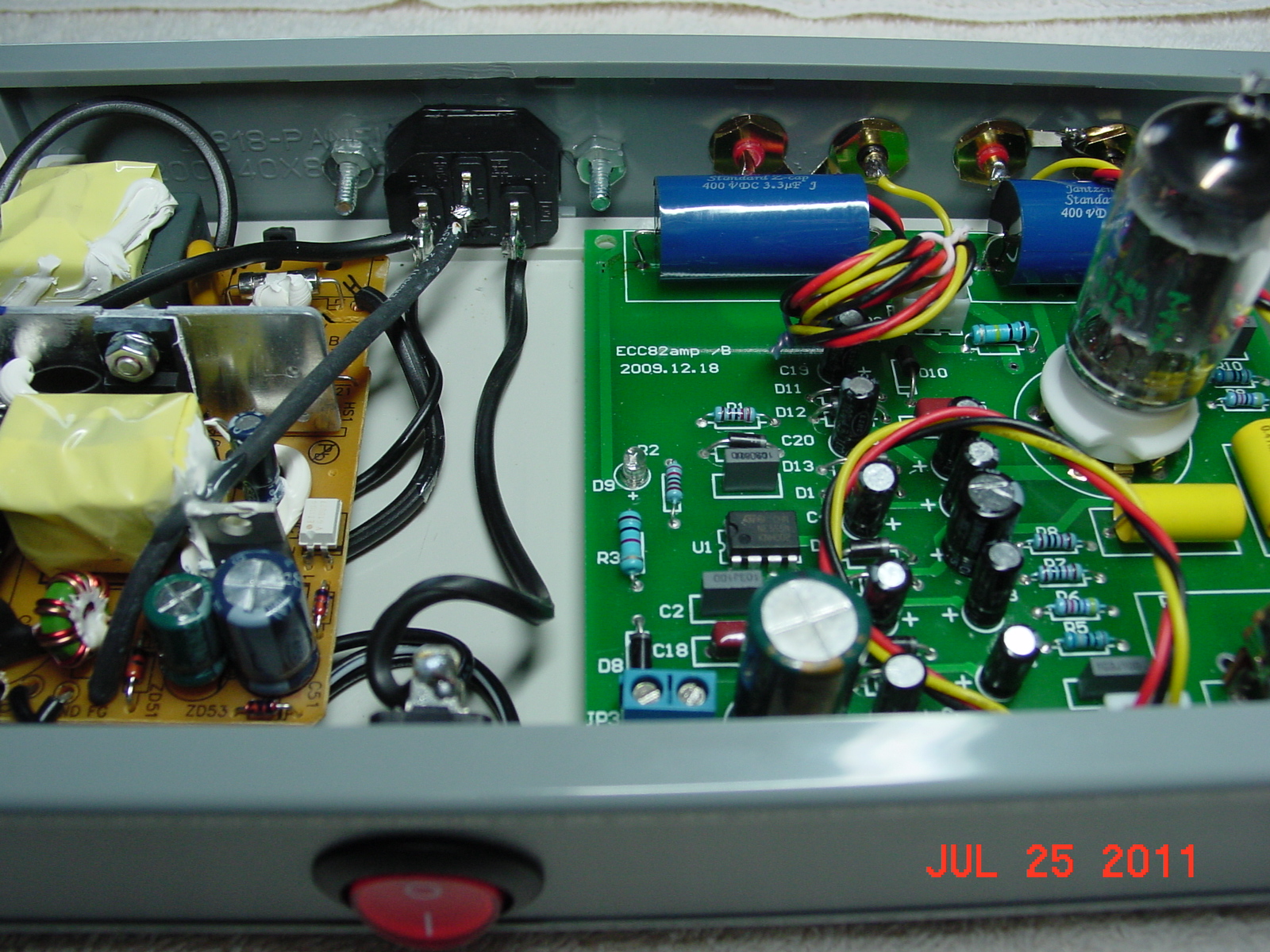

Yes, as far as I can tell, it works with any amp and it does a very good job with the right tube. Actually, it does wonders. Here it is playing with a HIFIMEDIY T4.
This is my second Helder tube buffer implementation that I use in a tape monitor fashion, it really adds a lot of richness, detail, and body to the sound. I am using a donor 12 VDC SMPS power supply from a router or modem. It is great for adding to an iPod or some other weak signal as an extra layer of amplification.
The case is from www. mouser.com, you drill all your holes, it is a blank box. Worth every dollar.
I hope version 3 of his buffer is as good or better. This has got to be one of his better products.

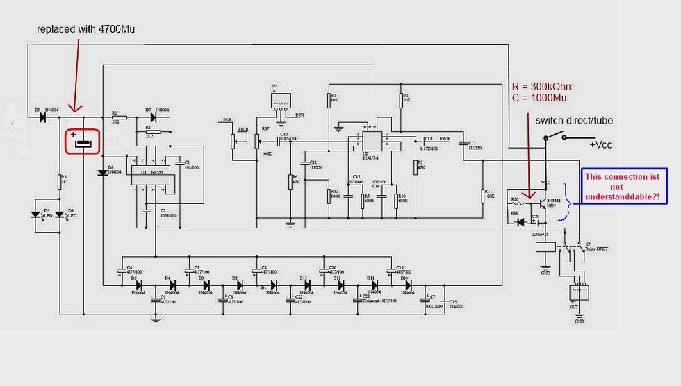

Complete schematics for tube buffer

Hi M-r Whaleman!
Do you insert you can the complete schematics for this tube buffer.
Thank you and cheers!
Tube preamp with 12AU7
Hi
The schematics not understand some things. Electrolytic capacitor of 4700uF/25V should this be connected as in the schematic?
Schematic for power supply relay is not clear, please schematics again a power supply for relay.
Otherwise, this schematics is the tube pre-amplifier with 12AU7, not a buffer, as a gain of about 14x.
The gain of the tube buffer is <1!
thank you and cheers!
