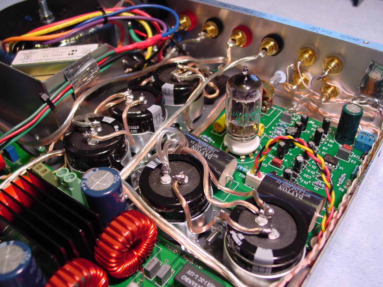

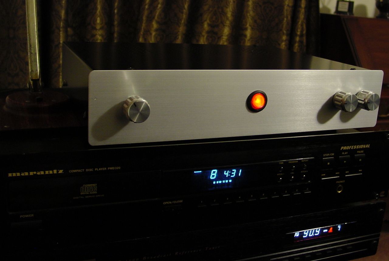

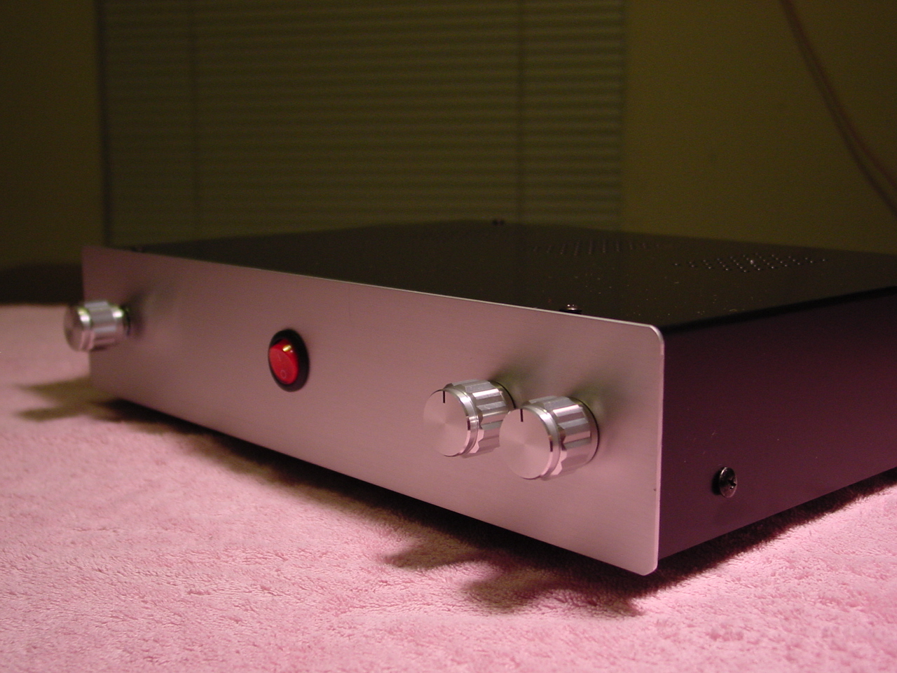

Finally finished the amp, it consists of 2 Arjen TK2050 monoblocks and the tube buffer.
I made a mistake and bypassed the output capacitors (big reds) on the buffer against Arjen's advice. I should have listened. The sound was brittle, hardly any bass, there was some hiss and the volume pots were scratchy every time you touched them. I was ready to tear the tube buffer out when I decided to put some capacitors that I had from a x-over where the red ones used to be on the buffer. It was the last effort before tearing things up. All the problems above cleared up. No more scratchiness on the volume pots, no hiss, better bass, and the sound is no longer brittle. The result is a very detailed and great sounding amp. Thanks to all the relays on the 2050 monoblocks, there are no pops when on/off. I'll post some pics when I am back on my computer. The capacitors I used are Dayton Precision Audio 4.7 uF / 250 Volts.

Bought a set of Helder's TK2050 and the tube buffer. I replaced the stock tube with a regular Electro-Harmonix version.
The TK2050s by themselves sound just like a typical T-amps. However, couple them with his buffer and the Electro-Harmonix tube, they sound amazing. Much more pleasant, and the strange thing is that the imaging becomes razor sharp.
To get rid of the buffer pop, add more filter caps to the buffer supply, so the TK2050 relays cut off the speakers before the buffer supply runs out of juice.
