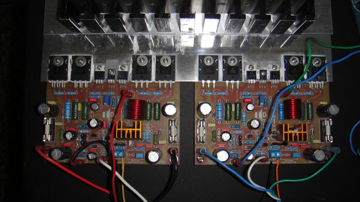

Hello guys!
I finally have my Supercharged in stereo! weeeee, I having a problem with the other channel "not the board" the board was bias perfectly, it was just a simple 3.5mm cable that was faulty, I replace it and nice dude........ lol good sound guys, I don't have the enclosure yet but I will soon, ok guys take care I will continue on mister Carlos new project Dx Super A layout bye bye.
Dx Blame MKII Supercharged Stereo in Puerto Rico - YouTube
Regards
Vargas

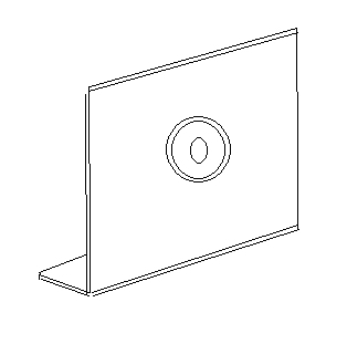

Install your speaker in a wooden panel to avoid losses..at least a wooden panel, even a cardboard panel (thick one) will reduce losses.

Juan told me that he has some boards left
He made his own Supercharged pcboard design, almost the same as Mitchel has made and he ordered too many..he has boards left.
So, if you want boards from this multimodel amplifier contact him directly:
vargasmongo@gmail.com
Boards he has are to these amplifiers you see here:
DX Blame Amplifiers - Carlos Mergulhão
