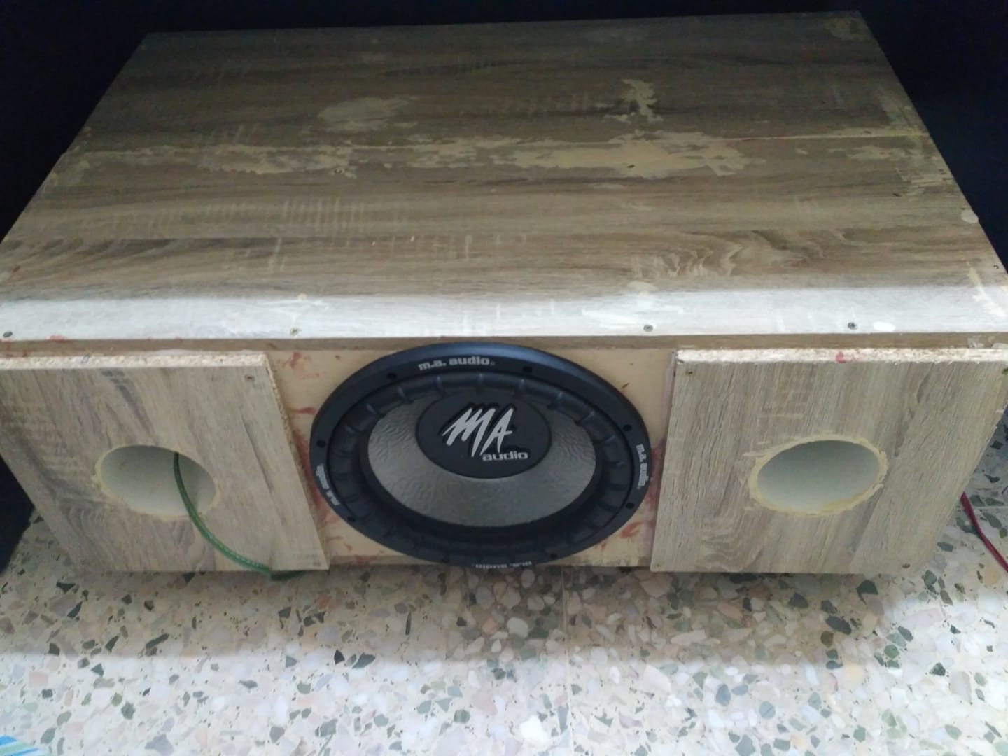

It actually depends on how you design your enclosure ... for me i decided to play safe i did a diy subwoofer enclosure ported (120L) giant size ... housing a MA Audio MA120XE which has double magnets and double coils. In this case i start to worried that one port might not being able to handle the high port velocity which will result in port noise because reaching the higher port velocity sooner. I run a simulation from WINISD using 2 ports will half the port velocity which is a safer way to go.

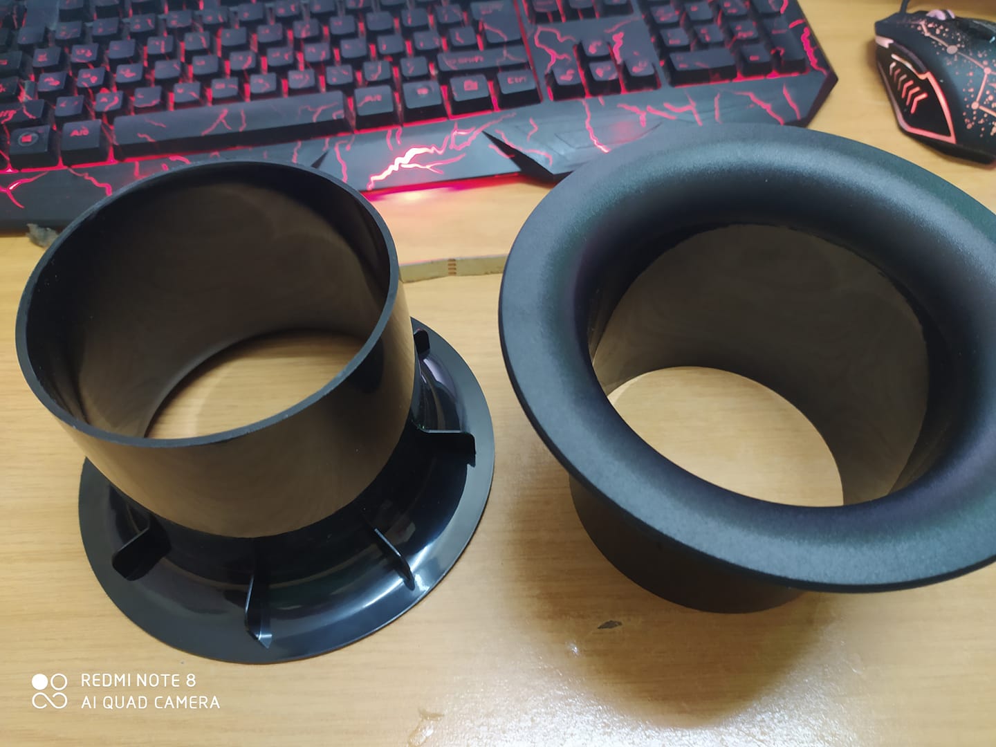

For the time being the ports were flanged and there were no port noise noticed so far ... but i end up ordered flared aeroports as upgrade :D:D this gives me plenty of leeway to play around ... but the enclosure was way too heavy ... around 50kg or more :D:D
below here is the current subwoofer and the newly bought aeroports for upgrade

Sorry Mr Collo a little bit off topic here ... i've visited your website too but this time i came across this aeroport i just bought but they have fins at the back ... how actually i am going to install these correctly? thanks :)

@dannyjmf
Normally you make the opening a bit smaller than the outside diameter of the flare and glue them in from the front.
